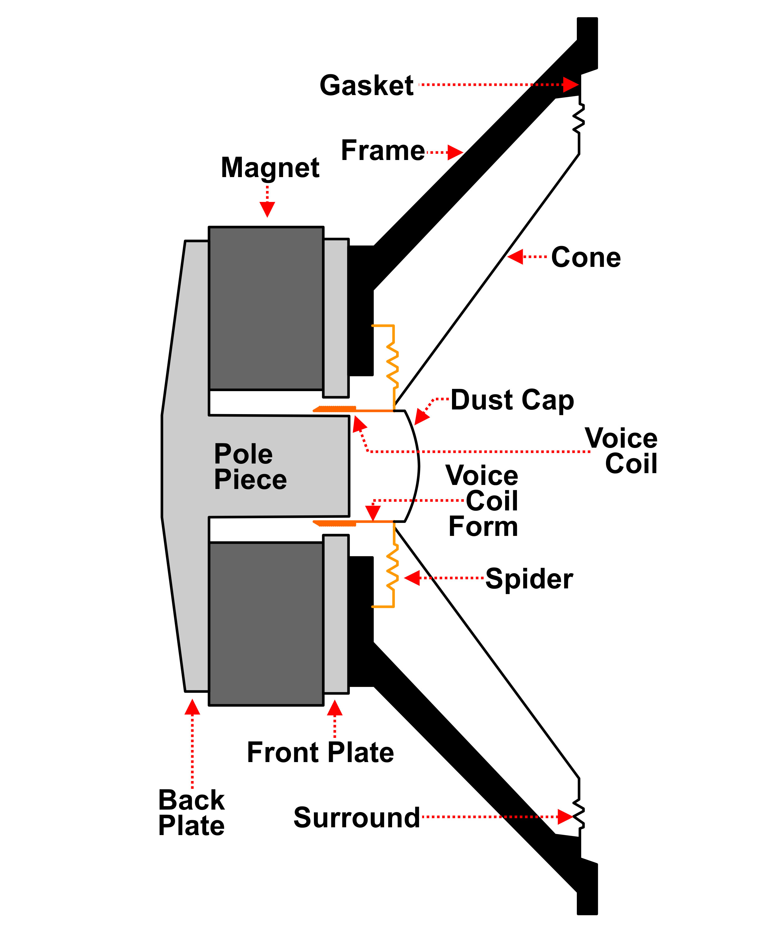

    Do I need to glue these magnets to the speaker frame
    You should be applying the adhesive between the front and rear plates and the magnet.
  • skipshot12
    skipshot12 Posts: 2,142
    Jesse, what are you calling the front and rear plates?
    Want to make sure I didn’t miss something on my rebuild.
