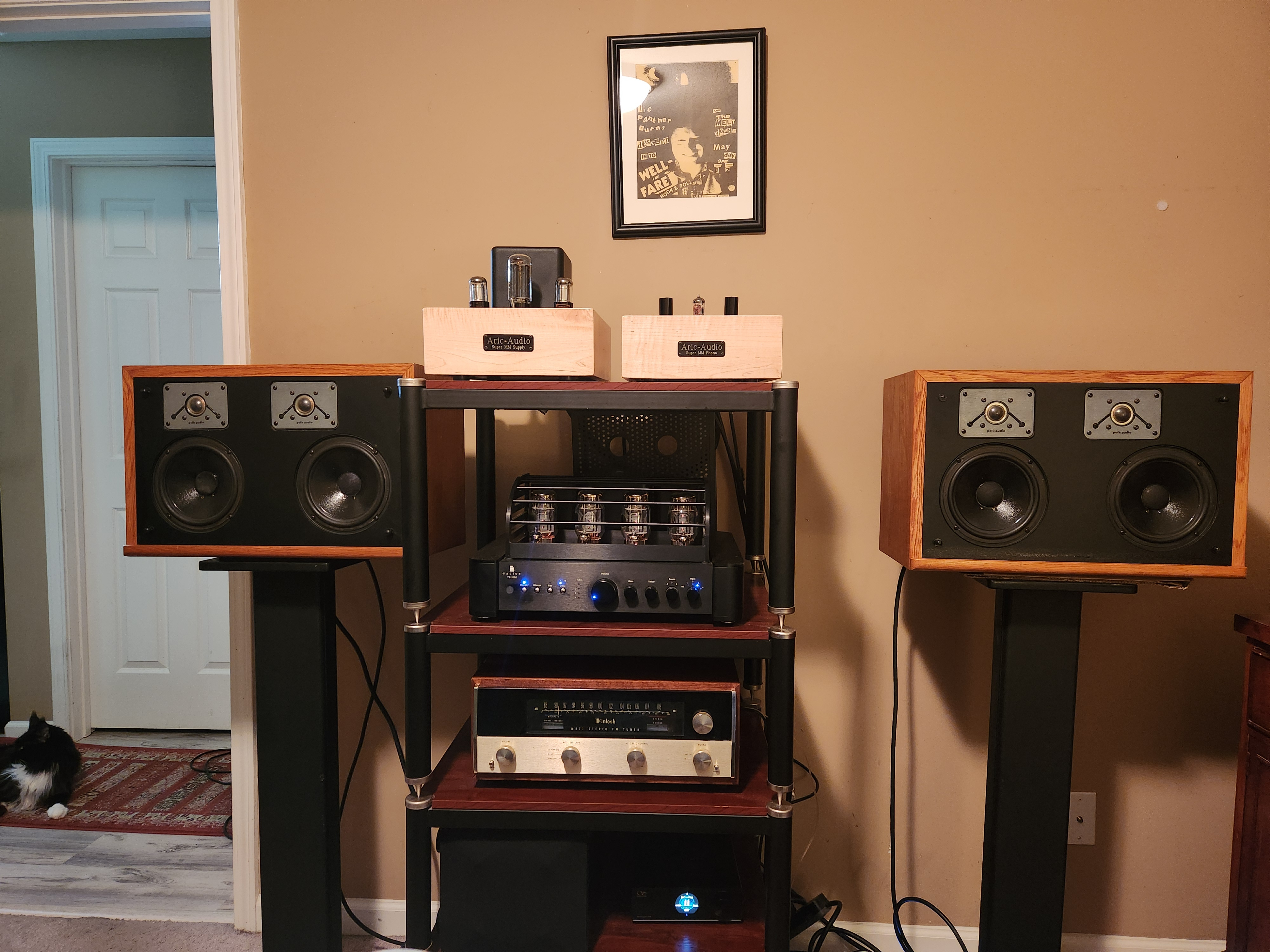

    It's 2025, and I just bought a pair of these off of Craigslist. With my integrated tube amp and subwoofer, these speakers sound very strong, yet very warm. Simply fantastic 👏 kbnzysrv9rts.jpg
    Tony M Posts: 12,038
    Great. B)
