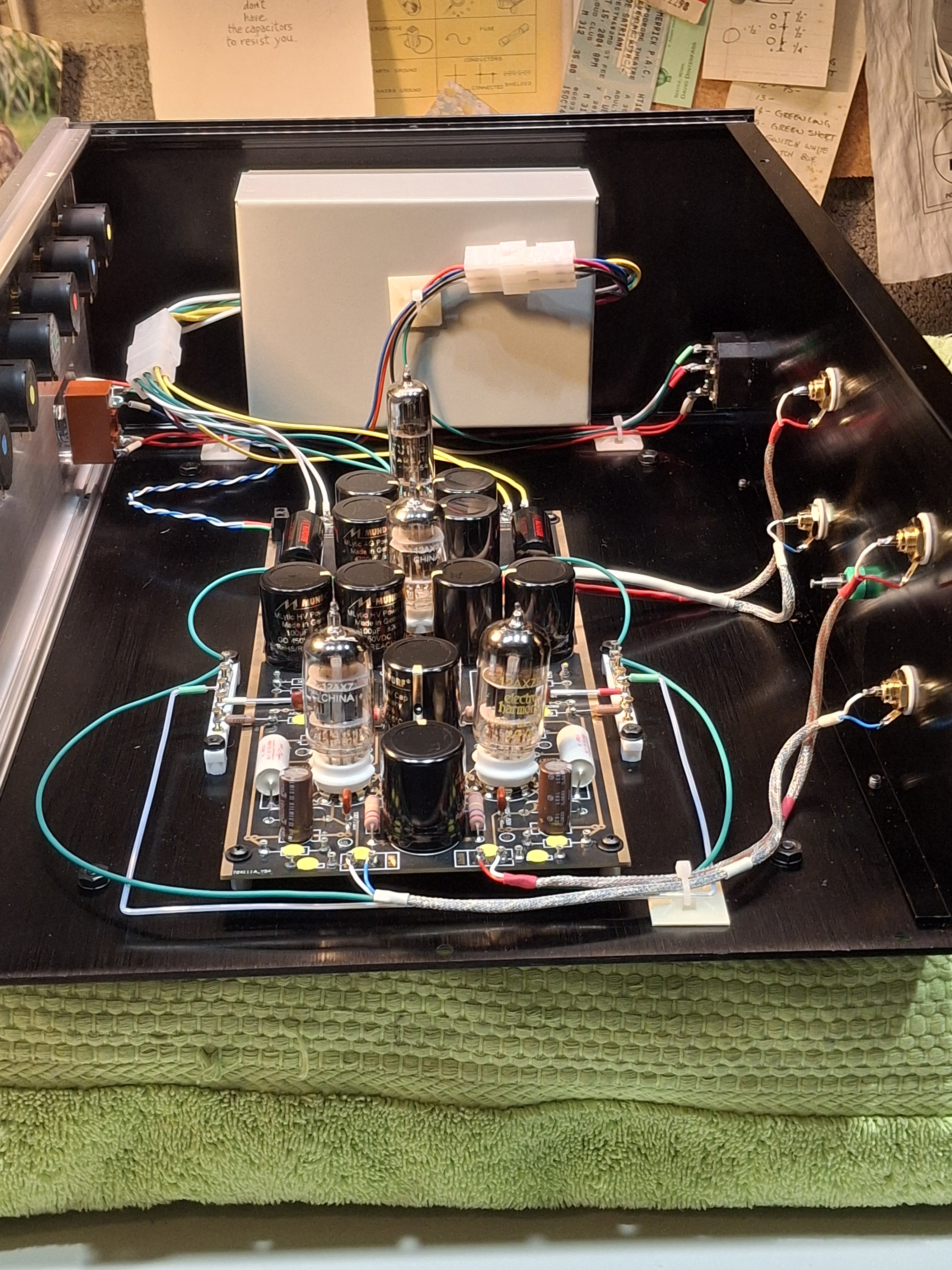

    A bit of progress. I mounted the AC transformer on the side panel using four 8-32 bolts with rubber insulated washers. Then I was able to install two Molex type connectors for connections to incoming AC and to the circuit board. Initially I thought I would use generic white coated wires for these, but after some thought I decided to go with the same color coded wires that came with the transformer. I found a source that had 25' quantities of all the colors I needed, now just have to wait.
    The next step is to finalize the circuit board's position and a small terminal strip then mark the position on the bottom plate. I'm thinking about what feet to use now, just the basic set that came with the enclosure or go with something exotic?

    This enclosure is really very versatile, all of the panels can be removed from the complete assembly. So I can take a side panel out and it gives me access to doing the wiring. With the AC transformer mounted to a side panel and the disconnect plugs I can easily remove it to get to the side of the circuit board. The front panel was actually too thick to be able to mount the potentiometers and the AC switch. I had to take it to a really good machine shop and he milled out the back to 1/2 the thickness. It also made mounting the front panel LED tricky, that and finding out LEDs come in oval shapes. It took four metric drill bits to get it right.

    Some updates. We finally got our power back on after loosing it last Saturday night (hot showers are amazing!). Back down at the workbench and have installed the power supply connectors, verified the operating voltages are correct and installed the blue LED. Actually the LED was one of the more challenging aspects of this build so far. First of all, most LEDs tend to be oval in shape, which makes it difficult to drill a precise hole to fit them in. After ordering four gradually increasing metric drill bits I finally got a hole that has a smaller opening in the front with a slightly larger hole in the back to give a good fit.

    The side of the enclosure with the transformer attached can be removed from the main chassis to allow access to solder connections.

    I've completed the wiring for the input and output connections and the shield grounding connections.

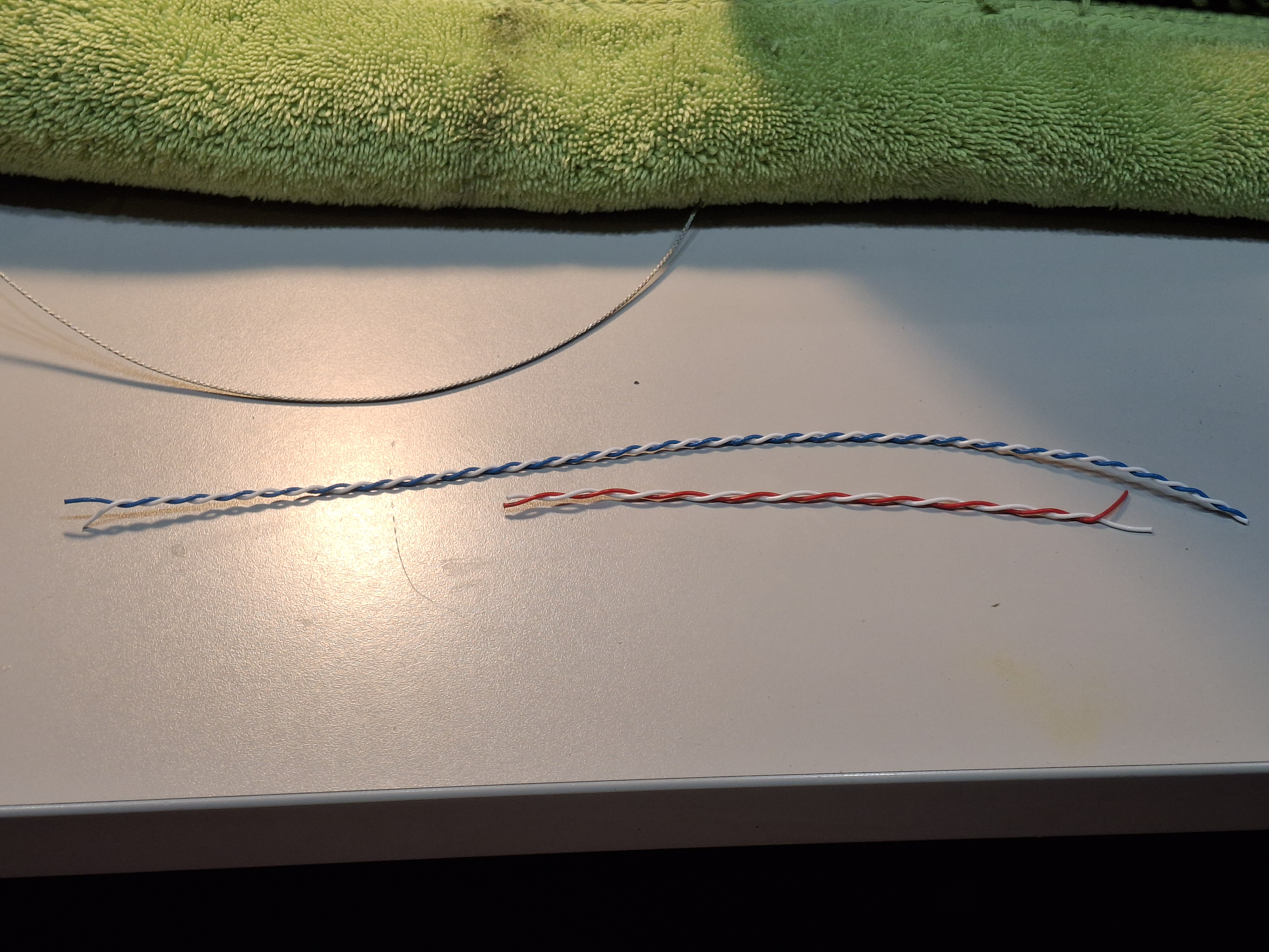

    Each wire is made individually. I start off by using a low speed drill to twist two wires together. Then the twisted pair is inserted in a braided shield that I've soldered a drain wire. Then the ends are sealed in shrink tubing and installed.

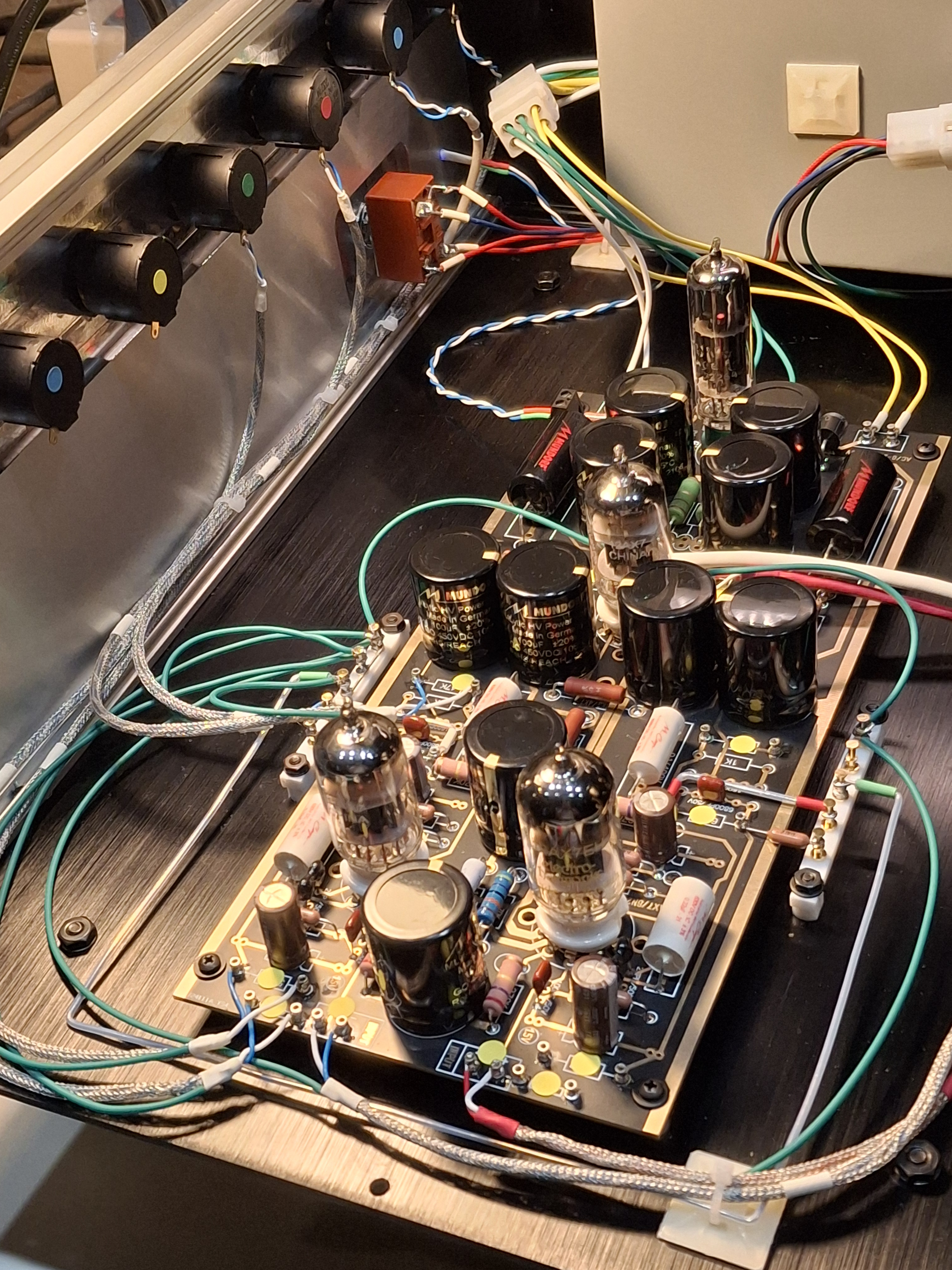

    I've finished wiring up the left channel from the four potentiometers to the corresponding terminals on the circuit board. The adjustments will allow for changes to the input loading, circuit gain, bass response and treble response. I connected a signal generator and meter and it seems to work, always a relief.
