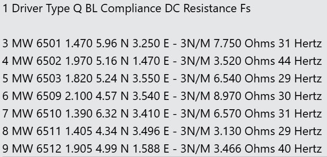

Does anyone have the TS Parameters for MW6510?
Does anyone have the TS Parameters for the MW 6510? I was able to find it for some other MW 65XX but not the 6510.
Thanks,
Scott

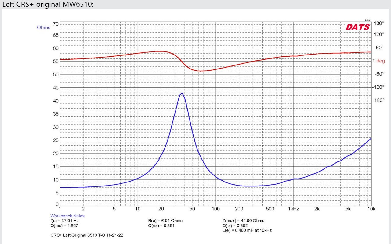

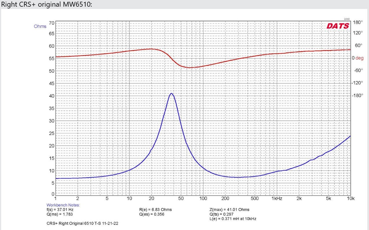

    Only some of them
    I just remembered too that DarqueKnight tested his:

    I am looking to build 2 LF14 like cabinets to supplement my CRS+'s. I was planning to use the cabinet volume 2B's and use 2 MW6510's and 1 SW120 per cabinet. I don't know if my theory is sound but it was where I can at least start. I have 4 MW6510's and 4 SW120's in my magic closet. I am hoping to use an active crossover and seperate power amps for the CRS+'s and MLS 12's.
    Thanks gardenstater for DarqueKnight's measurements. That will help with my planning.
