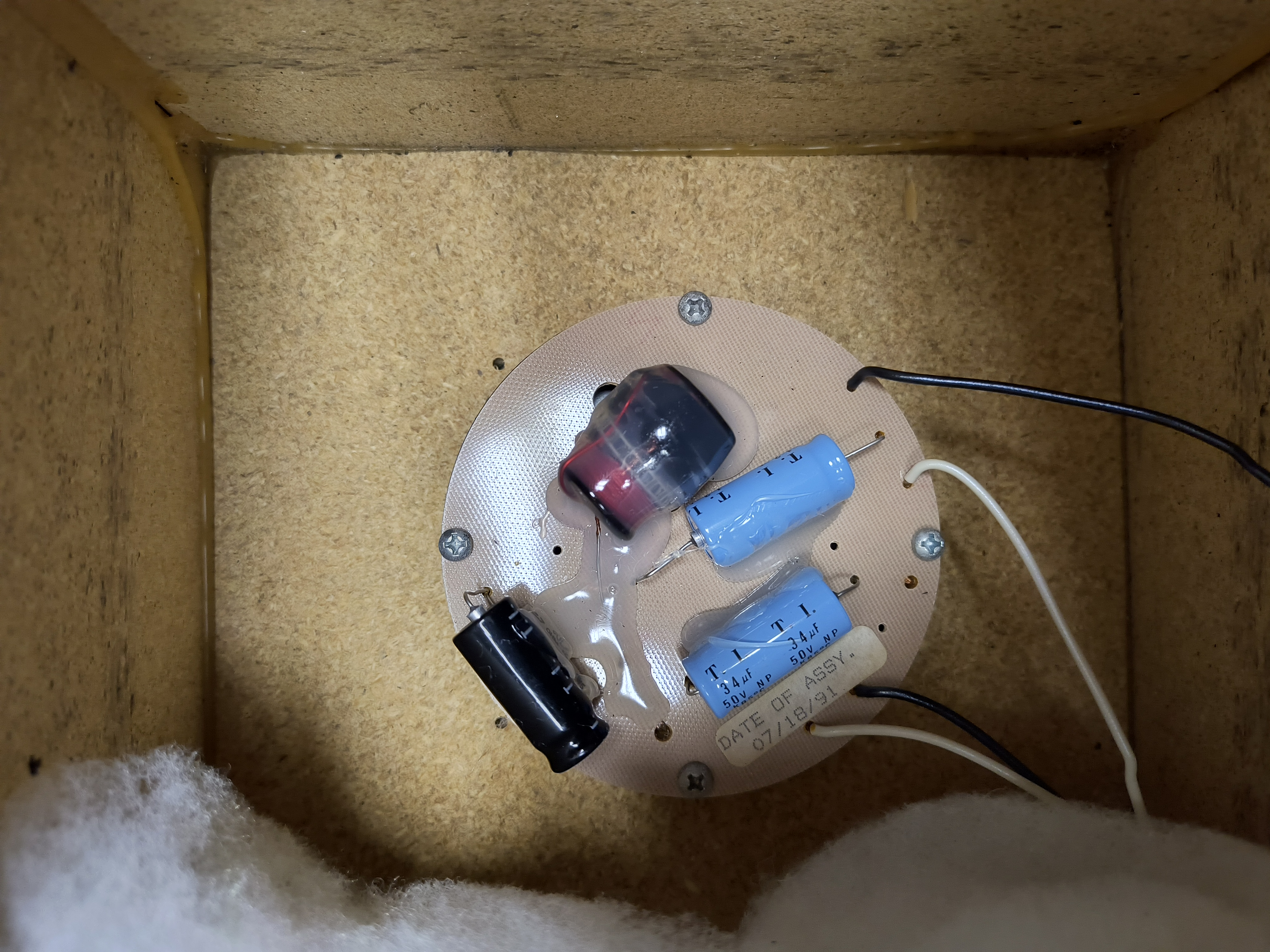

    If anyone is still looking, I took some photos of my M5 Series 2 crossover showing the Cap values. I also took the M7 Series 2 crossover schematic and modified it to show those values. The only difference I can see is the C2 cap values. I don’t know what the inductor coil values are, but I suppose they would be the same or very close to the M7 values.

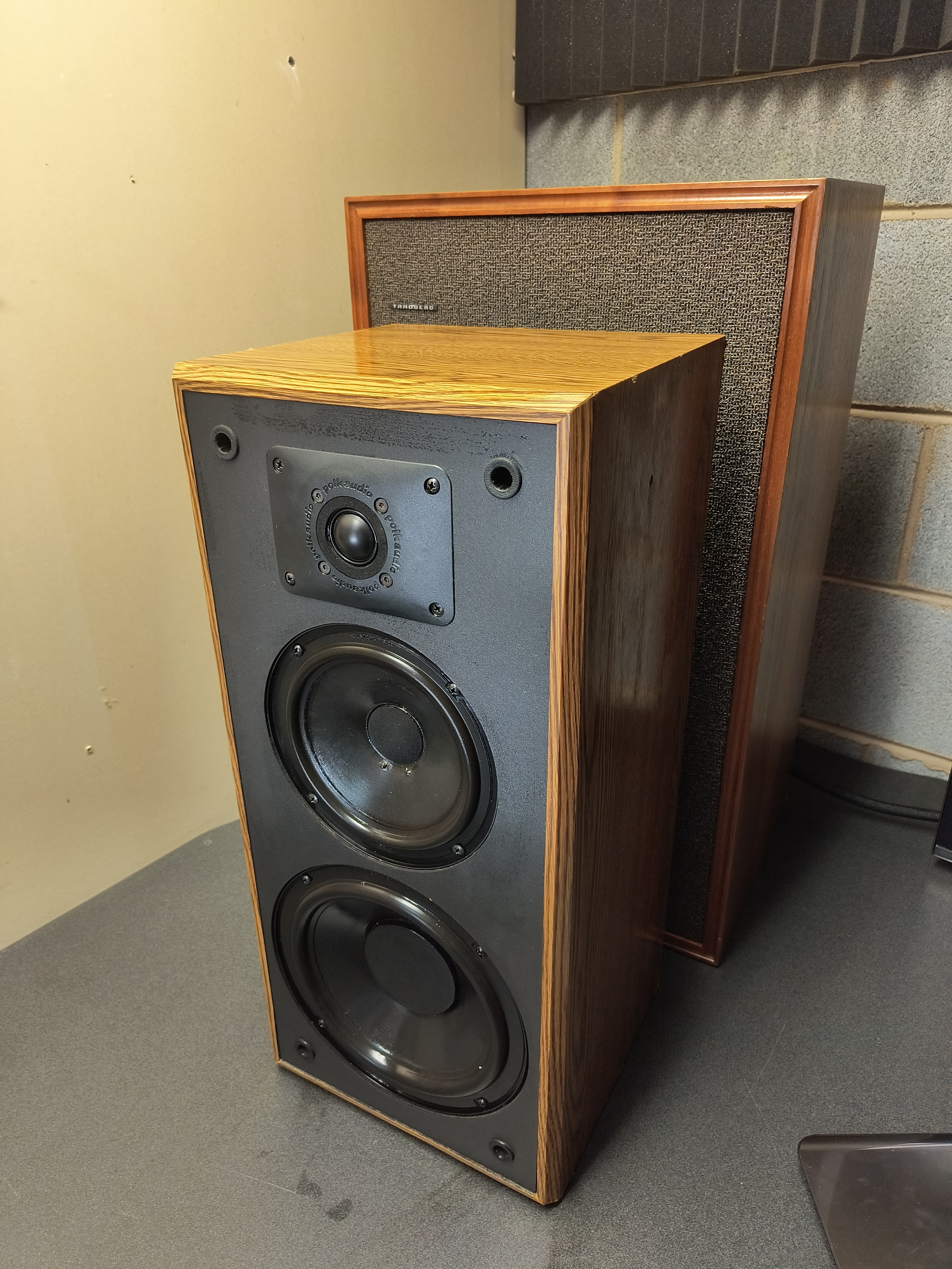

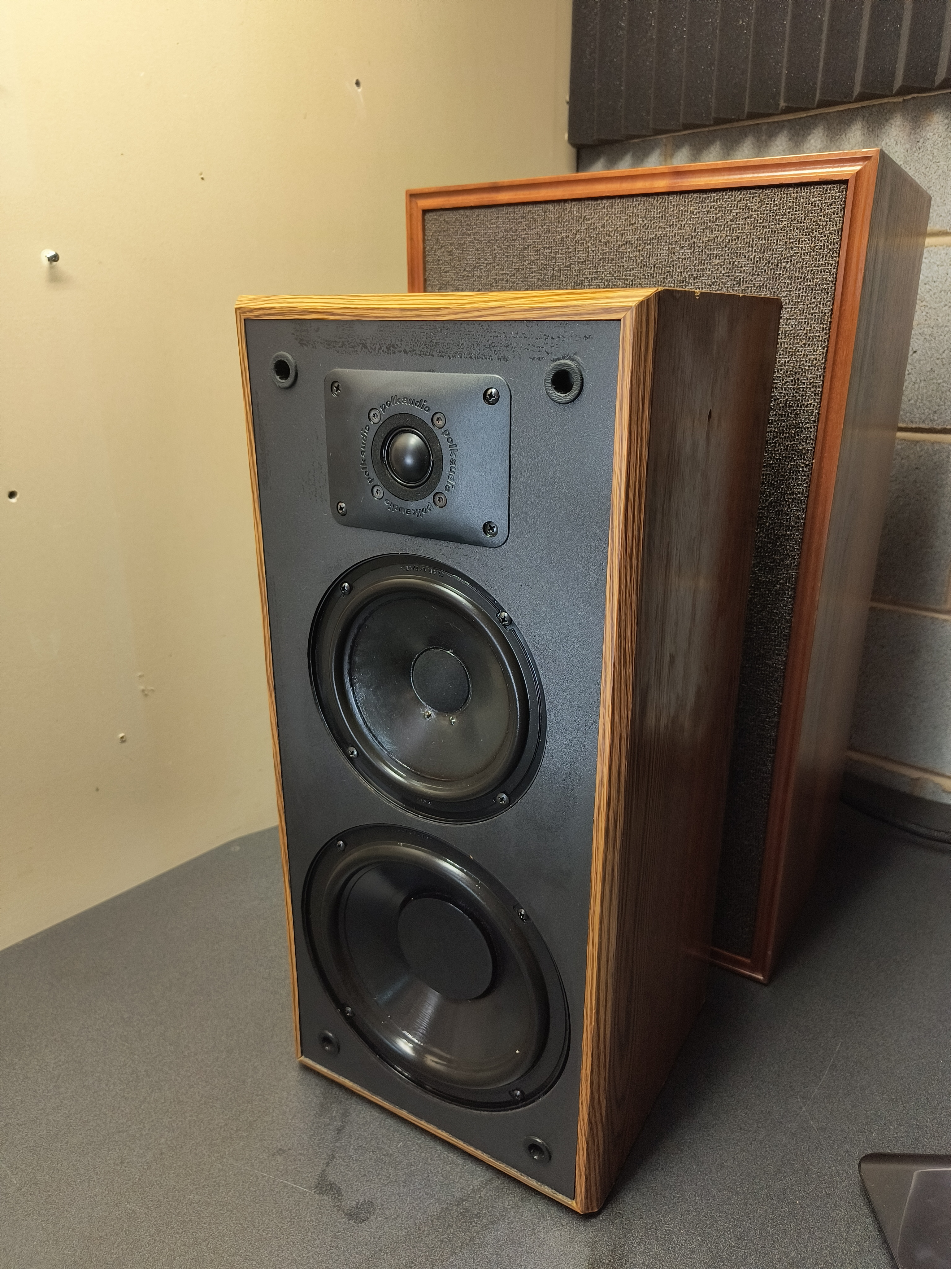

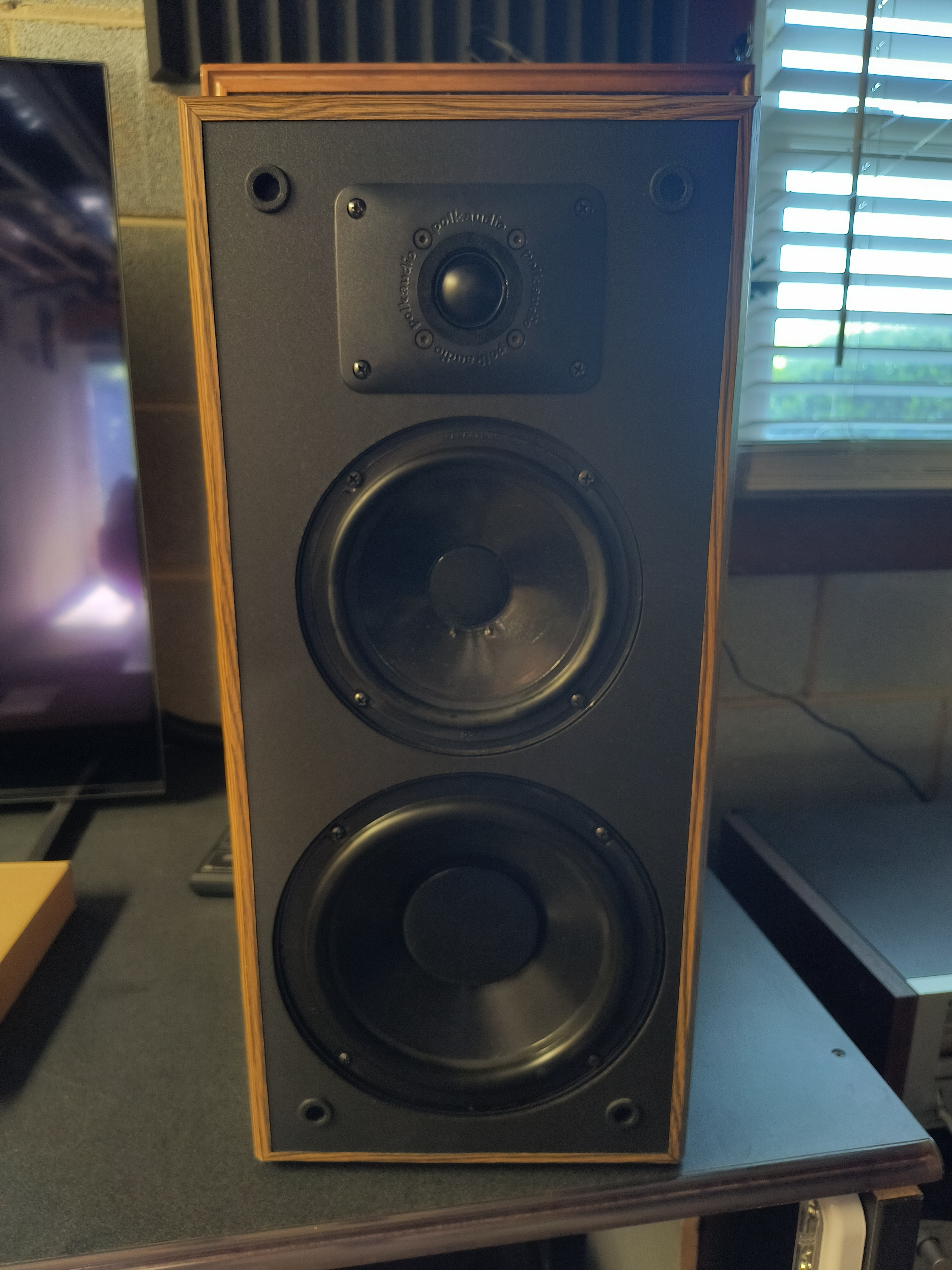

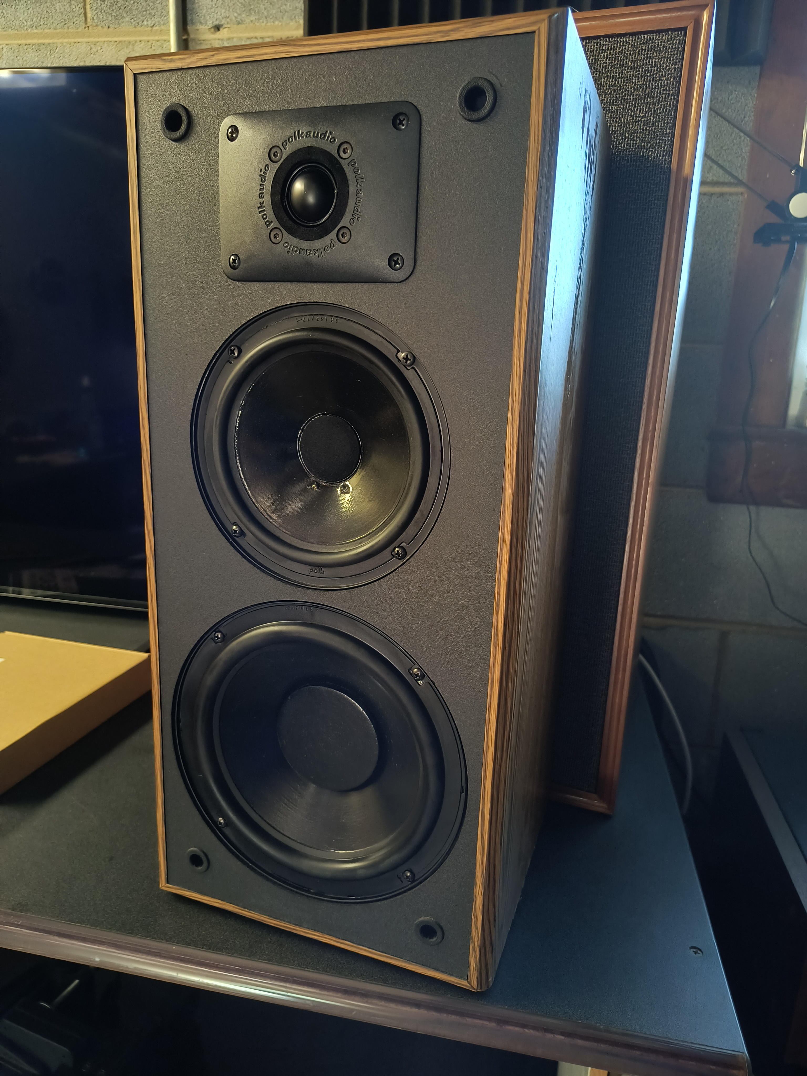

  • Posts: 6,262
    More pictures coming soon for reference. I just acquired a pair of these.
  • Posts: 6,262
    These cleaned up nice. Might offer up these as a forum karma.
