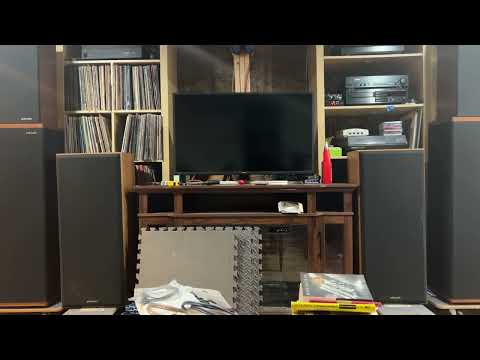

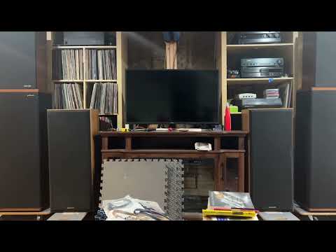

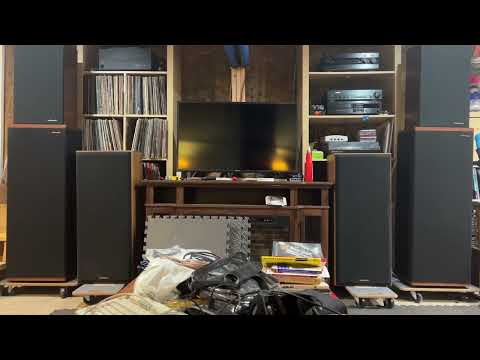

The LF12 tested well a month ago. I won't get to test them in a tidy, Radon-mitigated room for weeks, but the initial tests were wonderful.
58db peaks:
https://youtu.be/Zojac7rkb4s?si=GwVZ7WFzcFGrccBD
https://youtu.be/ujpbBeBY2co?si=IBqjw_0l1pBMh53d
68db peak:
https://youtu.be/fldmvL-B_RA?si=7voVPXXEOyg_uEPT
