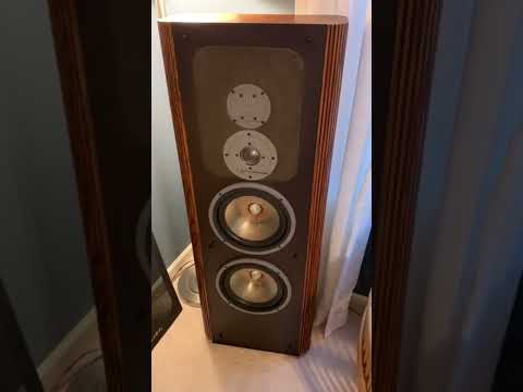

    I’ve had both the RSIIIa as well as Kappa 8. The Kappas had superior bass (and were a superior speaker) but the RS were no slouch in the bass department that’s for sure. The RSIIIa’s were really good speakers. Good clean power will bring out their best, and lesser quality power will result in lesser quality sound including bass. Rooms can also result in less than optimum sound quality, including bass.
    xschop Posts: 5,747
    You could double-check the woofer terminal connections are correct. Just one woofer out of phase will rob the bass output.
  • Gardenstater
    Gardenstater Posts: 4,887
    Looks like both of those woofers play the same signal and they play all the way up to 600Hz. I can't tell really if those "phase plugs" are attached to the cone or if they are attached to the pole piece and fixed.
    Phase plugs have more of an effect upon high frequencies. Very little to no effect upon low ones.

  • Gardenstater
    Attached to the cone it is as visible in this vid at 1:11

  • halo71
    halo71 Posts: 4,640
    On my RSIIIa's, they are attached to the cone.
    --Gary--
    xschop Posts: 5,747
    Agree with George. If they move with the cone, they are not phase plugs.
