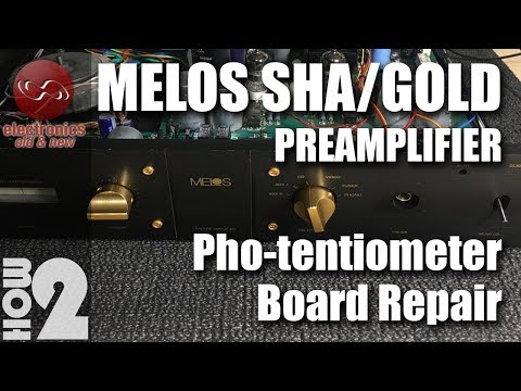

    Shame, bad Richee….this has been on the back burner too long. Still short a guy at work, too much OT, but enough excuses. Finally it lives, both channels output what they are supposed to.
    This video on you tube was a life saver. This fellow, M Caldeira, removed components and drew schematics. He explained the issues he ran into which helped solve the problem.
    https://youtu.be/R0AXvMcoWSg
    Sorry it took so long Carl!
