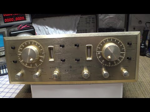

HH Scott 399 w/ Type 335 FM Stereo Multiplexer
Next up on the bench, an HH Scott 399 with HH Scott Type 335 Stereo Multiplexer.
The Scott 399 was produced in '59-'60, just before FM multiplex stereo broadcasts were initiated in 1961. The receiver sported separate AM and FM tuners for the short-lived simulcast mode. FM received the left channel and AM the right.
Scott produced the Type 335 FM Stereo Multiplexer so you could enjoy true stereo FM without investing in a new receiver.
The 399 has a fully integrated power amplifier with four 7189 output tubes and it includes a phono stage.

    Today I tested 23 tubes for the 335 and the 399. Only one bad 6U8 in the 399 which is a good thing. Two are 6F66/EM84 magic eye tubes for the tuners. I'll do those in circuit. There were multiple sentences of jump this and resistor across that to bother.
    Three tubes were broken in shipping due to bad packing by the seller who failed/refused to remove the tubes. Two 7189 and a GZ34. Bubble wrap around a 44-pound object, even double boxed, is not good packing. It's a wonder more damage wasn't incurred. Fortunately, the tuner and all controls operate smoothly. I had to reglue some joints on the cabinet.
    The wife gets on me today saying I used to be so neat and organized. I leave tools out on the bench. Test leads hanging. I would have made a form for the tube list. Now I'm just retired and lazy, I guess. I say what's the big deal, I can read my writing. :D
    I got ahead of myself and cleaned the cabinets up.

    I've been finding too many things wrong to attempt powering the 399 up with variac/dim bulb. Some are capacitor related. I started replacing those today. Still waiting on the Adapt a caps for the remaining six cans. C1 is the most difficult and I'm stuffing that can as it is at the very rear of receiver. You gotta make sure the right value is attached by the correct symbol.
    I have this Candohm resistor, R182 A, B, C in the schematic. It is supposed to be three 250-ohm in series, or 250, 500 and 750. This one measures 394.6-ohms across the first one and 1.178K-ohm total. I was surprised to see a reading, while high, to ground with it. I googled and learned the cambric paper burns thru and they can eventually short to ground.

    First, some progress. A terminal strip and three wire wound 250-ohm 5 watt 1% resistors replaced the Candohm. They are mounted favoring the side of chassis so they don't melt wires. (I have the wiring to front panel pulled aside to snap picture). Now we have 250/500/750 ohms. Wiring to be added when I do C8 capacitors.
    One thing I haven't seen anyone do is remove the resistor farm in middle of chassis. Two #6 sheet metal screws secure it. Lots of wires that connect to and go through it. That 'farm' obscures some rivets for the can mounting wafers. I also want to replace the selenium rectifier, something xraytonyb did not do.
    Now we're in really deep.....
    I want to drill a new hole for a bridge rectifier as the holes for the selenium strap are quite large for a 6-32 screw. I also want to move it over so I can make room for a chassis mount 33-ohm resistor. Currently, a 33-ohm 5-watt resistor cooks the carbon resistors above it. Carbon resistors can change value when heated. The bias resistor is at very top so a metal film will replace the carbon.
    One issue that is all mine, resistor R172. This is the first step down resistor in B+ off the GZ34 (380vdc to 360vdc). The schematic, Tony's 399 and one other fellow had a 160-ohm resistor in that location. I have a 120-ohm. It looks factory or we had a real good tech that replaced it. I'll be adding a 40-ohm in series to correct value to 160-ohms before powering up. I can always remove it. It will be replaced with a chassis mount.
    Space to rent now! If I can't figure out where all the wires go, I'll be heading east to a couple guys houses..... :D
    160-ohm 2W? 15K to ground, yeah, chassis mount for you too along with the 2K-ohm.

    Some progress. The selenium rectifier has been replaced with a BR34 diode bridge. The 33-ohm cement resistor that was hugging the carbon above it was replaced with 33-ohm 15-watt chassis mount. Holes in resistor mounting were perfect for a 4-40 tap so no nuts needed. I had to mount it a little crooked. The first mounting point had to be between resistors (that measure good) on opposite side. Had to drill second mounting hole above existing large hole.
    Yeah, it was a second attempt as the first one was too close to terminal strip.

    Replaced ceramic resistors with chassis mount. Mounting hole size for all three were good for 6-32 tap. I installed the called for 160-ohm in place of the 120-ohm I found in its place and was happy I did. One terminal strip was pretty cooked so removed it, connected wires direct between 160 and 2K ohm. The third resistor is 15k-ohm to ground so that side of chassis gets warm instead of ceramics baking wires/components above it.
    It passed the variac/dim bulb power up to line voltage without high amperage, smoke and fire drama. I couldn't get past 100vac before, so now I could remove the dim bulb and can run up to line voltage briefly to test voltages. The variac is still helpful as you can reduce voltage while you make sure tube bias isn't excessive. We are at 122.5vac today. Kill a watt shows it pulling 1.19A. The 399 fuse is 2.5A.
    Negative bias voltage came in at -53.95, schematic calls for -55vdc. B+ spec is 380vdc at line voltage of 117vac from GZ34 before the 160-ohm step down. I get 421vdc at 122vac line so I'm within that 15% +-. (437vdc would be15% over).
    Check out what 117vac does with B+. 405vdc, -16vdc lower. Thats why some guys use bucking transformers or thermistors to reduce line voltage on their vintage gear. Thermistors must have amp rating for the gear it's installed in and I read they can drop 2vac. I guess the main thing is if you can bias tubes properly at your line voltage. Xraytonyb changed a resistor (8.2k to 10k) in the bias circuit of his 399 to allow more adjustment from the pot.
    Bad news, missing B+ in a circuit. FM doesn't work, played vinyl but volume and balance pots need work.
    B+ at line voltage of 122vac.
    B+ at line voltage of 117vac.
