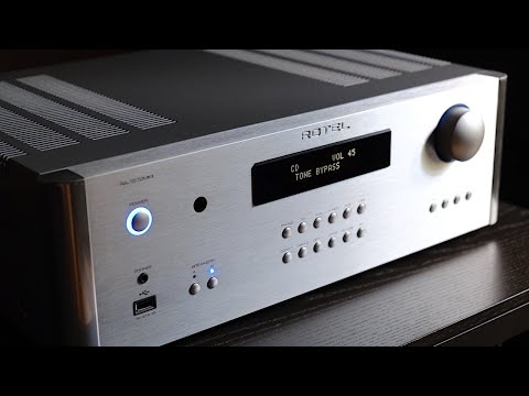

Edit: Realized that Rotel couldn't even be bothered to make all the front LEDs the same color. The power button and the speaker selector have different colored LEDs.. incredible.

    In videos and certain pictures it really stands out. If you zoom in on the silver model it's very apparent.
    I think the previous gen Rotel preamp paired with the RB-1590 cuts down on what appears to be 4 different hues (tones?) Of blue.

    It's very apparent in certain videos and pictures if you zoom in. The power button, speaker selector, LCD screen, and possibly even volume dial are all different hues of blue!

    LED light does not photograph well. In addition, the power and volume are backlit while the speaker LED lights are direct. At least they are all blue.
