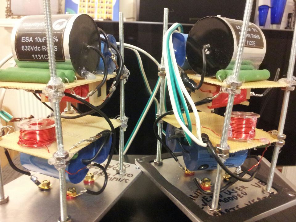

    I did the VR3 upgrade buying all the parts from VR3. I am pretty good with electronics, like soldering IC chips, reading wiring diagrams of cars, tracing circuits, etc. So I felt pretty comfortable with doing the labor parts myself.
    So with this, I modded one side of the speaker and not the other to see if I can tell the difference AND I COULD! Keep in mind I touched absolutely nothing except the crossovers, so no fiddling with settings and stuff.
    The modded one was much more efficient in the following ways:
    More sound volume than the unmodded one.
    Much more sound from mids
    Softened up overall sound because of the mids and tweeter (I felt the sound was very bright, which is great for action movies, but really sucked for stereo music or instrumental stuff.)
    Better staging and ramping... basically you can really hear the roundness of the sound as it comes around
    Currently have about 30 hours on them, so things are probably only going to get better as I get closer to 100 hours.
    VR3 has been pretty busy with his house renovations hahaha.... but look in the DIY section.
    Let me know if you have any questions.

    Wow...more volume?? seems hard to belive..LOL But what i'm i look at in that pic?? Is that the back of an rt1 12..thats metal...whats on the back of mine "assumeing" were looking at the back plate of were the speakers connect to is plastic..unless thats just a cover???
    I have no problem with soldering or anything else. I looked in the DYI section..could find nothing in there.
    If you could tell me what caps you replaced and what else you did would be great.
    On SDA's you have to pull the speaker...to get to the x over, this somehow looks like the back of were the speakers connect...is that right???

    Well heiney9..nobody told me in the last thread..how to do this. Now i have a Pic, and somebody that did it. So for me..that pretty much works. Since i could not find the info to do it, it think it's pretty nice that slider showed me a pic..and may tell me how to do it.

    Try this link, I think it has what you are looking for.
    http://www.polkaudio.com/forums/showthread.php?128992-Vr3-Fortress-Edition-Mods

    WoW....all i can say about those upgrades....Just again WOW. To put a faceplate like that, plus the caps and whatever..man that's over the top. To be honest, not sure i could afford that as an upgrade. But if VR3 is willing to send the cap's and stuff you need for the upgrade, or at least tell me what caps and stuff he used. Then maybe the price would not be so bad..LOL Maybe the 12's don't need a massive upgrade....but again WOW..my hats off to you.
  • Posts: 1,627
    edited April 2012
    On mine he used the same parts that the stock xo uses. Just better quality.
    I belived he used Clarity PX caps in the woofers, and mids, and Clarity ESA caps in the tweeter network. He also used Mills Resistors.
    The caps have the same value they are just a different style. The factory xo's use a electrolyte cap (fluid filled). The Clarity Caps are desinged for audio, and are a Poly Film style cap. He doenst really change value's he just upgrades the quality of the componets, but the better componets are a lot larger and take up more space.

    He done mine before he had the aluminum plates made. I think in fact mine were the first to use the threaded rod, and extra bread board.
    I also dynomated all the drivers while I had them out.

    Yours was the first set of RTiA7 I did and when I saw them I almost fainted until the ligth bulb went off!
    I have done close to 20 sets or so of speakers using that stacked method now! I love it and makes the end user have such an easy job.

    What you are looking at in the picture are basically the crossovers. The crossover is basically the plate that the speaker wires connect to. Yes seriously, its more volume because its more efficient components. Just think if the crossover network is cleaner in all ways, it WILL increase volume or throughput.
    You are looking at VR3's Fortress edition, basically metal back plate with thread rods and stuff.... But yes VR3 is THE guy to talk to and instrumental in all my decisions. Next stop are my FX500i surrounds, but man that thing doesn't have a lot of room.
