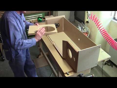

    Sand is said to help attenuate the vibration as heat from the friction of the quartz/silica grains rubbing against each other. Steel shot is more dense. Makes sense to do a combination for a speaker stand. Just saw a video the other day where they use it in the Swiss made top of the line Jean Mauer loudspeaker where the back is an inner layer of hardboard and outer layer of grooved chipboard with sand inside. They also use sand inside the double walled enclosures for the midrange and treble drivers.:
    https://www.youtube.com/watch?v=FH3mmRLjKxU
    https://www.jeanmaurerhifi.ch/annexes/catalogues/loudspeaker-technical-document.pdf#page=15

    Wonder why they stopped at just using a pin/pointed rod on that MW to rear enclosure.
    Was that Matt Polk moonlighting? He had a labcoat.
  • Gardenstater
    Gardenstater Posts: 4,857
    xschop wrote: »
    I think the tapered needle (threaded into the hollow bushing) is to help establish laminar flow vs turbulent for the under dust cap back wave of the woofer and the screw (also threaded into bushing) on the back of the speaker is adjusted to compress the sand cavity and thereby adjust it's resonant frequency.

    xschop Posts: 5,659
    xschop wrote: »
    Our vintage MW stamped steel frames can handle a pre-stressed rod from pole-piece to back baffle.
  • Gardenstater
    xschop wrote: »
    xschop wrote: »
    Yeah I watched the video again and there is not a vented pole piece on the woofer. So the prestressed spike/pin transfers the reaction force of the woofer back against the preloaded rear enclosure that is filled with sand. There is a viscoelastomeric foam rubber isolation scheme between the front baffle and the woofer so the baffle is somewhat isolated from the woofer.
    We are corrupting this thread :)
