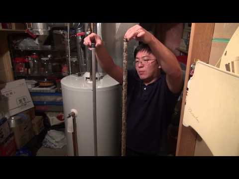

  • I think this link is pretty helpful. Magnesium anode rods are best for soft water and aluminum or aluminum/zinc rods are best for hard water. The 10% zinc prevents the sulfur smell. I hope that's the type of anode rod I have because my water is one of the hardest in the nation. The anode rod donates electrons to the tank and in that process it is the thing that corrodes more readily than the steel tank does. I think a good tip would be to get a socket (I need a deep reach) and breaker bar and loosen your rod 1/4 turn and retighten and do that a couple times per year. I may just go ahead and replace mine at 5 years and see how bad it was. I have only 33" of overhead clearance so may have to put a vice grips on the rod and cut it before extracting the whole thing. Then replace with the 3 segmented type. I am also seeing that the warranty on a water heater reflects how heavy duty (more corrosive electron donor metal) the anode rod is. My plumber friend up the street from me neglected to tell me that or didn't know, because he told me the tanks are the same so get the smallest warranty one. I got the 12 year lol.
    https://www.empirestateplumbing.com/about-us/news-and-events/34154-what-does-an-anode-rod-do.html

  • Good video and good comments. The author of the video said in comments that anode rods go faster in soft water, which was interesting. I'm not so sure about using teflon tape because I believe it needs to be grounded to tank. Maybe a thin coat of liquid pipe seal or nothing at all.
    https://www.youtube.com/watch?v=kIpJDHco7hc
