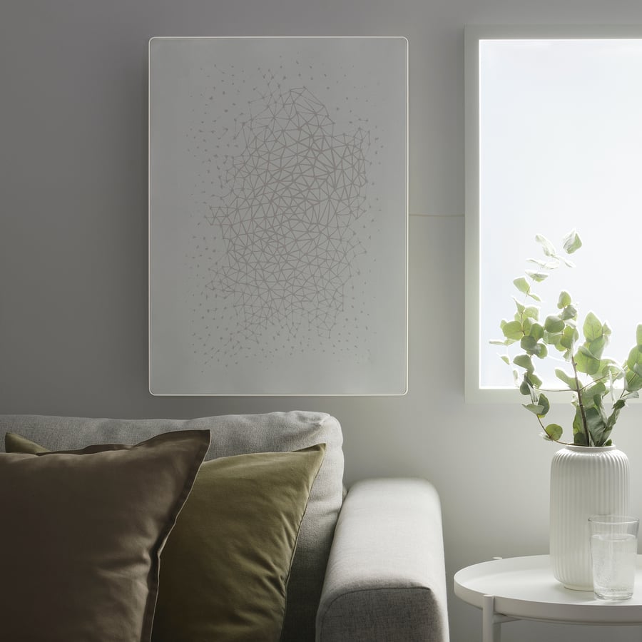

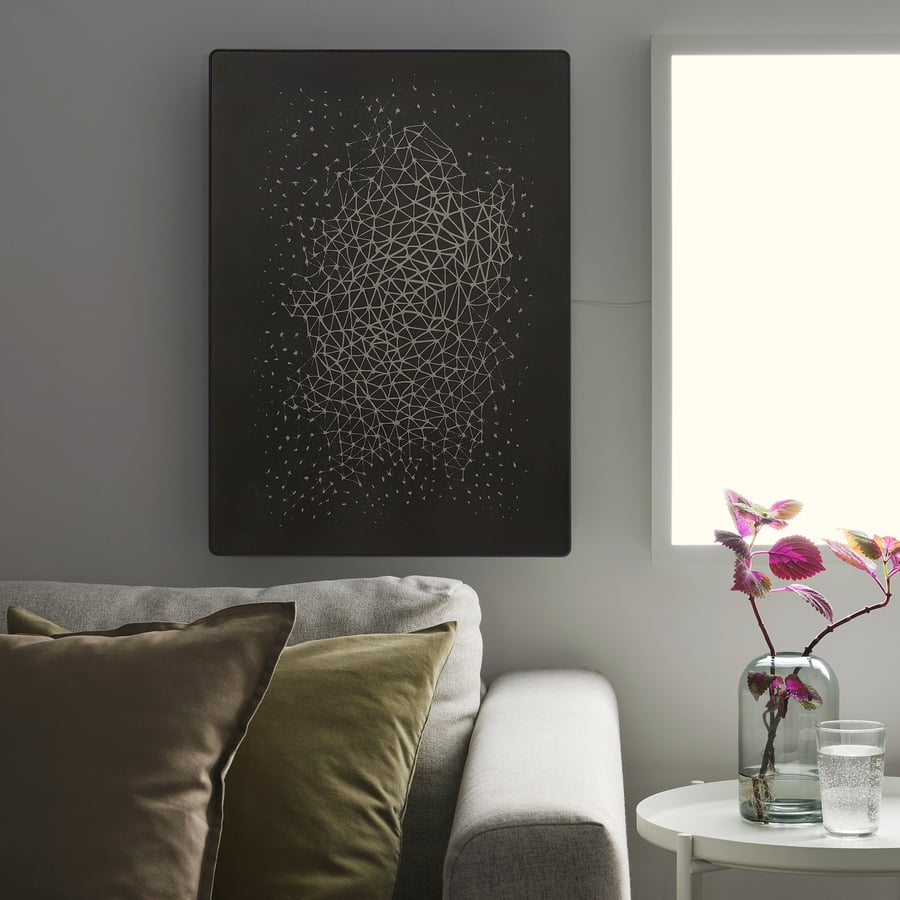

Ikea is even getting into the Architectural picture frame market with its NEW SYMFONISK Wifi speaker.
https://www.ikea.com/us/en/cat/wi-fi-speakers-46194/
