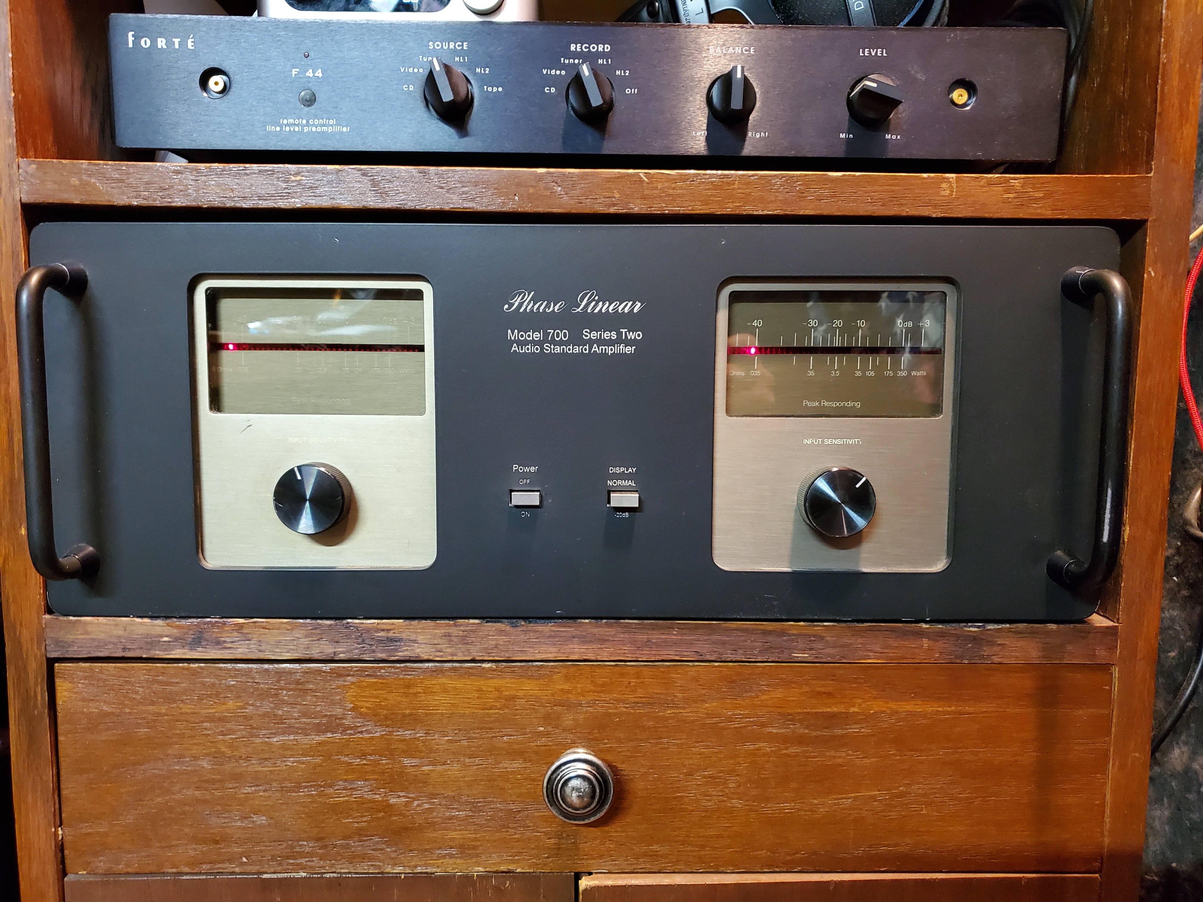

    I can say I have had many power amplifiers. I have restored quite a few including installing new filter caps. Nothing left out. As of today including A Krell KSA-150-B&K's (EX 442, Reference 4420's, M200 Monoblocks)-Conrad Johnson MV-75A1- Yamaha (a few different ones but do not recall all the model numbers)-Kenwood Basic M2 (that Dan at DRM built himself)-Adcom GFA-565 monoblocks with new Hoppes Brain boards-Phase Linear 400 (restored with all new parts but not WOPL'ed)- SAE 2401(was the closest contender) Carver M-1.5-Carver M-400-McIntosh MC-2205-Parasound HCA-1206 (ran bridge mono for two channel stereo) Dynaco ST-70's on and on and on and on literally 100's of amplifiers I have went through now trying to get the sound I was hoping for. No way I could recall or take time to write down here. Now that I have a White Oak Phase Linear (WOPL) 700 Series II complete with all the White Oak parts available for the amplifier including Don's DC output protection board (Watts Abundant) that none of these touches the sound quality and power and black background of the WOPL. Its completely quiet at idle. No sound from the speakers can be heard at the lowest volume with the pre turned all the way down, no music playing ear up to the speakers. No hiss, no nothing. I have even thought at first that the amplifier was not on because of it. I cannot tell you what to do. No one could tell me. Its not that I did not want one no. I had heard all the guys talking about them forever at Phoenix site and loved the Phase Linear 400 I built and the sound of it. I simply did not want to spend the money to buy the core amp then order all the parts and do the complete job because I did not believe that after doing all of that I would have an amplifier that sounded that much better than all those others. All amplifiers (of good quality) "sound the same" right? How many times have you heard that? Well, I have known better than that for a long while now but I had no clue what was in store for me and my SDA's. This is the best amplifier I have ever owned. It sounds better than any I have owned. It will last me a lifetime because It is basically brand new with the exception of the rear case and the transformer. If you are still searching for that special amplifier that will make your system what you have always wanted it to be you really do owe it to yourself to at least find one to listen to. I have found now that I have the WOPL Series II PL 700 that its not always what you hear, its also what you do not hear... I paid for this amplifier. I do not sell or restore Phase Linear WOPL's. I am not and have never been paid for saying anything one way or the other about WOPL amplifiers. I learned the hard way. I will keep one of my amplifiers for a back up unit. Otherwise no other amplifiers will find their way back in to my system and the rest will be on the chopping block very soon. Sold to the highest bidder. Gotta give thanks to Lee at Phoenix. Otherwise, I would have never had the chance to own this amplifier.
    The amp in my old scarred rack in my "office". Scars courtesy of all the other amps I tried..
