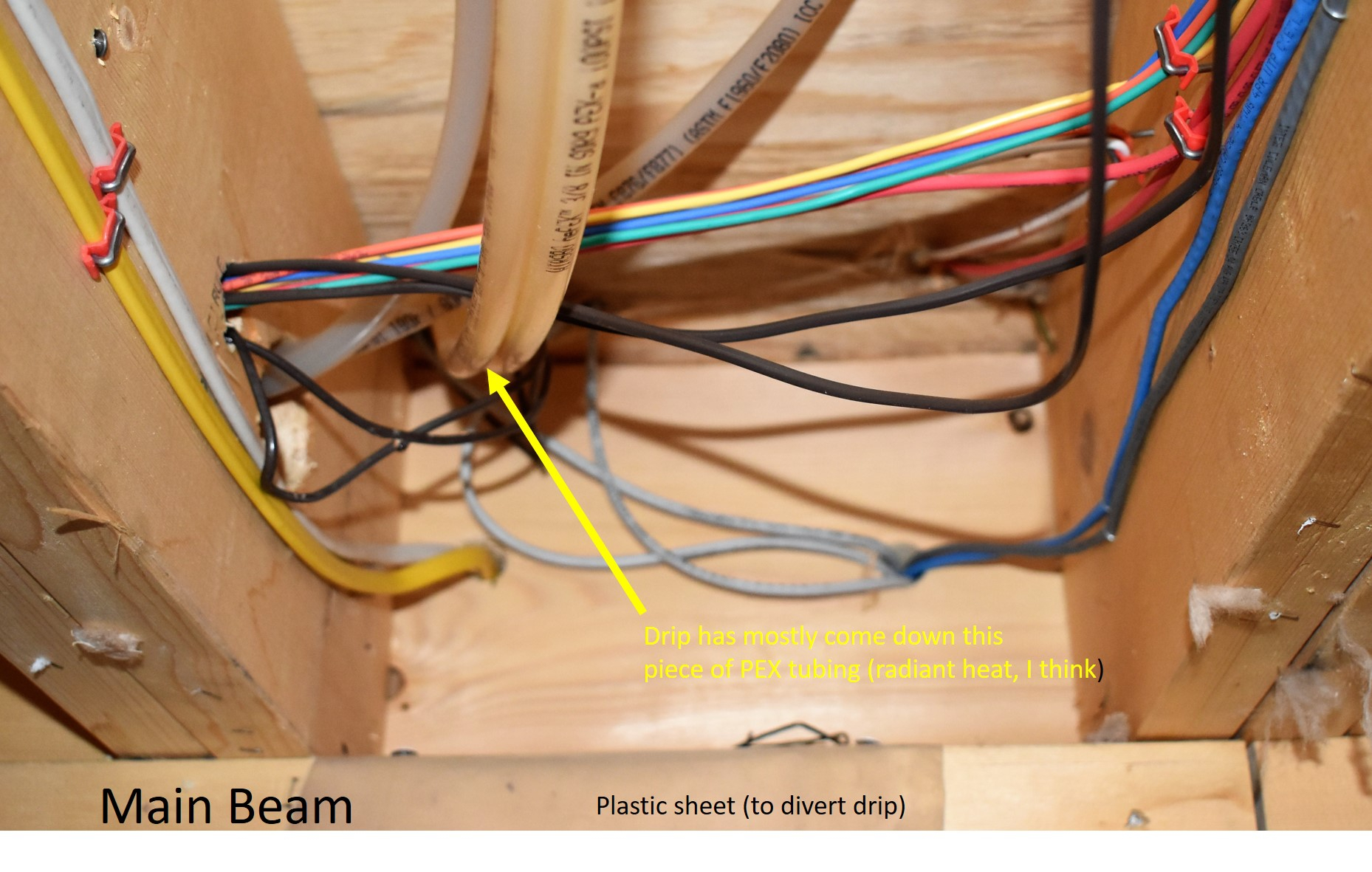

    Set some traps last night at the top and bottom of the wall (i.e., attic & basement).
    Woke this morning to find one mouse that had been transformed to, shall we say, an erstwhile mouse. B)
    Now, that may not have been the smoking gun -- but at least it's a start!
    There is still a very slow drip (1/2 inch of water in a 5 gal bucket overnight) but places I can see are dried out and the plumber'll be back next week. I feel like we're stable for now.
    Actually not too worried about mold per se. Worst case, I think, would be one 16 inch "cell" (section of wall between two studs) full of soaked insulation. We shall see.

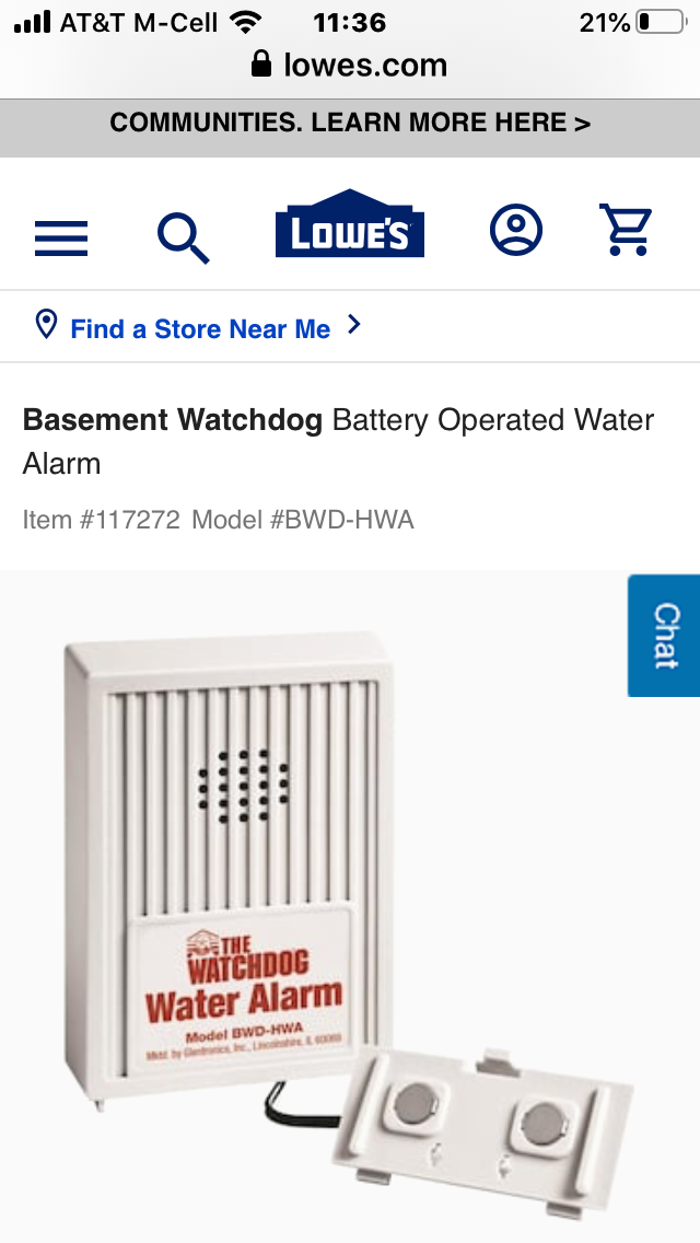

    While this wouldnt help with radiant heating applications -
    I have been using a Flo by Moen device for over a year and within a couple hours it detects, notifies, and will shut off water if it detects a drip in a faucet. If it detects higher than normal GPM (burst pipe) or any abnormal water usage it notifies you within minutes of the event starting. I cant recommend this device enough for protecting your home from water leaks (plus it monitors water usage and such)
  • charley96
    charley96 Posts: 344
    Good idea on the detector. I always shut my water off whenever I'm out of town for a few days. Girlfriend had a neighbor who came home to an $800 water bill when he was gone for a month. He had a mess when a pipe broke.
    VR3 Posts: 29,549
    Absolutely, the device allows you to shut off your water anywhere in the world with the touch of a button on your phone (on top of the monitoring for leaks and monitoring water usage) + it lets you compare your actual water usage to your utilities company claim to what you used

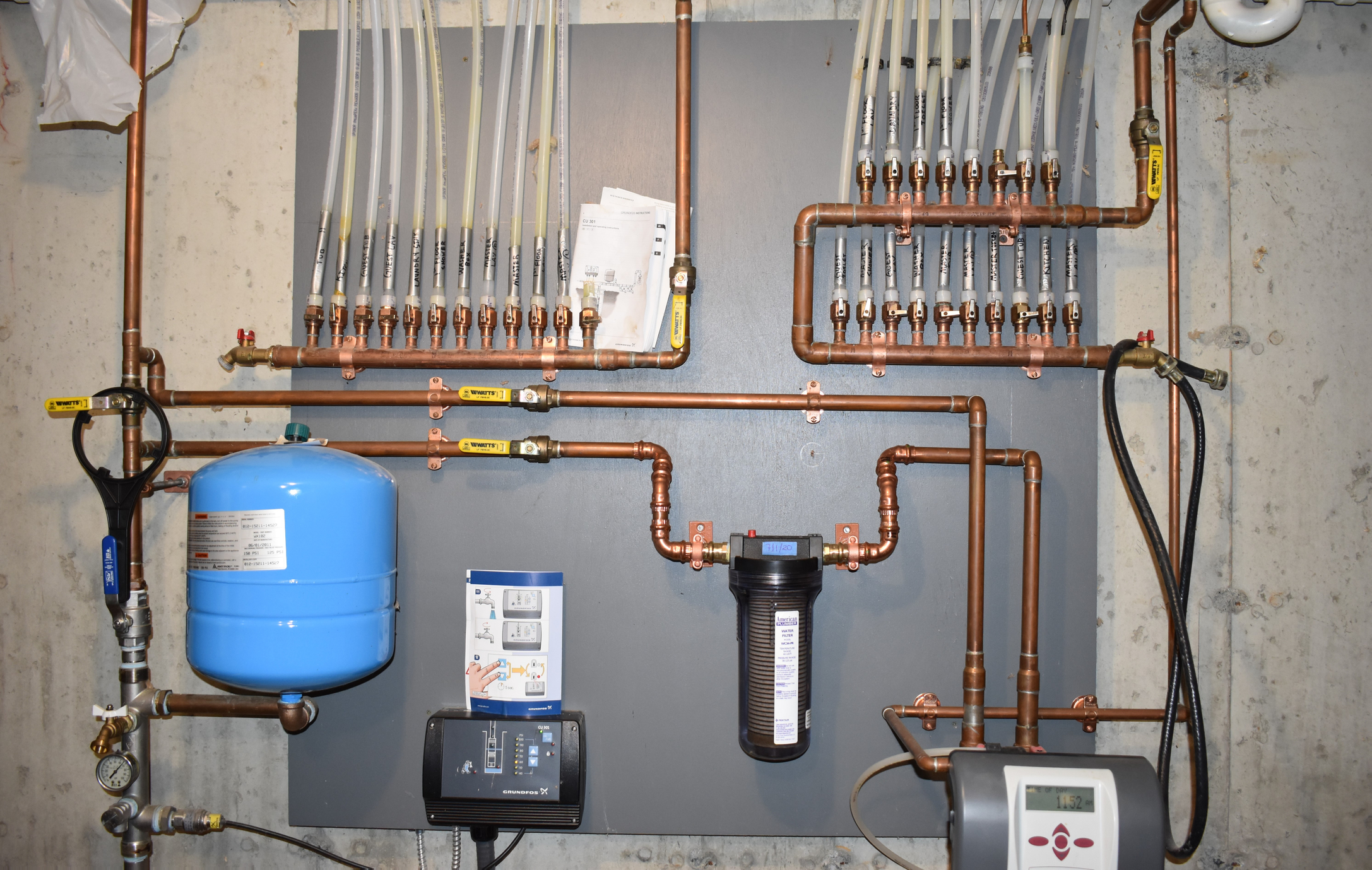

    We are exceptionally lucky with the construction of this house. Right now, we have all of the valves closed on the heating zones, but the domestic hot water circuit is still operating.
    All of our hot and cold water lines have individual shutoffs on two manifolds in the basement. When we discovered the leak, I shut 'em all off (EDIT: all of 'em that go to the second floor, that is). After the leak was markedly slowed, I have turned lines back on, piecemeal, to see if any of the domestic water lines could (also?) be involved. At the moment, everything to our bathroom is turned back on (except the tub hot and cold supplies -- since we never use the tub!). All of the supply lines to the "guest bathroom" are still off -- except the terlit (because, well, you know... you can't have too many terlits on-line!). :)
    EDIT^2: I realize this wouldn't help in your case, though, since the issue's where the line comes in to the house :(
    Here's a photo of Ground Zero :) I just sent this to the plumba as a gentle 'ping', since I think he's back from Wyoming as of yesterday. ;)
    EDIT: The mousetrap is partly visible to the right side of the beam. :) There have been no further executions - for better or for worse - since the initial one the night of the event :|

    Many years ago I had mice chew the plastic parts out of the bottom of a dishwasher, including the hose that let water out of the machine. I only noticed it because I turned the dishwasher on one day and heard water cascading downstairs when the dishwasher reached its rinse cycle. Mice gnaw on whatever is available and they follow wiring and pipes through a building, but they also need water. They'll get at water however they can including chewing up plastic pipes.
    It's also possible, I suppose, that the radiant heating PEX pipes got worn over time by foot traffic on the floor above. Unlikely, but possible.
