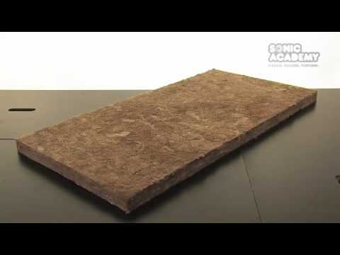

    I am a big DIY'er and my budget is tight. Can i build these acoustic panels myself? this would be handy cause some of my panels would need to be non-standard sizes. I see a lot of info about using rockwool that is cheaper that the Owens Corning 703. Any thoughts on what material to buy? roxul?
    Yes you can.
    You may get different answers regarding mineral wool (rock wool) and Owens Corning 703. The folks linked below say it's near the same. Cover it with a fabric that does not reflect sound. Guilford of Maine is one such fabric available in all sorts of colors.
    Build a frame out of 1 x 4's. The ones you buy usually use select grade lumber that's nice and straight. Price everything first and then compare.
    https://www.atsacoustics.com/blog/oc703-vs-mineral-wool-acoustic-panels.html

    I made rockwool panels for my room, and they improved the sound tremendously. They absorb sound waves and cut down on echo and ringing. Hang on reflective surfaces throughout the room: behind the speakers, behind the listening spot, and on the sides between the listening spot and the speakers. Feel free to experiment, too. I may try one more as a "cloud" suspended from the ceiling at the reflection point between my seat and the speakers.
    You can buy a bundle of 6 4'x1.5' rockwool panels, and mount them to frames made out of 1"x2" wooden strips. Wrap them in a light fabric that will let the sound waves pass through easily. I used cotton sheets. There are several different youtube vids showing the process. Cost was less than $50 at Lowes.

    https://www.lowes.com/pd/ROCKWOOL-COMFORTBATT-R-15-Stone-Wool-Batt-Insulation-with-Sound-Barrier-15-25-in-W-x-47-in-L/3388304
    Here's the stuff. Keeps its shape, but you can compress and dent it, so handle it gently. Wear gloves. The weight is accurate, but the finished panels are safely hung on a couple of nails. 3-1/2" thick is a good density and gives good absorption. The wood frames are important, as they hold the insulation away from the wall.
    Here's an easy way to do it: https://www.youtube.com/watch?v=spg4y5_zsMs
