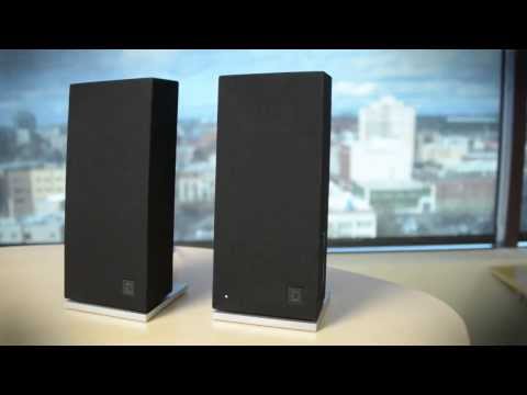

    My girlfriend and I have a set of "traveling speakers" from Definitive Technology. When we spend a week at the beach a couple of times each year, we take them. These speakers are bipolar, have a passive radiator and a built in DAC. Our laptop has all of our music ripped to FLAC and we use JRiver to play.
    The speakers are the Incline Speakers and sound quite good. The first time we took them out of the box, the volume was turned up and we shocked how loud and clear. The price was about $400 when announced in 2014. They were discontinued. We purchased them on sale for about $175.

    Ya sounds like they work well for ya.. I like the idea of passive radiator ever since then
