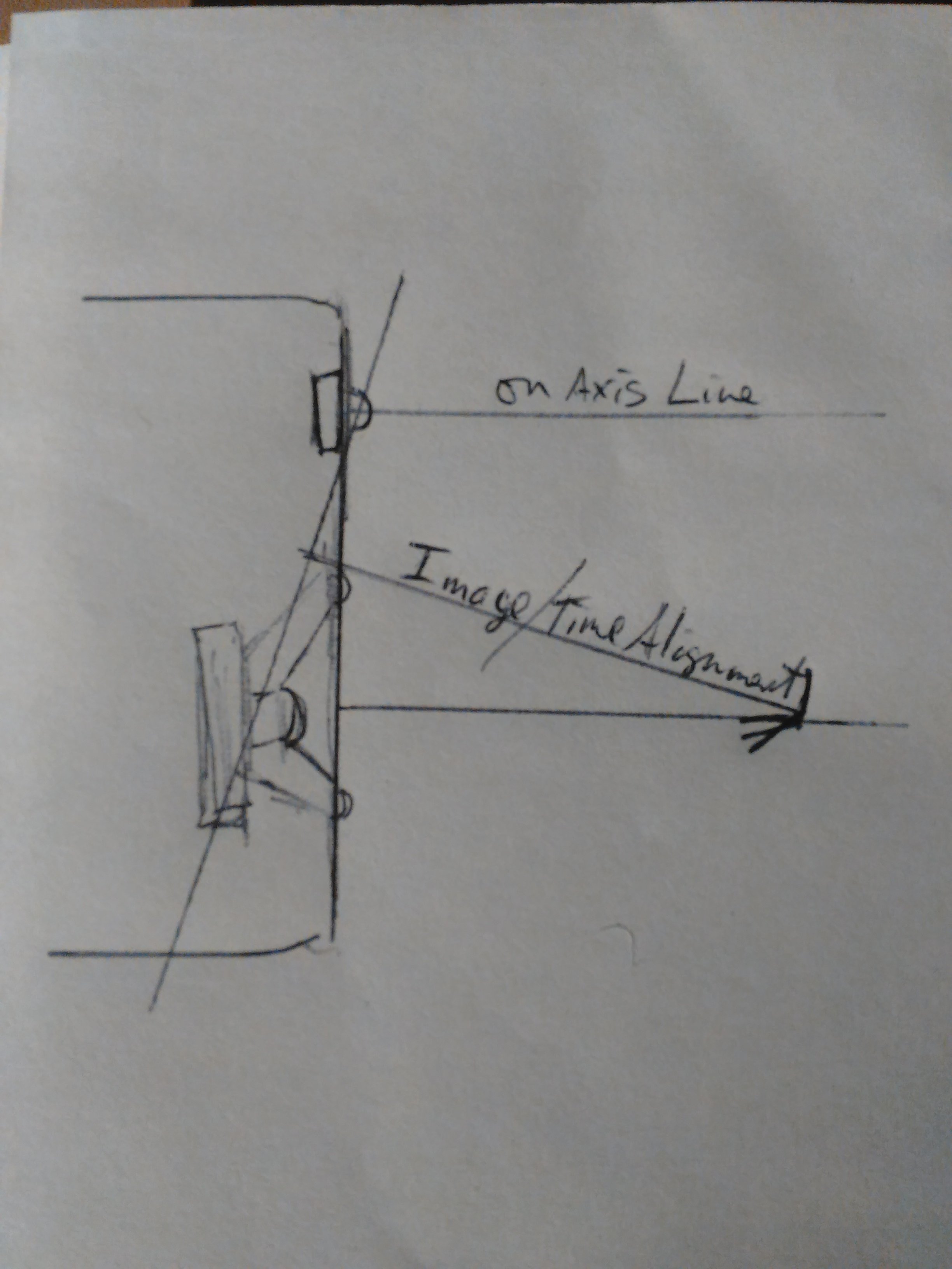

    In the current placement, the image is facing more vertical, by way of the driver coil alignment. Draw a straight line from tweet coil to MW coil, then come out 90° off that line and that's where your speakers are facing. Now there's also an arced phase shift between that line and the on axis line. If you flip the speakers, the line move accordingly. Now since these are surrounds and not being critically listened to, the phase shift won't be noticable, but the image shift will. You should easily hear that, especially if you don't recalibrate after the move.

    Oh I think I see what you mean. So currently the tweeter is farther out than the woofer but I would switch that and put the tweeter farther back. If that's not what you meant then all this phase shift stuff is way over my head haha

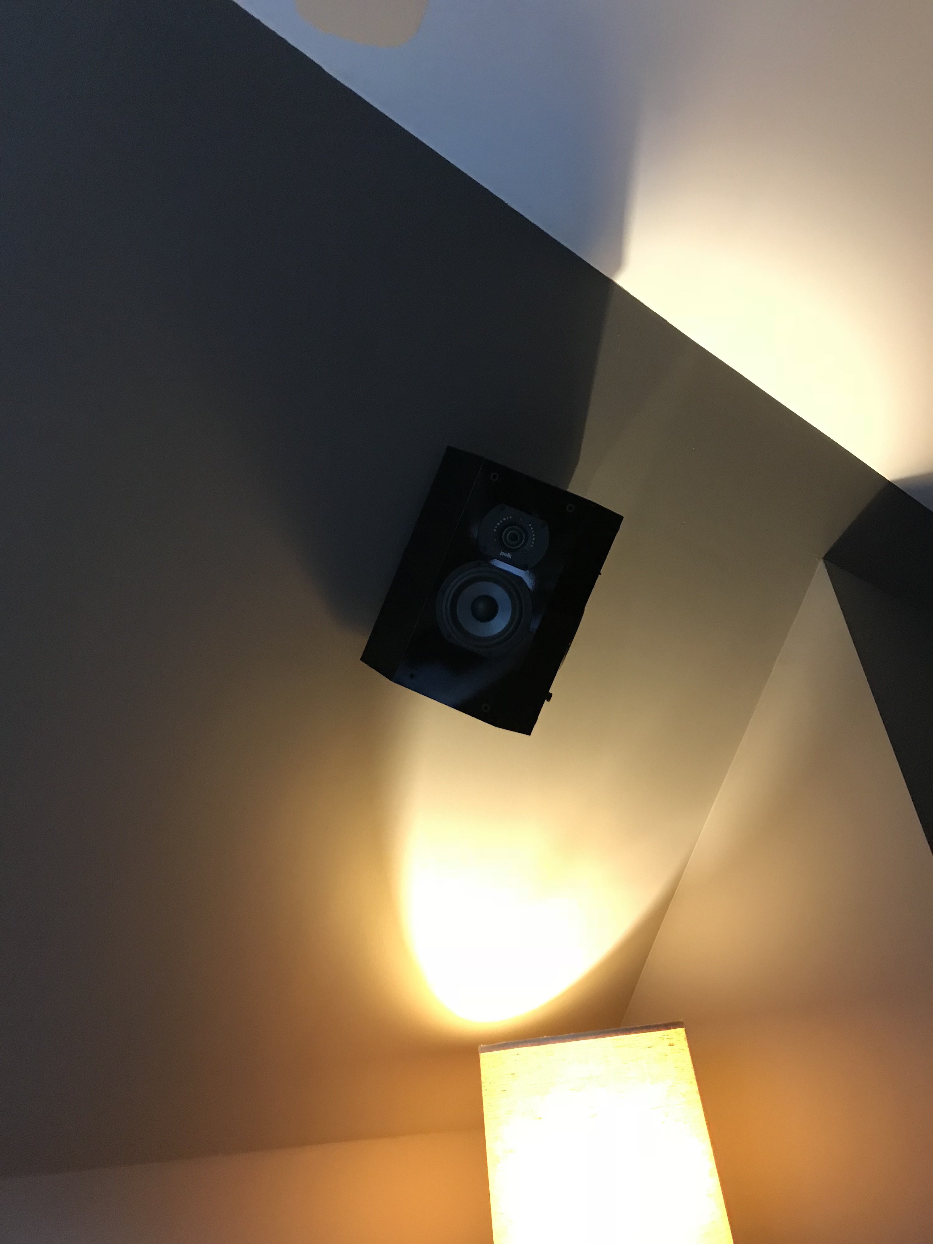

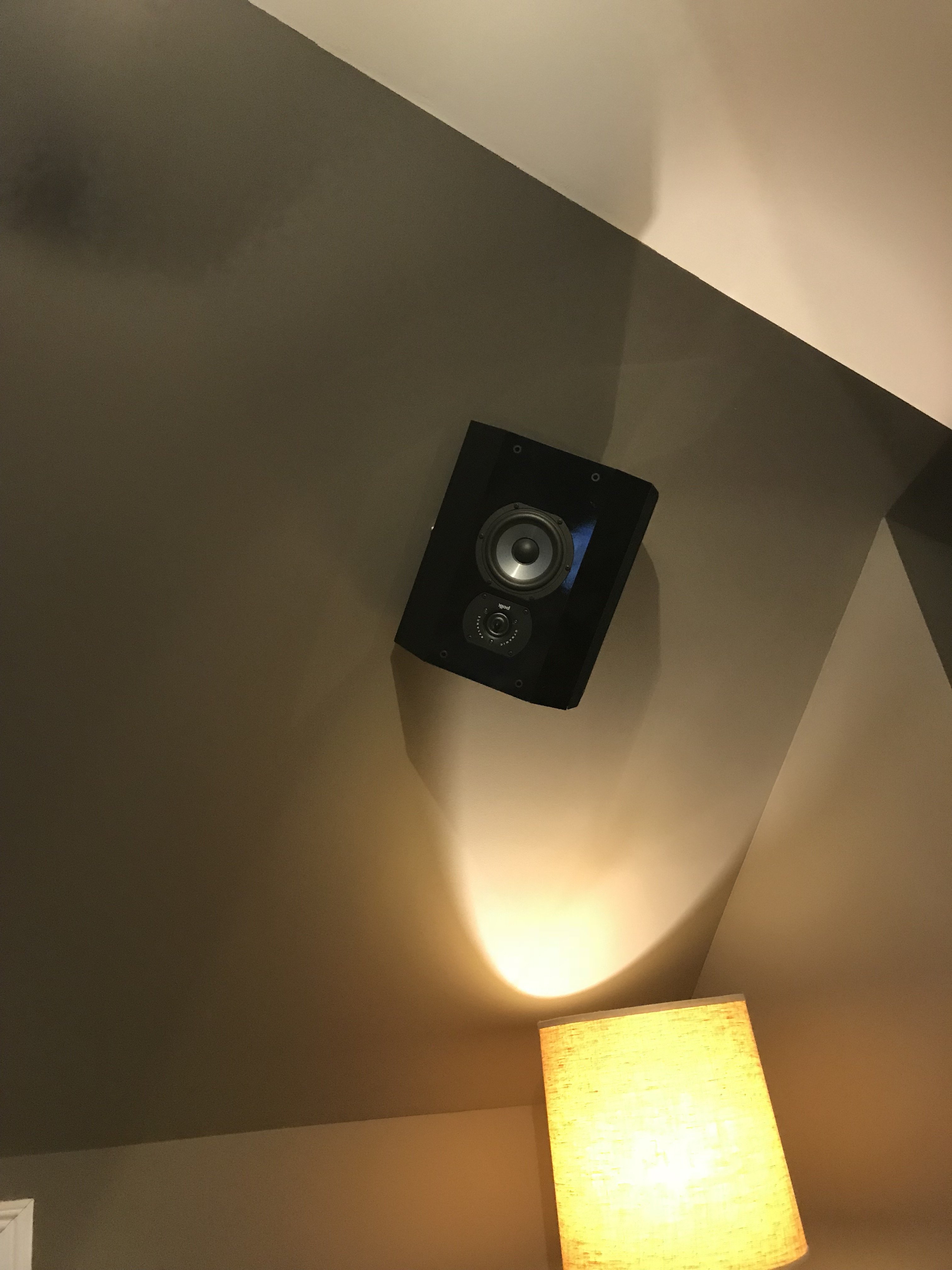

    Alright so I did it. It wasn't as hard as I thought. A little tricky unscrewing the powerports from inside the speaker without accidentally hitting the XO or knocking down a port tube but I managed to get it done.
    For anyone else attempting to do this, it's really not that bad. One thing I didn't consider was, do I have enough wire in the wall to go to the new location of the binding posts (luckily I did). Also, you can't turn the tweeter upside down to make the logos look correct. There are notches in the MDF that match the top of the tweeter only. Maybe you could take apart the tweeter and switch the plastic cover but I'm not that concerned. The grills go on upside down just fine.
    This moved the center of the tweeter down around 6" but I think will help shift the image back and more towards the listening position. I'm going to play around with them tonight to see if they sound any better.
    Pics are from the listening position.

    Thanks! It definitely made a positive difference. The rear is filled in better and blends a lot better with the front. It’s not perfect but much better than before. Since this isn’t a dedicated bespoke movie room I’ve gotta make due when it comes to placement. Worth the effort for sure.
