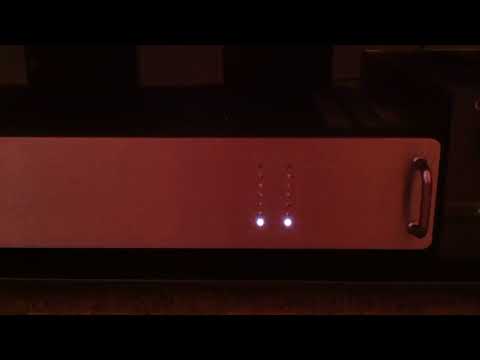

    I had my M1.0t modded with the MKII and 002 mod as well as redoing the LED's in WHITE and it was STELLAR on my LSi 15's. When I get time, I will post the youtube video of it in action.
    IIRC @Sea bought that amp off me and has been enjoying it quite a lot and even got Bob to sign it at Carverfest...
    **edit** my videos were on Photobucket... so right now they are stuck in jail.... If there is interest, I will download them from Photobucket, upload to youtube and post them here....
    I need to download all my photobucket stuff anyway since they went a broke the internet/all my threads for the past 10 years... :angry:

    EndersShadow please post pics !!! I've done a lot of computer mods, overclocking, water cooling CPUs etc. All of my PCs are home built. I know going in that their life expectancy is shortened as a result of the tweaking, due to everything running much hotter.

    EndersShadow Posts: 17,722
