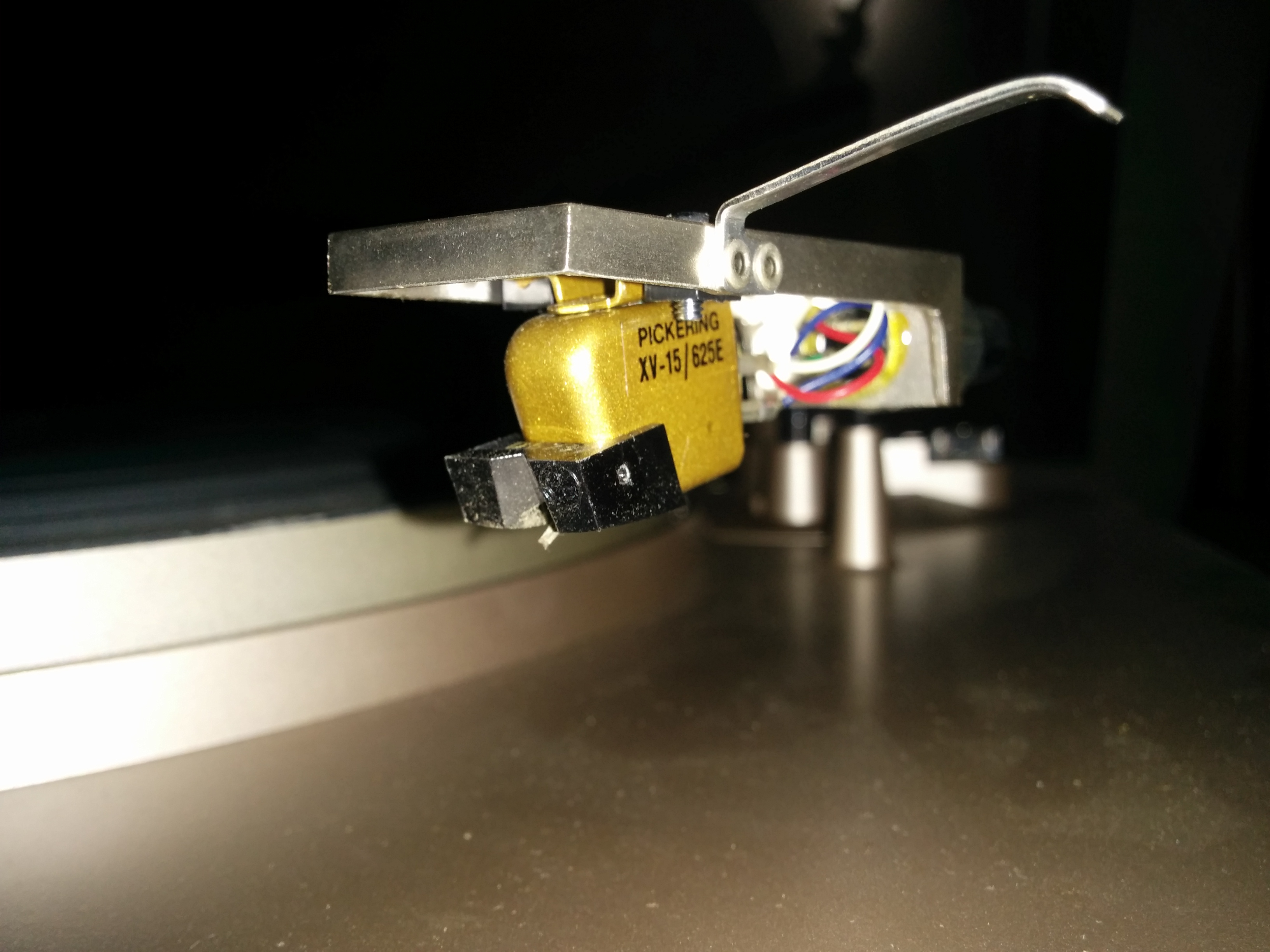

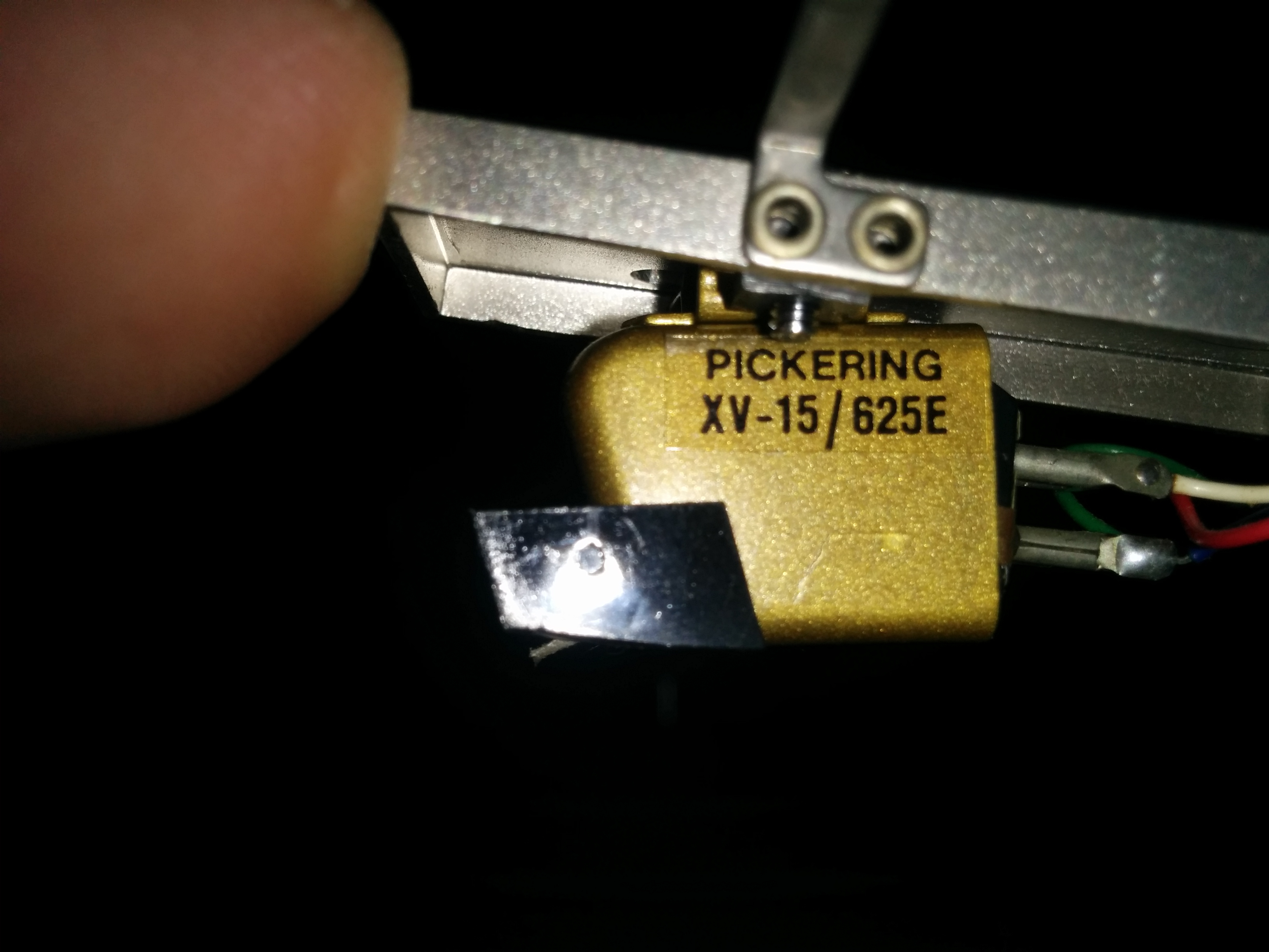

    OK, here's some pitchurs she sent of the tone arm.
    It apparently has a Pickering XV-15/625E
    It might actually still be good if it's a Pickering. That's a $150 cartridge. I don't want to test it on any of my vinyl, though. Well, maybe I can find some junk stuff from my neighbor and see how it plays. Still a replacement source for something worthwhile, not necessarily $150 worth orf worthwhile would be cool.

    Replacements for that stylus should be easy to find...not pricey either..Thought you said the cantilever was broken off?..That one looks intact...As long as the cartridge is installed correctly,it can't damage your vinyl...Other things that will are too heavy of tracking force,incorrect tracking angle..mis adjusted anti skate..or worn out stylus tip..since your table does have a bit of age on it..I'd be checking all those items..
    mhardy6647 Posts: 35,190
    edited November 2017
    That was/is indeed a pretty good cartridge.
    The stylus isn't there? It looks like it is.
    Literally any Pickering stylus (from that era of cartridge body design , which was a long era) will fit on it :)
    So should any classic Stanton stylus -- Pickering & Stanton were sister brands in those days (which I only learned recently).
    I would think old stock aftermarket styli from EVG or Pfanstiehl would be OK choices. I don't know if Jico makes styli for Pickering cartridges(?). If so, that would probably be the 'premium' choice today.
    The cartridge, sooner or later, probably deserves a pretty good stylus :)
    If you/she goes with a cheap stylus (e.g., a low-end Pickering elliptical or even conical), try to set the VTF in a range akin to that of the stylus's original cartridge. (That wasn't a terribly well crafted sentence, hope it's decipherable!).

    SHE said the needle was snapped off.
    Honestly, it looks in good shape to me.

    blow up that first picture. seems to me it is just the tube no needle. but then it looks like a needle in the second.

    That diamond is there. It might be a half of a stylus but there is one there.

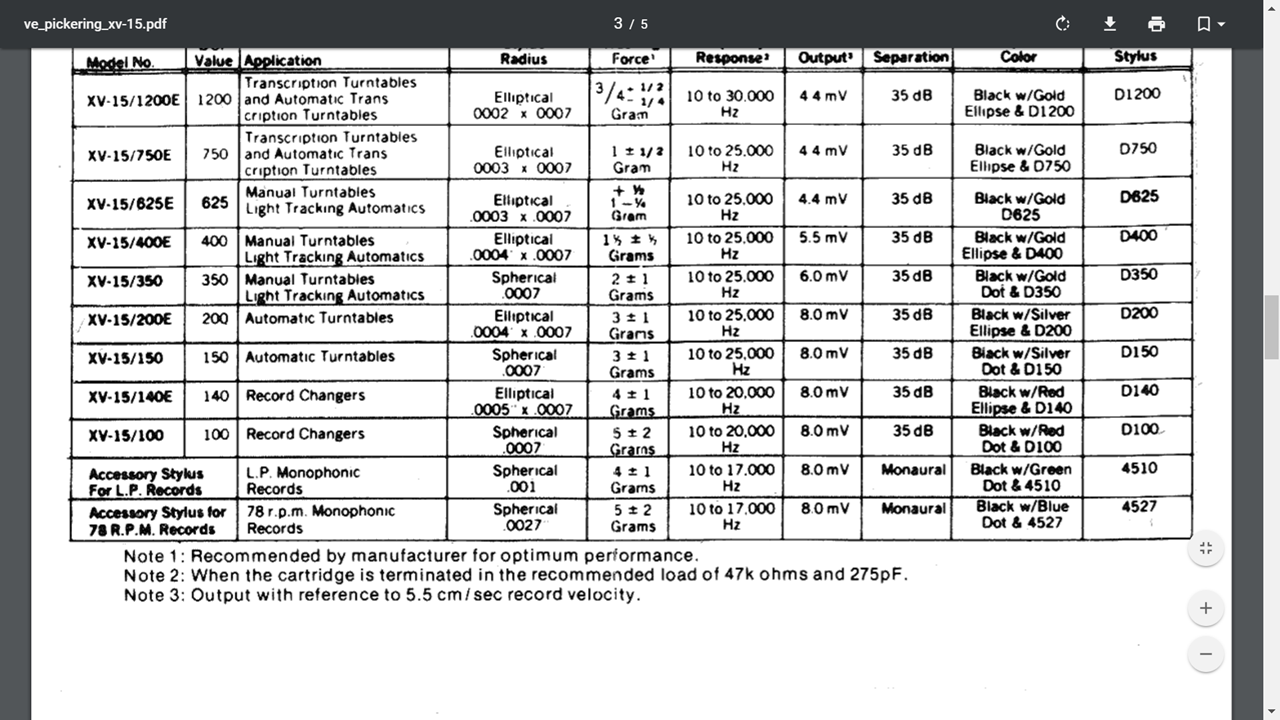

    OK, VE does indeed have the manual and - if you didn't have this info - here's the scoop on allowing for the brush :)
    add one gram to the nominal VTF setting to allow for the brush :)
    And the "optimal" VTF for the XV-15 625E?
    It's a little tricky to interpret :/ I am guessing that "1 - 1/4 + 1/2 g" means the range is 0.75 to 1.5 grams -- plus 1 gram to allow for the brush. In other words, I'd suggest setting the VTF (after balancing the arm) at 2.5 grams and see how she does :)
