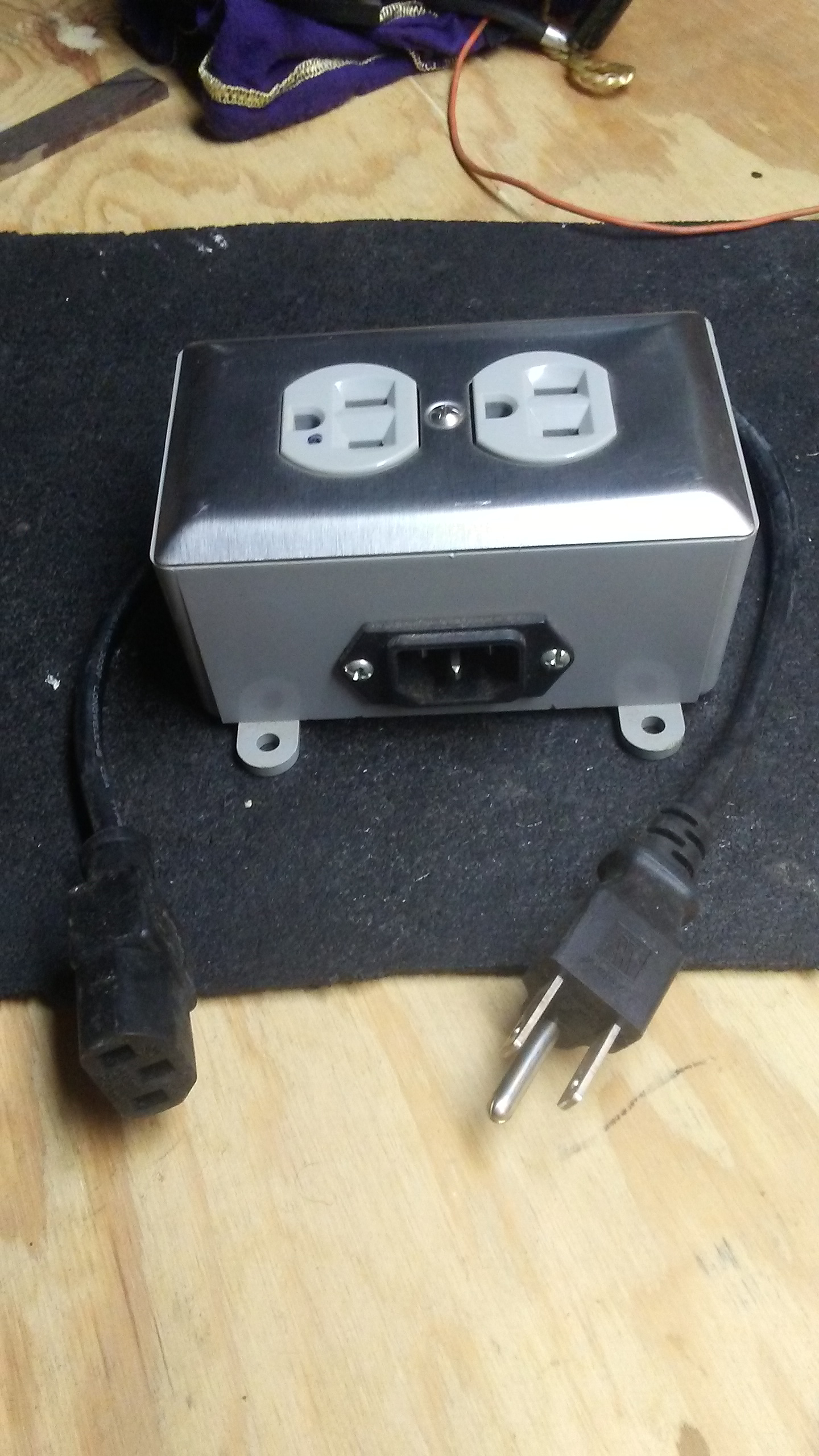

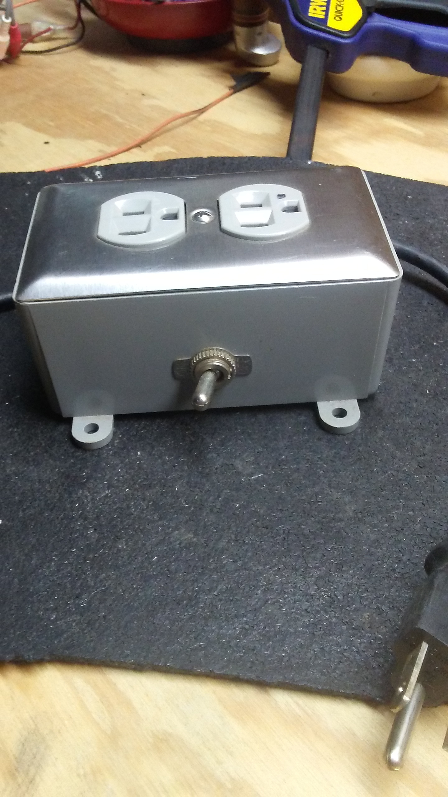

Smallest Dimb Bulb Tester on Earth....
$50 shipped to the Lower 48 states.
Perfect working condition.
Smallest Ive ever seen.
IEC input on back.
On/Off switch on front.
Power cable included.

    It's an adorbs little DBT (sometimes known as the "poor man's Variac"). These can come in very handy for those folks who stumble across, say, a Marantz 8B that hasn't been turned on on five decades -- it can help make sure that magic smoke Saul packed inside of it stays where it belongs, instead of escaping in to the cold, hard reality of 2017 ;)
    https://antiqueradio.org/dimbulb.htm

    Employing a DBT is a gentle way to wake up a piece of vintage electronic equipment, and/or a safe way to probe for severe faults (e.g., shorted power transformer primary or secondary winding, HV rectifier or filter capacitors) in delicate equipment. These are extremely handy for vacuum tube components (amplifiers, etc.), be they hifi, musical instrument/PA, or (heh) even televisions.
    I think the link I posted should explain the proper use of one. One needs a smattering of incandescent light bulbs. Since they're in series, if the component under test is drawing too much current, it'll light the bulb (which serves to limit juice getting to the component). If the components' in good working order, the bulb will glow faintly or not at all. The wattage of the bulb (i.e., the series resistance of the filament) can serve to limit the voltage to the component under test (even if all is well), thus allowing a controlled "fire up" of a long-dormant component.
    Many folks would use a Variac (variable autoformer) for this, but the DBT is a simple, inexpensive (and quantized) way to accomplish more or less the same thing.
