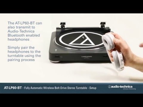

Some Audio-Technica tables have built in preamps. What's the model number of your turntable? If it has a built in pre, you simply need to switch it on and you're ready to rock & roll.
lmay23, if this is your turntable, watch this video. It will walk you through on how to set it up correctly with it's built in preamp.
https://www.youtube.com/watch?v=rOMI4gVE1i0
