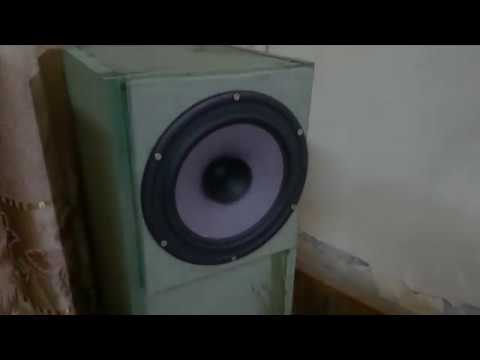

    Sounds like your getting it worked out and it is turning into a super cool DIY project. Have fun with it B)
    I did a backwards load horn speaker with a full range 6 1/2 driver that has front port without a crossover made it a lot easier.
