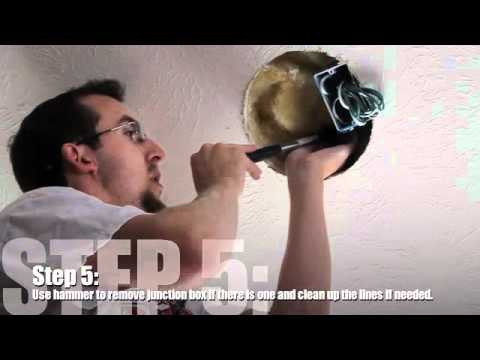

This is pretty old but here goes. My primary job was as an alarm installer both burglar and fire systems. Remember this was the 80s when the housing boom and condo mania hit big. Now my boss decides he wants to be a Bose distributor. Bose had their family room Lifestyle #30 and #50 systems and were fine for H/T family room use. They also made 3 room amplifiers that looked like car amps not to be seen but hung in basements or closets and iirc can have 3 rooms and a sub connected to this. We mainly used their high hat style of speakers, their volume controls and all had to be home runned back to the amp. There were input plates that also used Bose 8 wire w/ a ground wire in it. The high hats came in 2 types 1 you had to use ONLY Bose gear and the other was and they looked the same you could hook-up to any amp/receiver you wanted. If the areas are separated then 2 sets of hi-hats would be needed and also volume controls should be in the equation. I'm not sure if Bose even makes these things any more but we did install them for back ground music and it was not audiophile anything.
as for your #4 speakers go to the volume controls then a run to the amp if not using all Bose gear. I could not find what the amp looks like but they still make hi-hat speakers that are very different than the ones I used. Here's a tutorial on cutting out for ceiling speakers. Looks like it was pre-wired and put in boxes may be for code ,we did not. We had Bose made templates for pre-wire applications and also half moon jobs for non prewired houses that had set springs to pull the speakers up and hold them tight fit after your hole was cut hopefully not bigger than the speaker.
https://www.youtube.com/watch?v=IT0T3Ke-7eo 2chl- Adcom GFA- 555-Onkyo P-3150v pre/amp- JVC-QL-A200 tt- Denon 1940 ci cdp- Adcom GFS-6 -Modded '87 SDA 2Bs - Dynamat Ext.- BH-5- X-Overs VR-3, RDO-194 tweeters, Larry's Rings, Speakon/Neutrik I/C- Cherry stain tops Advent Maestros,Ohm model E
