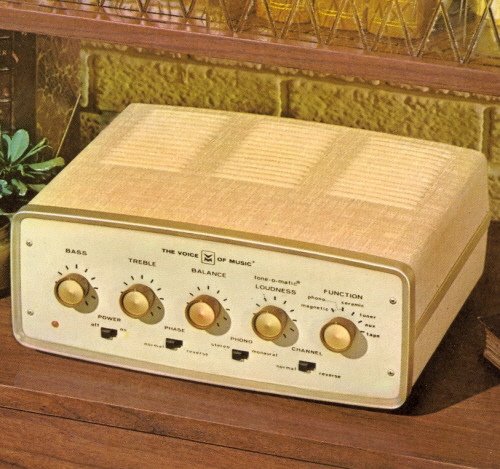

    tonyb....the VOM is good old American tube gear so not sure why you thought it was Chinese.

    Not sure why you invoked "cheaper Chinese tube gear" in the context of this thread Voice of Music (VM) hardware was made in Michigan. I suspect he's conflating 'warm' bass with 'deep' bass... but I dunno.
    I've never been too crazy about Adcom amplifiers (or preamps for that matter)... but the VM amplifiers were pretty generic examples from their time. Not bad, but not exceptional, either.
    http://www.thevoiceofmusic.com/
    I reckon the OP's reference is to the little EL84 pp stereo integrated that VM made.

    actually my post refers to this one :)...93v2gwxnssnf.jpg

    My bad, I had Music Angel on the brain, lol Time to change the caps in my head huh.
