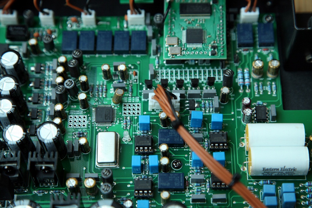

I was until after the Backert Labs Rhumba 1.1 demo to put the Dexa discrete Op-amps in the Eastern Electric Mini Max Plus Dac. Really seems to have stepped it up quite a bit in the transparency, detail and clarity department.
There are a pair of coupling caps that couple the op-amps with the tube output that are most likely Bennic (Eastern Electric branded) or other lower end poly caps.
The value is 3.3uF 100v. In talking with Rich (Scompracer) he did some calculations with the impedance of my pre amp and said I didn't really need to stick with that value, I could easily go higher, etc. Haven't decided yet if I'm going to leave the stock value or go higher.
I have the cap choice brands narrowed down a bit (I haven't checked to see if size will be an issue).
Any help from people that have used any of these caps, discuss.

FYI white caps on the lower right side is what I want to upgrade."Appreciation of audio is a completely subjective human experience. Measurements can provide a measure of insight, but are no substitute for human judgment. Why are we looking to reduce a subjective experience to objective criteria anyway? The subtleties of music and audio reproduction are for those who appreciate it. Differentiation by numbers is for those who do not".--Nelson Pass Pass Labs XA25 | EE Avant Pre | EE Mini Max Supreme DAC | MIT Shotgun S1 | Puritan Audio PSM136 Pwr Condtioner & Classic PC's | Legend L600 | Roon Nucleus 1 w/LPS - Tubes add soul!
V Cap has a coupling cap calculator with explanation guide for use. Of course the ideal coupling cap is no coupling cap, but when you have to, use the lowest value you can get away with.

Thanks Rich and Jesse for the input. I keep thinking Obligatto but many reviewers say they are a tad warm. I think because I have tubes in the dac and tubes in the pre, I am looking for something a tad on the neutral lively side.
The Jupiter's look fantastic, but not sure it makes sense to spend $400 on caps for this unit. The op-amps alone set me back a bit. Trying to keep it in perspective and not go way off the deep end, but still enjoy a serious upgrade in sound.
The Jupiter HT line looks very nice too, perhaps even a better choice than the Jantzen Superior Z or Mundorf Supreme. Sonicraft has then on sale for $47 each. That's doable.
