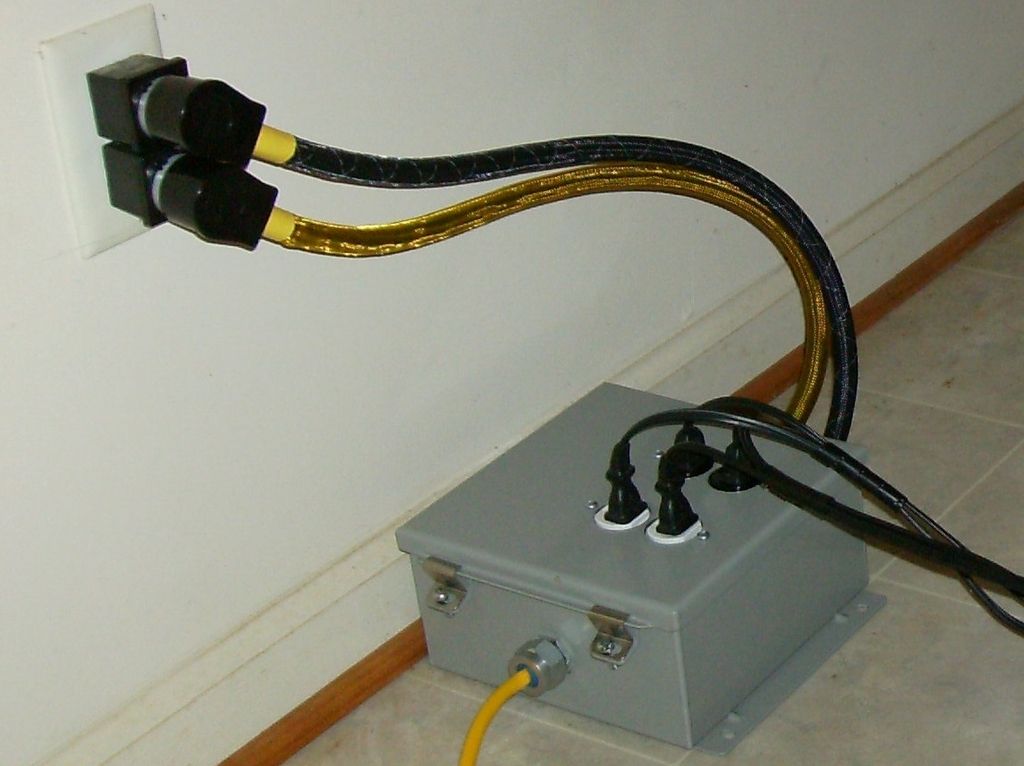

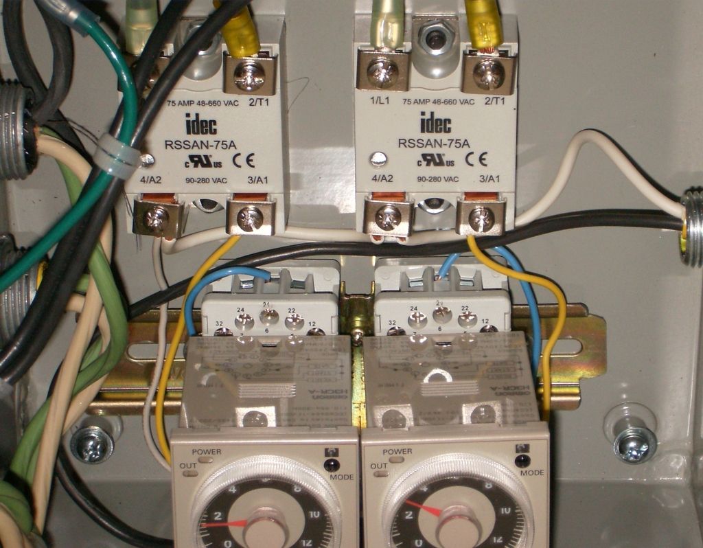

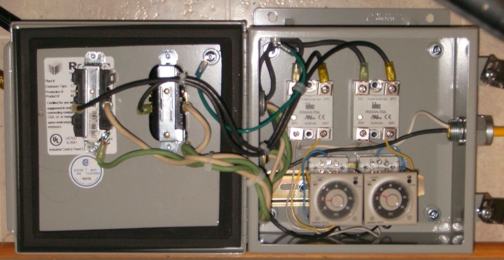

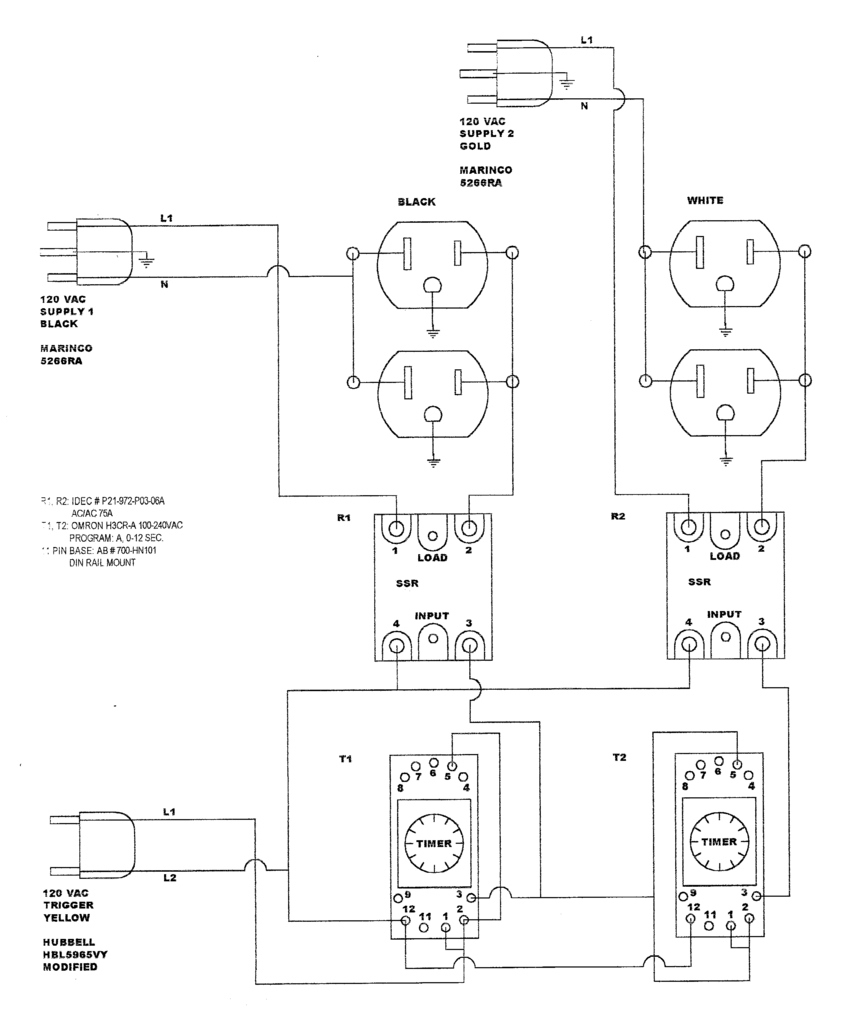

    On my main system I use a 4 stage Furman PS-8R Series II sequencer to power up my preamp (stage 1), crossover and tube gear (stage 2), sources (stage 3), and a home made remote 2 circuit/2 stage amp sequencer (stage 4). Now one switch turns on everything and 2 switches shut everything down (in reverse order).
    Here is a schematic and some pix of the amp sequencer:
