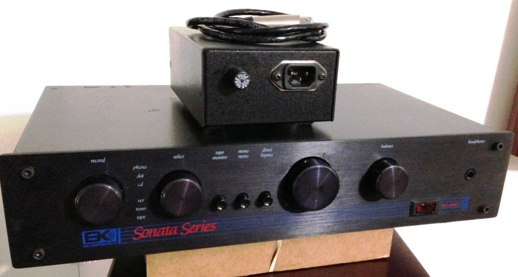

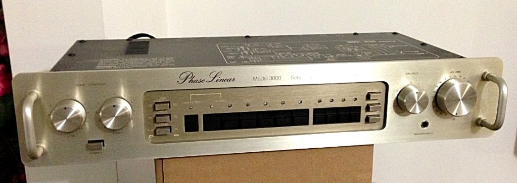

  • Glen B
    Glen B Posts: 269
    tonyb wrote: »
    Agreed, some A/V pre'pro's make excellent 2 channel pre's. B&k...Anthem...Arcam...Outlaw...Cary...Classe, just to name a few and can usually be had used for under 400. Except the Cary, lol.
    Pick up a B&k REF 30 pre....under 200 bucks used and you'll forget all about the Rotel.
    +1. Classe SSP-25 can be found for around $400.00. Among 2-channel preamps, the B&K PRO-10MC Sonata and MC-101 Sonata can both be found for about $300-$350. I have owned both models. The Phase Linear CC-3000 Series 2 is also a preamp that is a true sleeper that I have had in my equipment collection and highly recommend.
    PRO10MC_01.jpg~original
    PL-3000II_01.jpg~original
