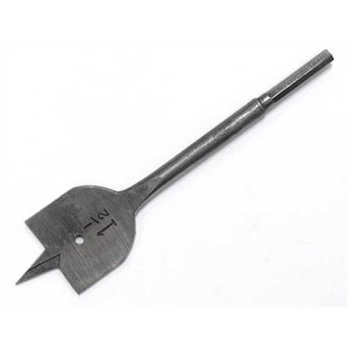

    I was just thinking to use one of these to run a series of holes down the side and then cover with material...
