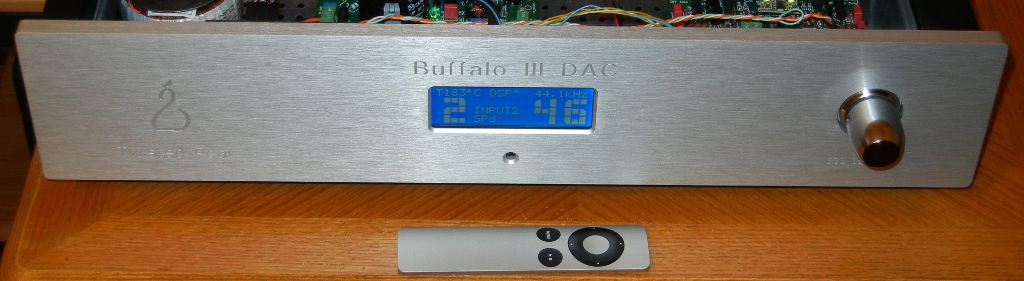

After being stuck in customs for two days, I finally received my second HiFi2000 enclosure from Italy. I guess metal enclosure for an electronic device of my choice raises suspicion. :0 Probably got me on a watch list. They tell me they had classification issues with it.
HiFi2000 tells me they switched to FedEx for shipping as they will be cheaper than UPS. Waiting to see if I get an import duty invoice. I don't do a lot of international, but my experience has been UPS will automatically charge import duty on everything with seven days to pay or they start tacking on interest. With FedEx it has been sometimes I get a duty charge with international.
This is a HiFi2000 2U metal enclosure with fully vented top cover, 10mm aluminum font panel. Front and back panel machining by their modushop, anodize after machine. Finally the single BIII DAC will have a worthy enclosure. I've got some friends that want to demo it, but unsure it will make it past the first.....these DAC's sound that good.
This is a single BIII DAC with Legato output board. Shunting power supplies for DAC and output board. Cheating with a wall wart for the Arduino/LCD display. The Legato I/V board sports discrete balanced output, SE output and headphone out. It will also have Arduino serial control with modified HiFiDuino code by Corpius. It will be controlled by a manual encoder or Apple remote. Input wise I'm thinking USB to I2S and a coax S/PDIF. One fellow asked for Bluetooth input but I don't think I can pull that off.

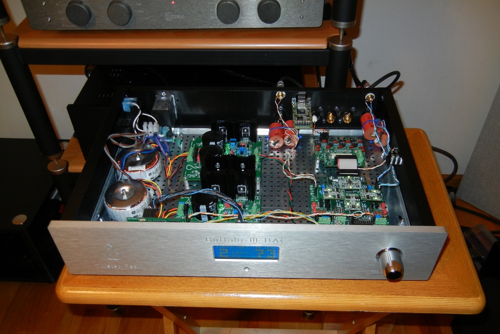

    Found a round tuit. Still need to connect USB to I2S/DSD and connect two more inputs but it does S/PDIF mighty fine! Remote control, discrete balanced output, SE and headphone out. Then off to Carl and Mike for trial. Ed says he wants Bluetooth input so he has to wait....lol These are much simpler to build. No more dual mono builds!
    Some extra room in this for future USB boards that may be larger and maybe another power supply.
    A couple of improvements I make to the HiFi2000 chassis are slightly longer M4 bolts and nylon lock nuts to secure floor to side panels. I also like to stud mount the front panel as it is much easier to start and tighten a nut than insert and tighten a screw with the innards populated.
    I cheated and used a wall wart PS for the Arduino/LCD display and no noise or buzz so it will stay. In my dual mono I used a linear power supply for the Arduino/LCD. IEC has filter built in along with switch, fuse.

    I just had to do a few holes for the Arduino/IR receiver.

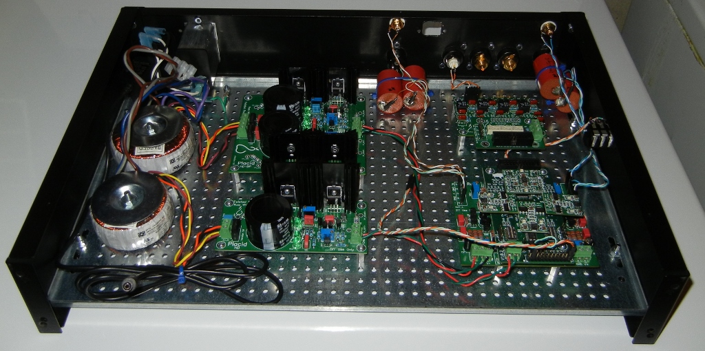

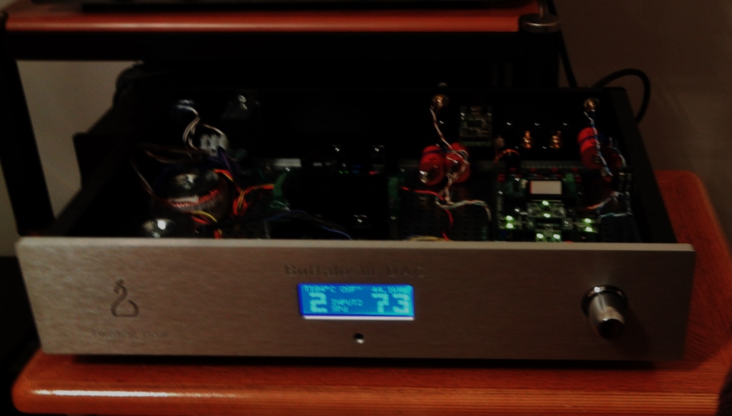

    SCompRacer Posts: 9,090
    edited March 2014
    My round tuit isn't as hi-tech....
    It's a wrap. I get by with a little help from my friends...thanks to Fred for the ready built Salas PS. It powers the Sidecar switching board, input board and USB module.
    Using Dynamicaps as AC couplers due to the common mode DC with the Legato I/V output board. Common mode is DC between balanced + and balanced ground, balanced - and balanced ground. Not all amps can handle common mode DC. Over the years I have measured gear for common mode DC and found it is not uncommon.;)

    Thanks Greg! This will travel to Carl and then Mike. Ed has heard my dual mono DAC but would like Bluetooth input added. That's beyond my capability right now. Russ at Twisted Pear is messing with Raspberry Pi now and mentioned Bluetooth so maybe he will come up with an offering like that someday.
    This Pesante 2U chassis with 10mm front panel was ~220 euro or $306US. Shipping is high, ~$70US. They use FedEx now. Before it was UPS. Shipping was cheaper with UPS until you got the import duty invoice with two weeks to pay before they start tacking on interest. Options were fully vented top cover, anti-vibration feet, drilled inner base, knob, both sides machined, holes drilled and tapped for LED display and anodized after machining. Front Panel Express doesn't do both sides machined or anodize after machine. Both sides machine is like 60euro or $84US.
    If using an OLED display, they are like 1/8" thinner so no need to go as deep with display cavity on rear of front panel. Robert (Corpius) of CE -Designs is working on an improved controller and code that will work with an OLED display. Currently the code doesn't support the Arduino/CE-Designs shield when using OLED displays. I'll have to make a thin filler (like hard foam) for mine when the OLED display is installed to take up the small gap.
    Doing the deep cavity for the IR receiver makes for excellent off axis remote operation.
