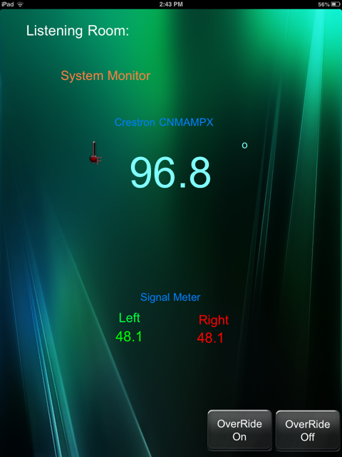

    I made this interface for the Amp just now. I cant put the amp into over ride, check the temp, and see the signal meter for left and right. I can do faults too but I dont need it.
