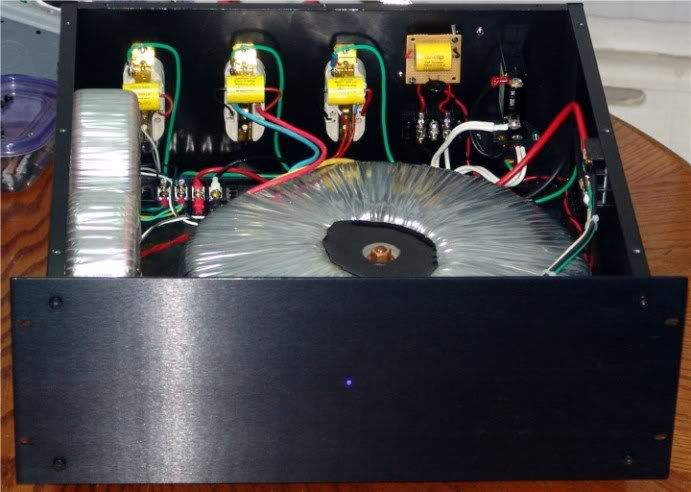

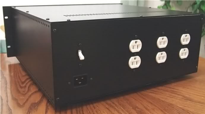

I have a DU-3 that I've been running my power amp off and it has produced very good results. It's easy to hear the bump in clarity and smoothness compared to plugging the power amp directly into the wall. I've been thinking for a while of getting a larger tranny as the 1500 watts the DU-3 is rated for when wired in balanced mode might not provide enough juice during transients and peaks. Haven't particularly noticed this, but then I came across a DU-5 for a very good price so I pulled the trigger.

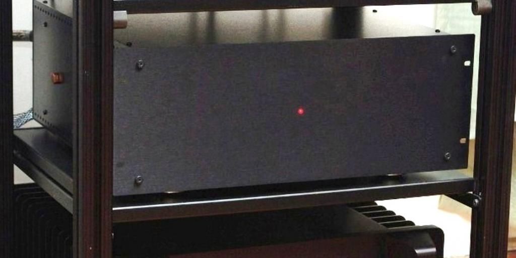

Pics below are wiring it and setting it up. The sucker weighs 90 lbs by itself so I mounted it on a piece of cabinet grade plywood with casters on the bottom. Makes it much easier to slide into the cabinet.

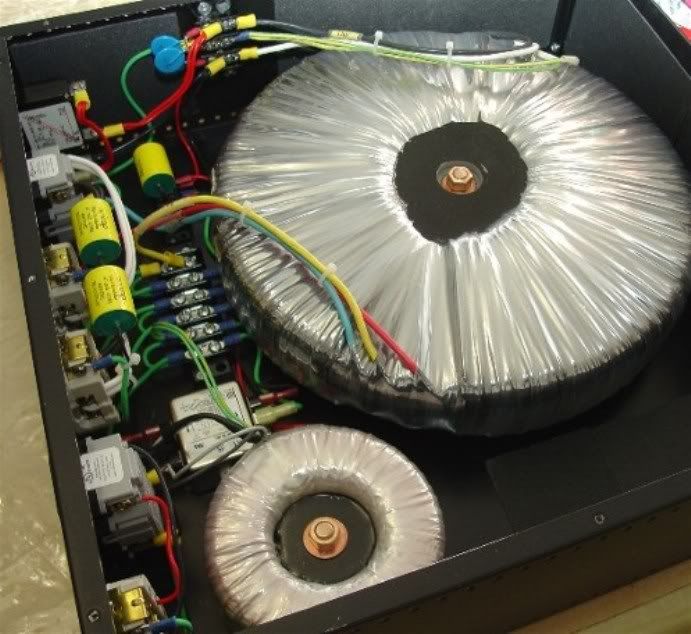

    I have been doing something similar for the past 9 years, but with toroids. Apart from reduction of an already low system noise floor to vanishing, noted benefits include greater transparency and detail, and increased low frequency weight and extension.
    I believe that ancillary parts make a difference. Internal wiring is OCC silver and copper, outlets are Oyaide R-1, IEC power inlet is 20A Furutech gold, all hardware is non-ferrous, including bronze transformer mounting bolts, and breaker is Carlingswitch hydraulic/magnetic.
