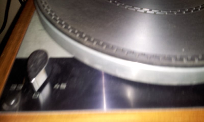

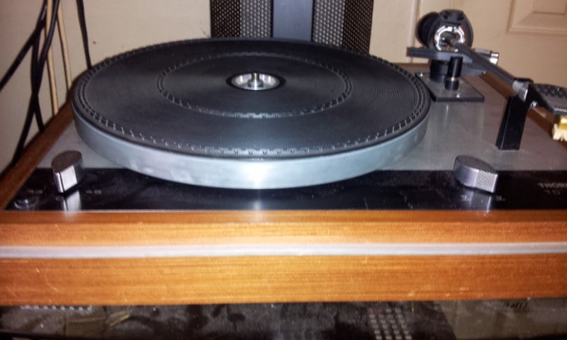

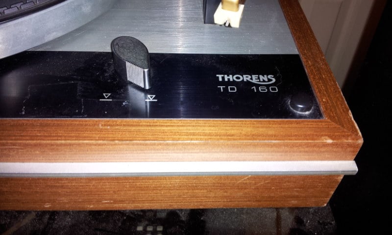

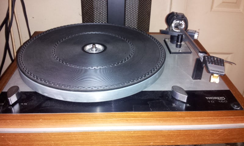

Just aquired a Thornes TD160 TT with a pickering XV 15/625e cart. Will br scoping the stylus tomorrow, and letting my tech have a go at it too restore and clean it all up.will be replacing wiring with new and gold rca jacks at rear so I can use upgraded ic to my pre.other than the usuall things, belt, motor mounts tonearm rewire, motor cap replacement, any suggustions as to things too do?
