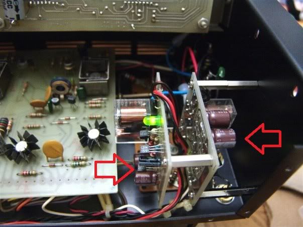

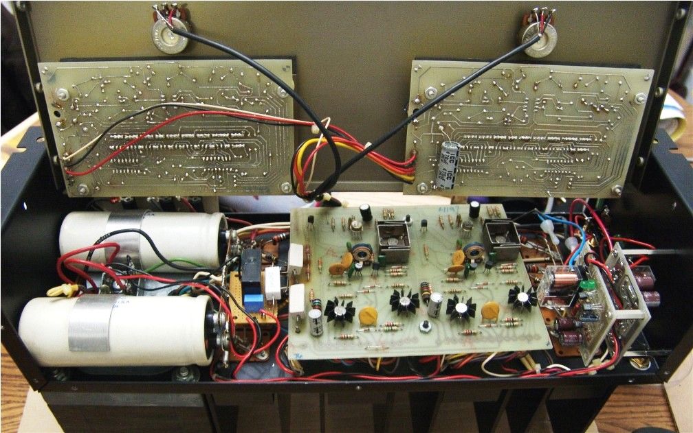

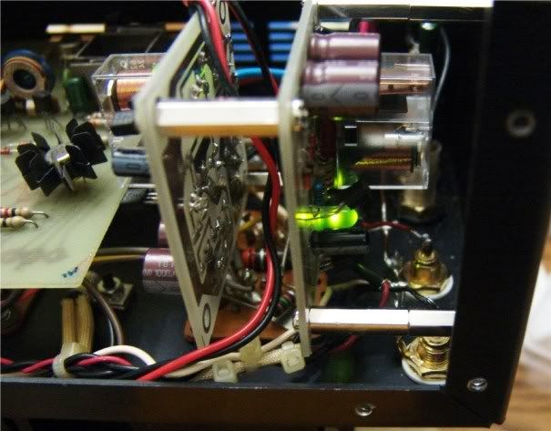

    Can it be added inside or something external like in-line fuse work?
    DC protection circuitry/output relays can be added in an amp if there is room, but that is a job for an experienced DIYer. You can mount the protection circuitry it in an external box connected between the amp and speakers. Here is a protection kit that has a built-in power supply: http://www.parts-express.com/velleman-k4700u-2-channel-loudspeaker-protection-kit--320-264?utm_source=google&utm_medium=cpc&utm_campaign=pla. You just need to connect it to the AC mains, which can be accomplished somewhere after the amplifier power switch.
    Here is my Phase Linear 400 Series 2 in which I installed DC protection. I mounted the two single-channel boards back-to-back on the side wall of the chassis (on the far right). I obtained operating power for the circuit directly off the main power supply, through a voltage divider network (tiny board between the big caps and main board). I am preparing to install protection circuitry in an Acurus A250 I bought recently.
    PL400-2_09_zps5a473ad2.jpg~original
    PL400-2_11.jpg~original
    PL400-2_10.jpg~original
