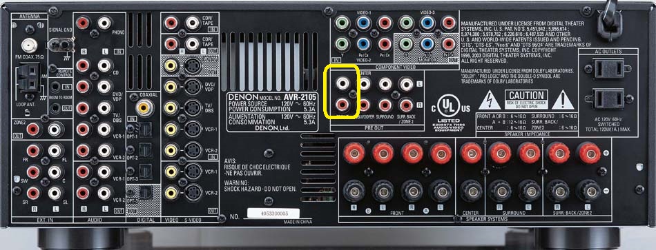

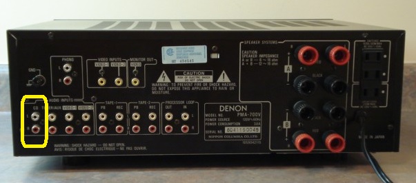

    You can take the Pre out from your 2105 and go into one of the four audio inputs on your PMA-700V. You will be able to control volume from the 2105's remote.
    Here are some pics
