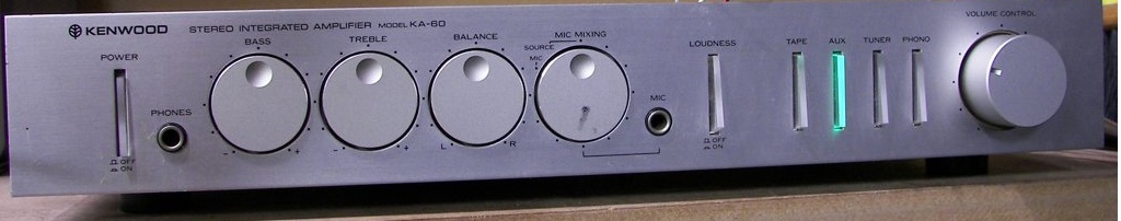

Was it common for amps around 1980 to be made without a mid control, just bass and treble?
I am expecting a Kenwood KA-60 (1980-82) next week which does not have a mid control:
Post edited by joho1701 on
    mhardy6647 Posts: 35,388
    edited March 2013
    Midrange adjustments weren't common in the 1970s (although they weren't unknown, either). That KA-60 is at the bottom end of Kenwood's product line at the time and is a bare-bones piece of hardware by the standards of the time.
    Tone controls, as far as I am concerned, generally do more harm than good. None in my hifi... but that's another story, and it's the answer to a question you didn't ask! :-)
    edited March 2013
    That was fairly common, yes! But many integrateds had cut-offs for Bass and Treble that gave more equalization flexibility. My Pioneer has Bass (200 and 400 HZ turnover control) and a Treble (2000 and 4000hz turnover)--that was also pretty common.
    I wouldn't worry about it. Because my Nakamichi Pre-amp has ABSOLUTELY no TONE controls of any kind (same with my tube integrated) and that is often best!

    In my experience, preamps and integrateds with midrange controls were the exception rather than norm. As a percentage of units with tone controls, IMO they are in the minority. More popular were controls with selectable turnover ranges, as mentioned above.
