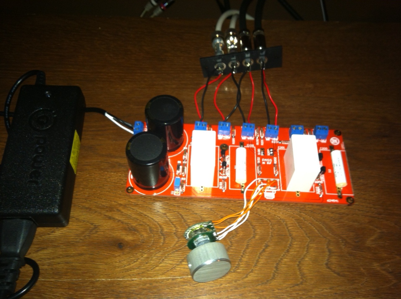

    Got the populated B1 board last night and it looks good. Seller included a 25K, SMD resistor based stepped attenuator which looks pretty decent; I'm really not liking wiper pots these days, even decent ones like the ALPS blue. The down side is the board DOES NOT fit in my Axiom II passive preamp, so I'll have to mock-up something until I decide what my final installation will be.
    I picked up a laptop power supply for cheap online; rated at 19V and 4A. When I was testing it last night, I realized it's some proprietary HP DC plug where the outer ring is ground, inter ring is 19V, and pin is 18V. I think I'll just have to cut the plug off, and use the 19V lead and ground, which shouldn't be a problem; I'll just heatshrink the third 18V lead.
  • zingo
    zingo Posts: 11,258
    edited February 2013
    The buffer installed in it's old enclosure:

    Last night, had the time to cut and dissect the power cord from my laptop power supply that I picked up for a few dollars. It has three wires in it; thick black, thick white, and thin white. Making an educated guess, I stripped both thick wires, and sure enough had 19.5v capable of 4A. Now I just need a interim enclosure to mount it all in, and I'll be able to compare the B1 to a completely resistive passive preamp in my system.
  • zingo
    zingo Posts: 11,258
    My test last night and everything sounded good! However, I'm surprised that I only need a few clicks of the attenuator to reach a comfortable listening volume; the voltage sensitivity of the Martin Logan Puritys is starting to bother me a little... The good news is the SMD stepped attenuator currently being used has very good stereo tracking and balance at low level, so I am happy running the B1 "low" if that is the reality. I'll be mounting the B1 in some sheet metal in the next few days until I can get a good enclosure.
    B1.jpg 323.1K
