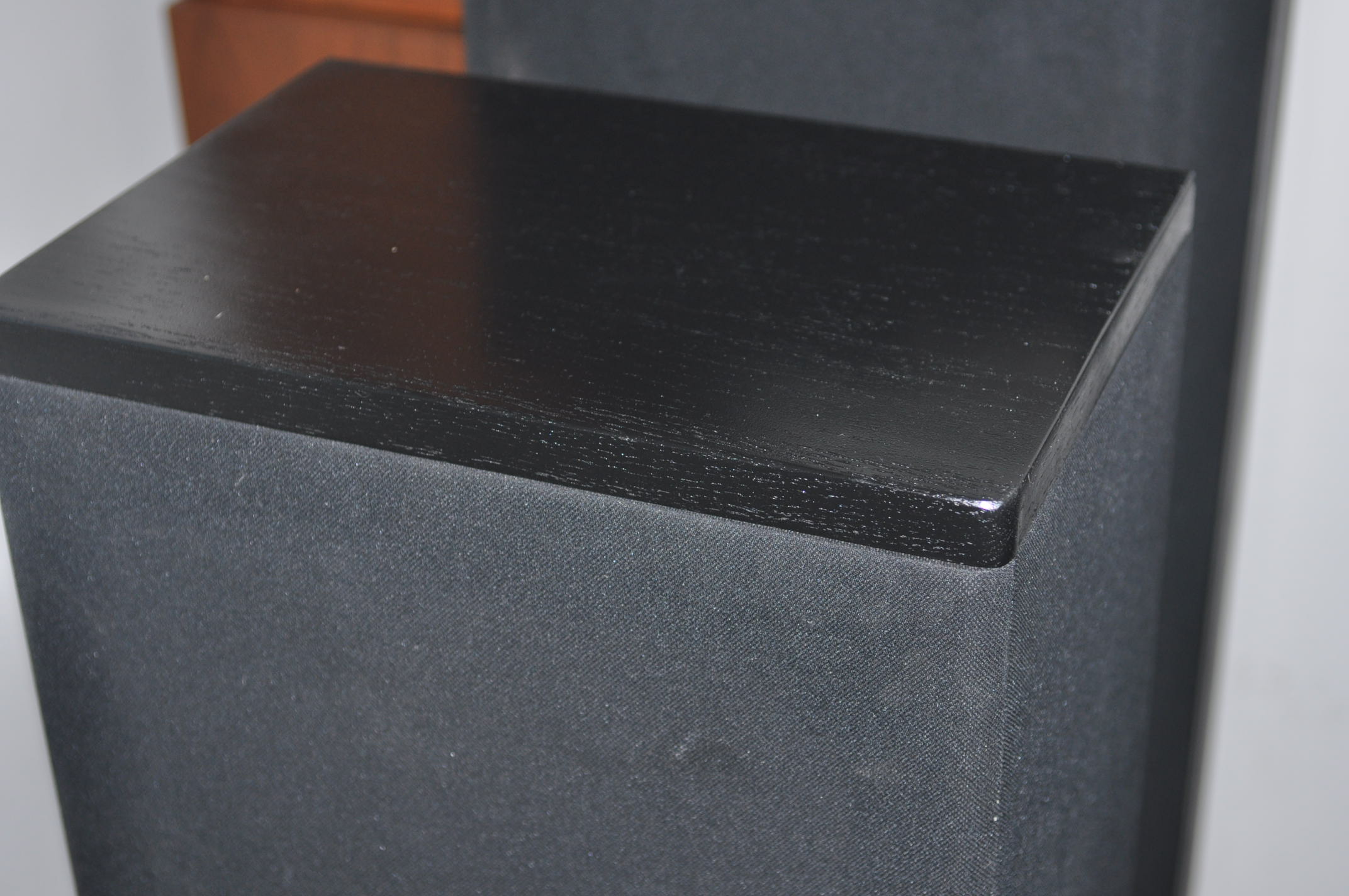

Update - SDA 2b’s top cap redone.
larbor
larbor Posts: 10
edited February 2013 in Vintage Speakers
Just an update … some before and after pictures. I tried to match the original stain to the new veneer but couldn’t, so I just decided to paint them black. Overall, it wasn’t too hard to re-veneer the top. I also put new cloth sides on one speaker (that was actually harder to do than the veneer)

    Nice job on the end cap.

    Also, very nice job on the paint for the end caps.

    Great job. It all depends on room size for sure, I had the 2B's and now own the 1B's and night and day better for my room are the 1B's, and the 3.1's didn't sound as clear as my 1B's in the same room. Room size does make a difference!

    Nice job on the end cap! It looks very nice!
