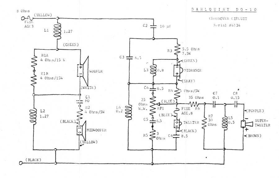

I was considering recapping a pair of Dahlquist DQ 10s I bought a few months ago as I have heard that recapping the crossovers dramatically improves the sound. However, when I called a very reputable (and highly recommended) repair tech to see how much it would cost to do the recapping, the repair tech told me not to waste my money because recapping was all "psycho-acoustics" and would have no effect at all on the sound. He said that the capacitors are merely like traffic lights directing traffic and that they all do the same thing. He told me he is an engineer, and while he would gladly do the service for me and take my money if I really wanted to go ahead with the recapping, he said he honestly could tell me to save my money as recapping would have no effect on the sound or performance on my DQ 10s.
I have heard so many things to the contrary that I was taken aback and now am left not knowing what to think.
What has been your experience with recapping? Does it dramatically improve sound and performance of speakers?
Thanks.
