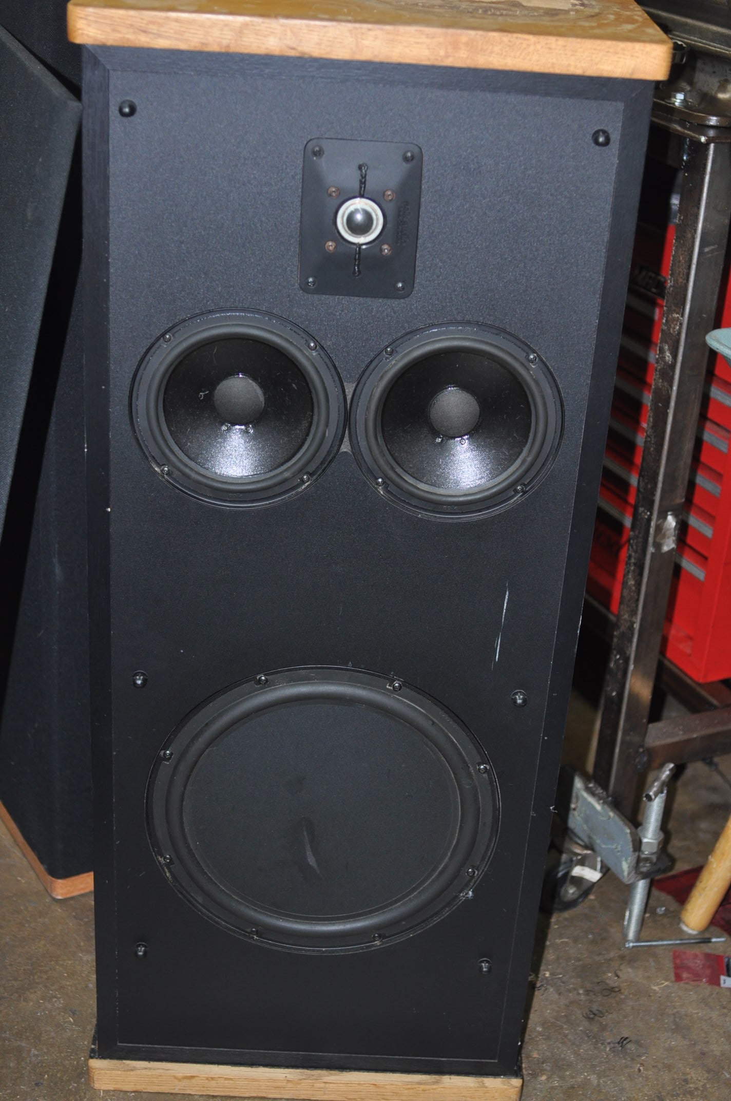

Hi,
I just picked up some Sda 2b?s really cheap. They need some cosmetic work, but all the drivers are there and they appear to be in good shape. I have some 3.1tl?s that I?ve been upgrading, but the 2b's were too good to pass up.

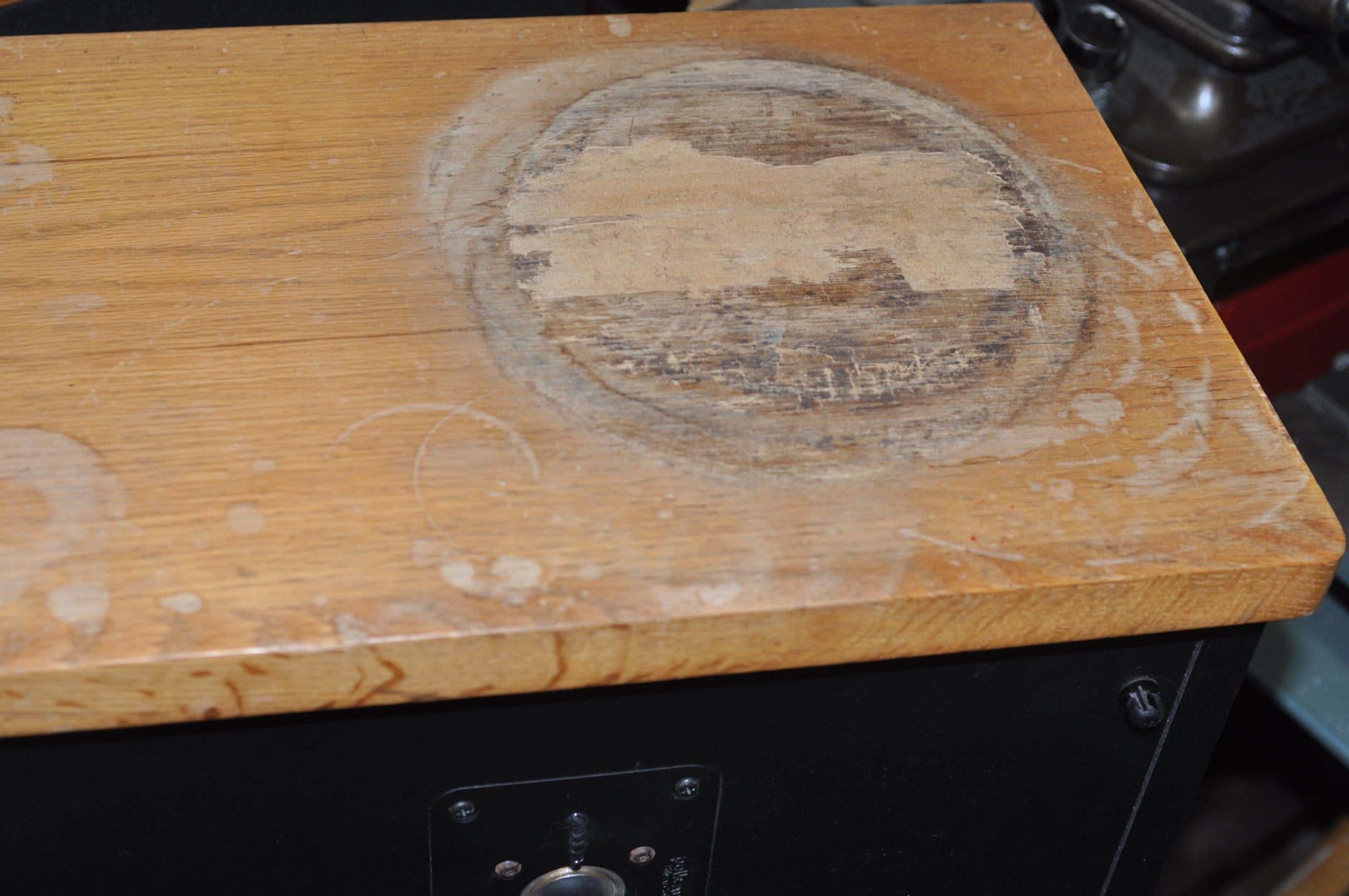

Cosmetically one speaker needs a new top cap and side panels (missing). The other speaker is in pretty good shape. How hard is it to remover the top cap (might go with new veneer if it's hard to remove)? The side panels look pretty easy to redo. I just need to find the right covering material to match the other speaker. I'm also thinking of just using wood side panels (both speakers). Has anyone done this and how does it look?
The speakers have a blade/blade interconnect but the crossover board is a single board. I?m assuming it's fairly easy to do the "tl? upgrade because I have the single xover board(??). When you do this upgrade, does your interconnect plug change to a pin/blade configuration. I looked at the inside plug and I see only one wire connected to the top blade. The other blade was not connected. I didn?t do a detail inspection and maybe the other wire fell off. The owner never had or used a interconnect cable.
I?m going to start getting the cabinets in shape before I do any upgrading.
I posted some pictures.
Thanks.

PolkieMan did some terrific work on his SDA 1C caps that had some water ring damage - don't know if it was anywhere near as bad as what you have there - so, you could check with him, or pull up some of his posts where he's posted some pics.

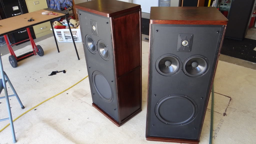

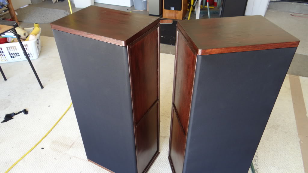

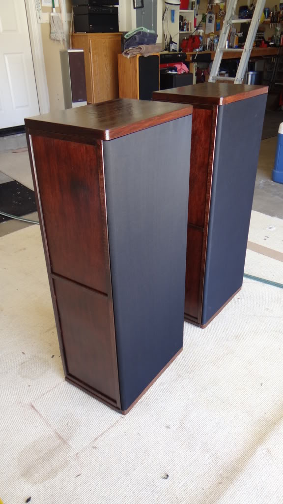

Also, regarding doing the sides in wood, here's some pics of someone's done that way - not mine, they were ones done by a recent eBay seller.

I think the tops are glued on and will probably vary from piece to piece on difficulty of removal.
Yes, you will have only one wire hooked up for the SDA connection. On previous B/B connections, both blades carry a signal. With the single board 2B's and CRS, only one blade does. Then they converted all to Pin/Blade connection.

I've asked about removing the tops and bottoms of these and have been told that you need a crowbar type tool it as they are glued and stapled down. I still might remove and refinish them and find a better way to secure them back on like the higher end models.
With regard to finishing the sides like the originals, I would think you would need to redo both speakers with all new grill cloth so that they matched correctly. Or, you could do like teekay0007 pointed out and finish the sides with wood. I always wondered if that would somehow affect their sonic signature - did Polk put speaker cloth on all sides of the SDAs for some reason or was it just to cut costs. Can't answer that one, but I'm sure someone can. They look nice with the wood sides though, however I think I'll keep mine stock in that regard.
That damaged end cap is too far gone to repair. Time for new veneer. They are stapled and glued on. You will need a thin edged tool and start prying from the back edge.The side panels look pretty easy to redo. I just need to find the right covering material to match the other speaker.
Nothing out there is an exact match, so you'll have to do all sides and fronts to get a match.I'm also thinking of just using wood side panels (both speakers). Has anyone done this and how does it look?
Every one that I've seen looks like dog poo. Don't do it.Political Correctness'.........defined
President of Club Polk -
Yea mine wasn't nearly that bad, it looks like it is past the veneer into the particle board if not then a lot of sanding is needed .
I bet the bottom cap looks better than the top. Switch them out?teekay0007 wrote: »PolkieMan did some terrific work on his SDA 1C caps that had some water ring damage - don't know if it was anywhere near as bad as what you have there - so, you could check with him, or pull up some of his posts where he's posted some pics.
