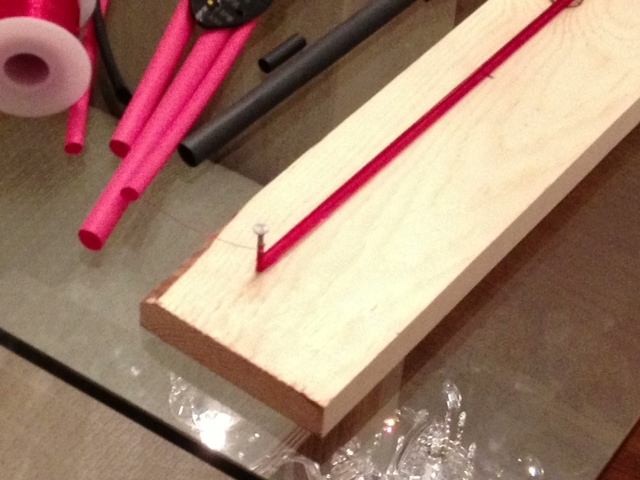

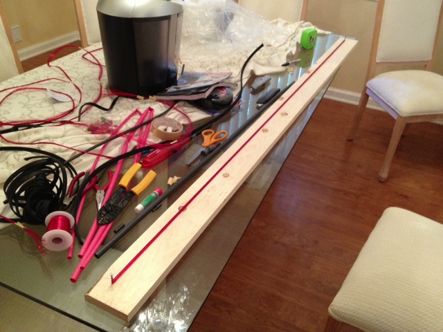

    I am making a pair of 6 ft speaker cables using 30awg enameled insulated solid copper core magnet wire. Right now, each cable has 48 strands and to be truthful, it was a real pain to make. I had to make a rig using a 6 ft plank with nails at each end. Run the copper wire back and forth for the 48 strands. Cut the wire and then strip the insulation off each strand. I want to make each lead 96 strands, but it is easier to make it into two 48 strand leads and combine them to make a 96 strand lead, or total 192 strands per cable.

    Here are a couple of pictures of my rig...
    I ran the cable along the board. I then wrapped small pieces of tape every foot or so to keep the strands from unraveling when I cut the wires. After cutting the wires, I fanned the ends out and used sandpaper to remove the enamel, a lot faster than using a knife. Could not find any wire strippers than could handle the enameled finish.
