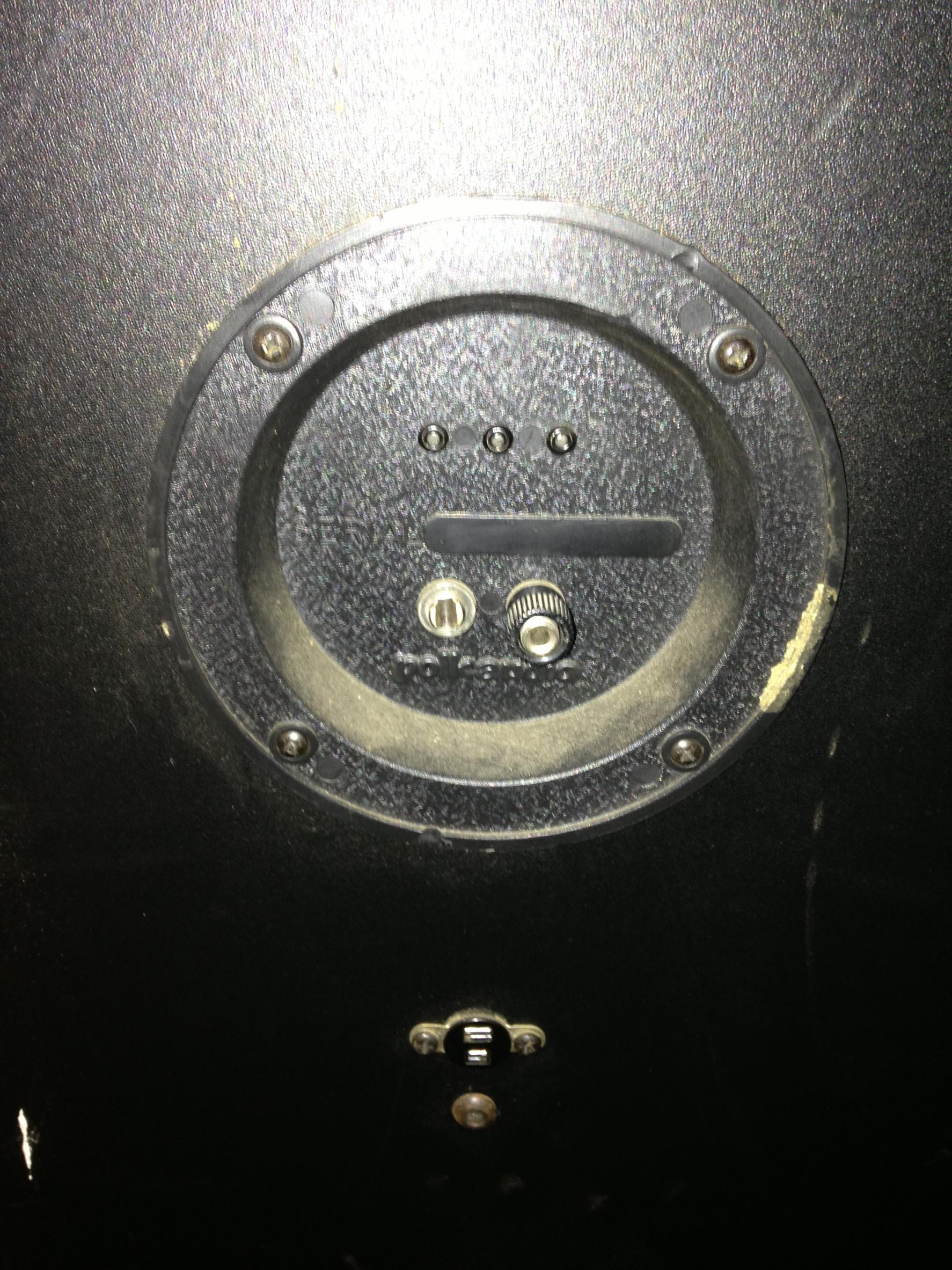

    The SDA-SRS2 you have are the first generation. The 3holes you speak of are where Polk had the fuse's prior to using poly switches which are on the board itself. You can call Polk audio and they will make a blade/blade IC for you. If you're interested I have one I made with better cable. The cable itself is 13' long originally they were 20'.
    The second generation SRS2 had the pin/blade and the ability to bi-amp or bi-wire so hence the 4 binding post. Both are very good BUT different in the approach that Polk took in the maturity of the SDA line.
    If you have quality amplification and know its limits you can remove the poly switch and either use a jumper or a .5ohm 12watt mills resistor. If you plan on using a receiver to drive these I'd suggest you replace the poly switch with a new one. The poly switch does wear out and sounds like it may have been tripped a lot do to the description you gave.

    Pitdogg... ahhh, holes for fuses, that makes sense. And I figured it might be a Gen1 vs other issue is why mine look a little different (2 post vs 4) than what's shown online. Thanks!

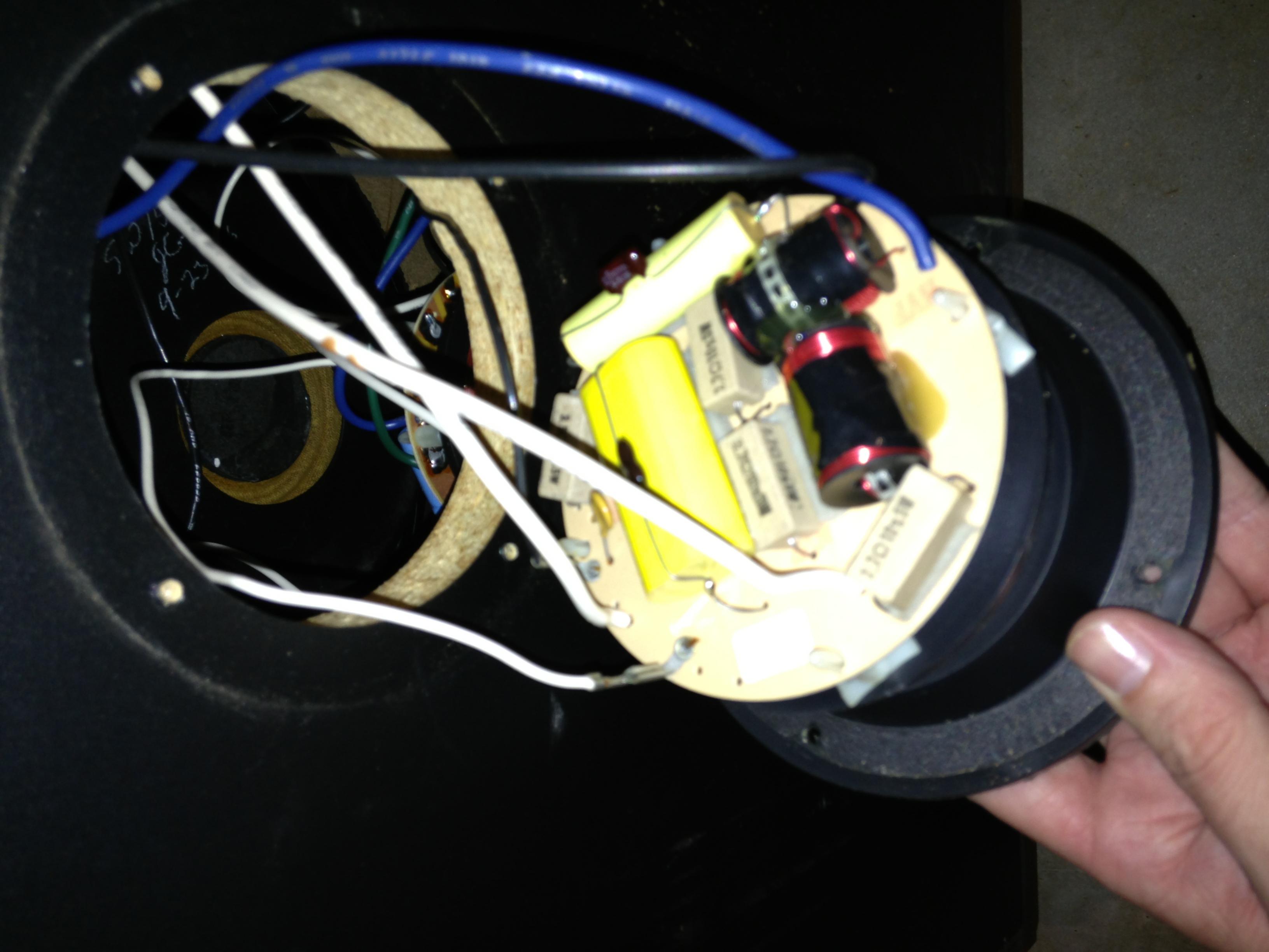

    here they are. Not so bad on the inside. Components all seem fine. If you don't look at the tops, sides, backs or bottoms, and if you take off the fronts, these are just fine. I've removed the top 2 drivers to get to the nuts securing the really bad cupped and split top cap.

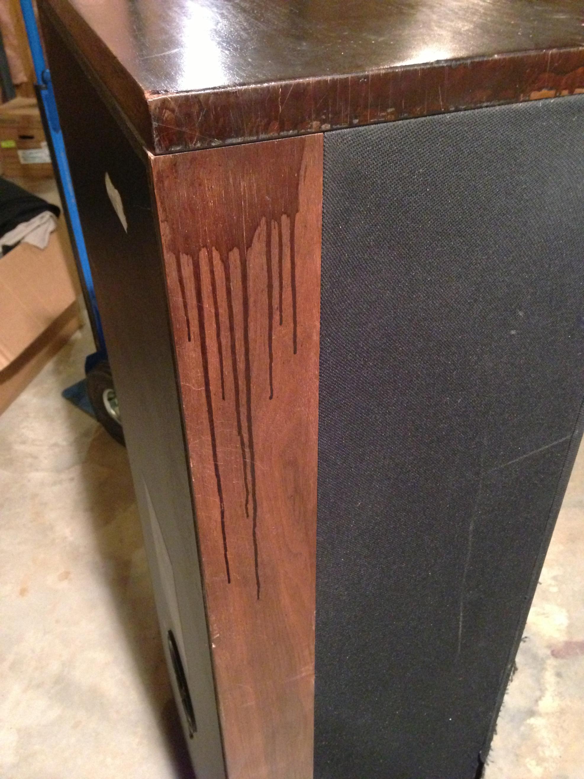

    Please, if you have a weak stomach, turn back now. If you might be uncomfortable seeing our Polks in distress, don't scroll down. For what is about to be seen, can't be unseen.
    And don't blame me for what you are about to see. Some previous evil owner tortured these SRS 2s and tried to drive all the amazing out of them. I'm going to try to resurrect them.
    Rated R for extreme violence and destruction....

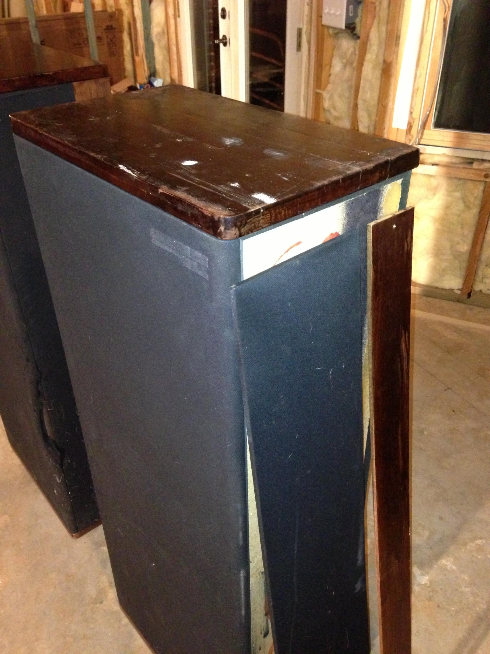

    Here we have the top plate which has been either restained, or painted, i can't tell which. And someone seems to have thrown in a handfull of junk out of the shop vac into the wet paint for good measure.
    and the view of the side showing that great stain job.

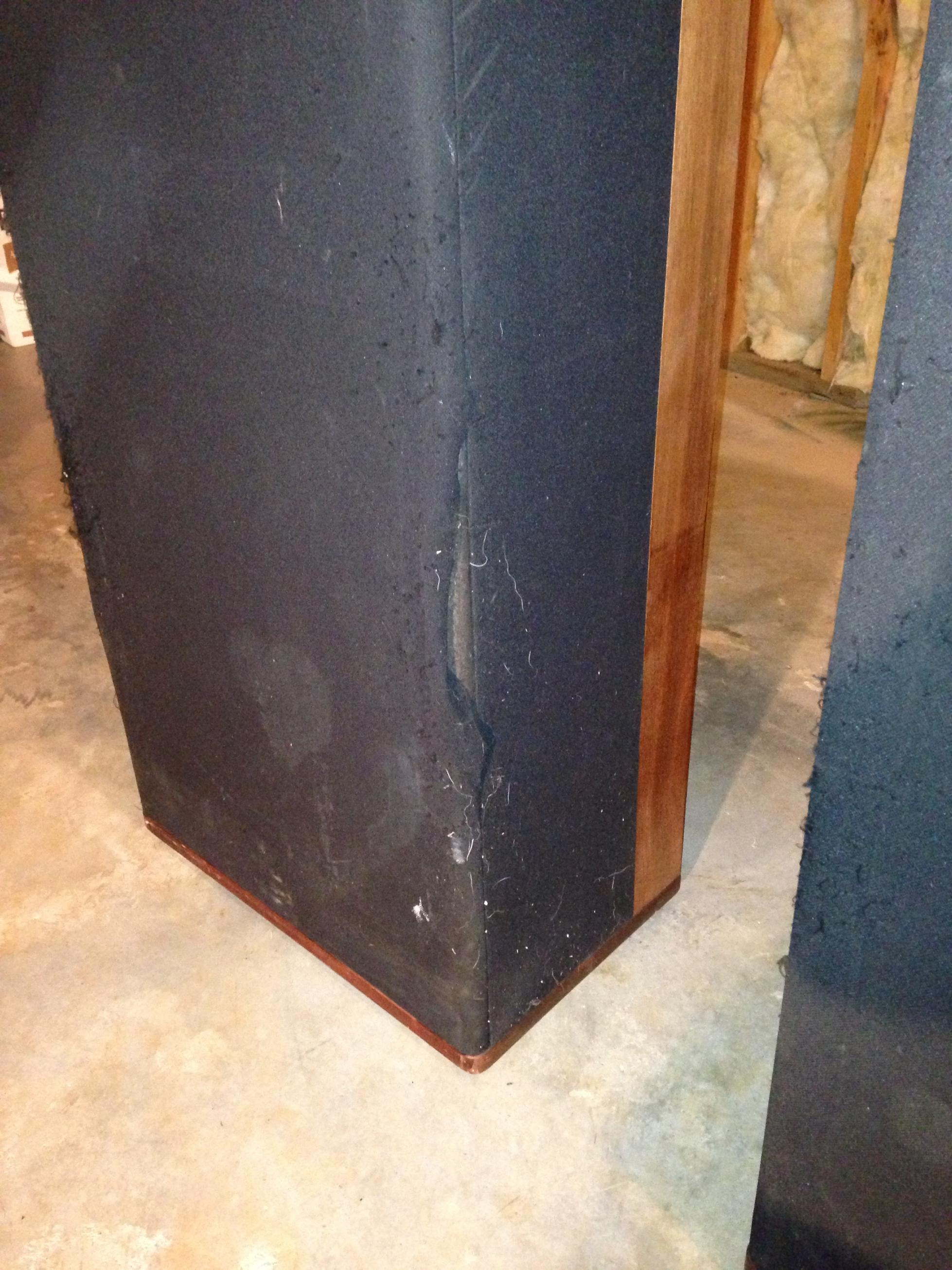

    I think the previous owner had a pet lynx or bobcat
    I had to remove 6 NAILS that had been added to hold on these side panels... nails!!!

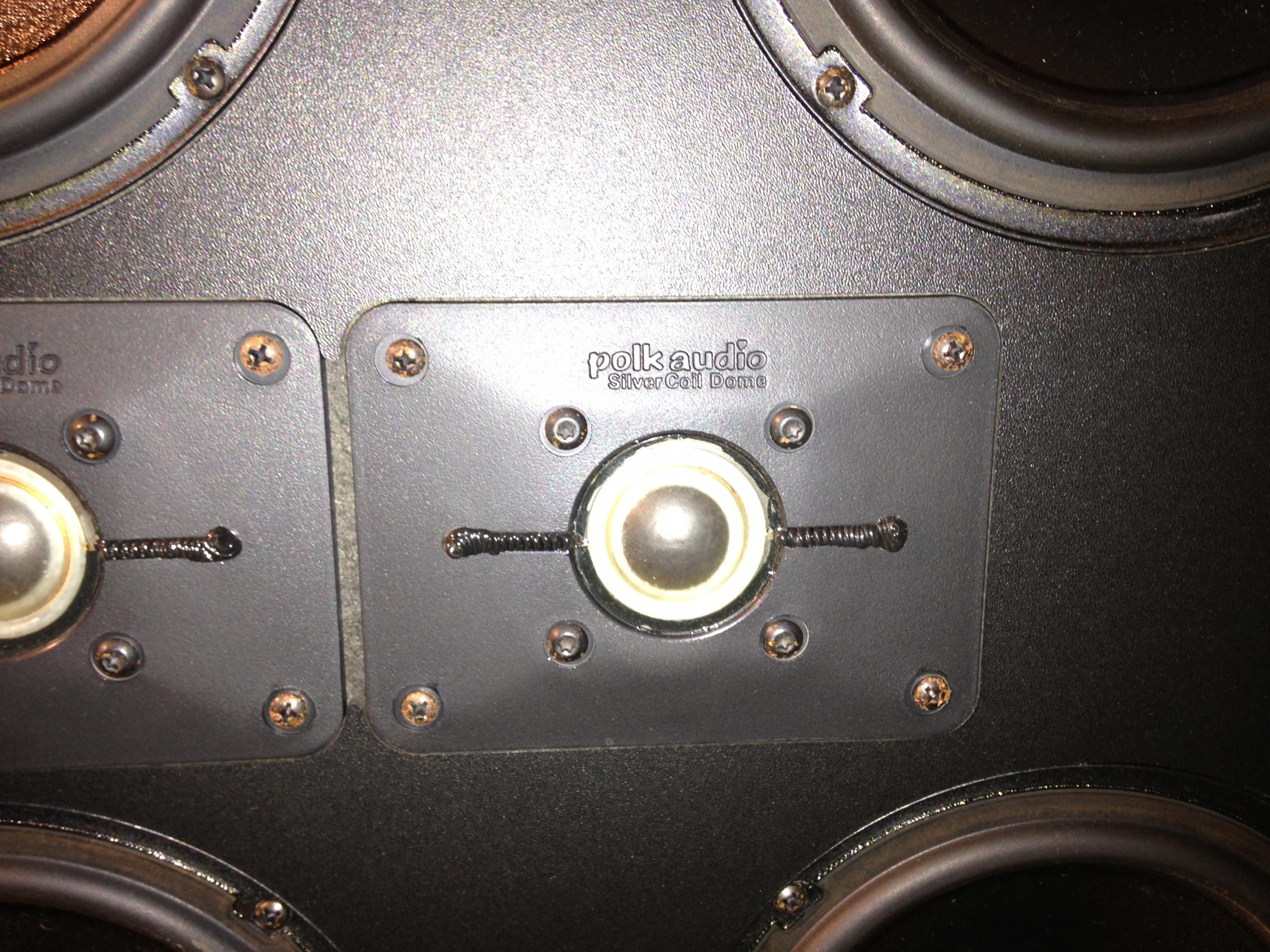

    i'm guessing the tweeters are original, but look ok.
    here's the connector cup, with a broken post

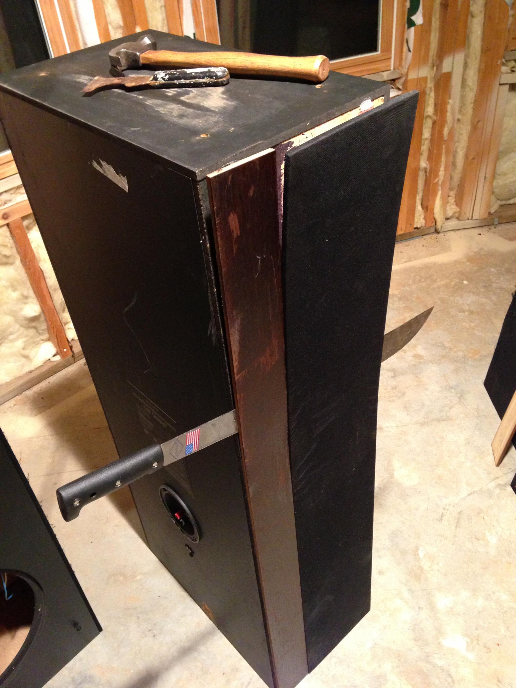

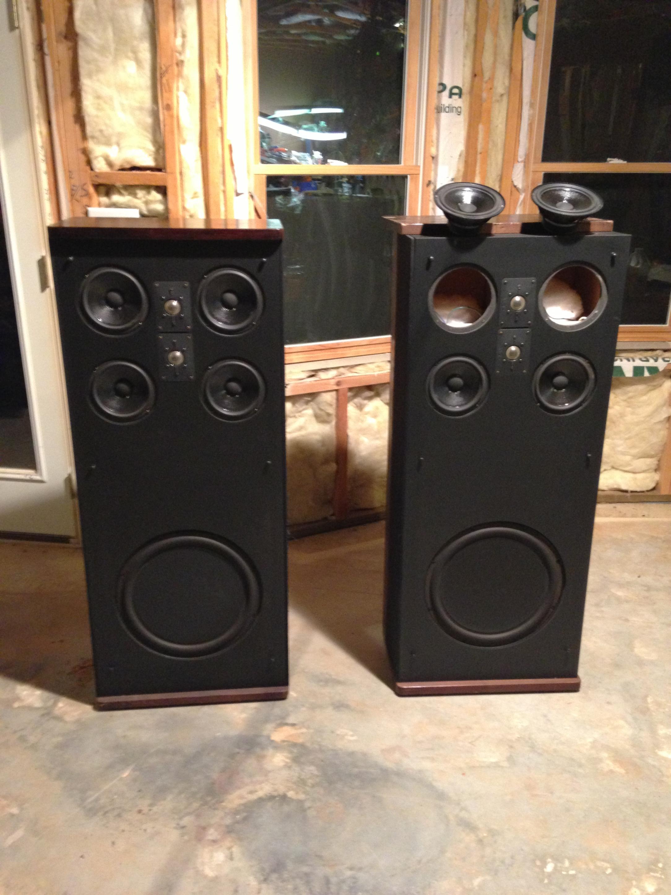

    Seriously, please go back if you aren't prepared for this. The dismantling began tonight.

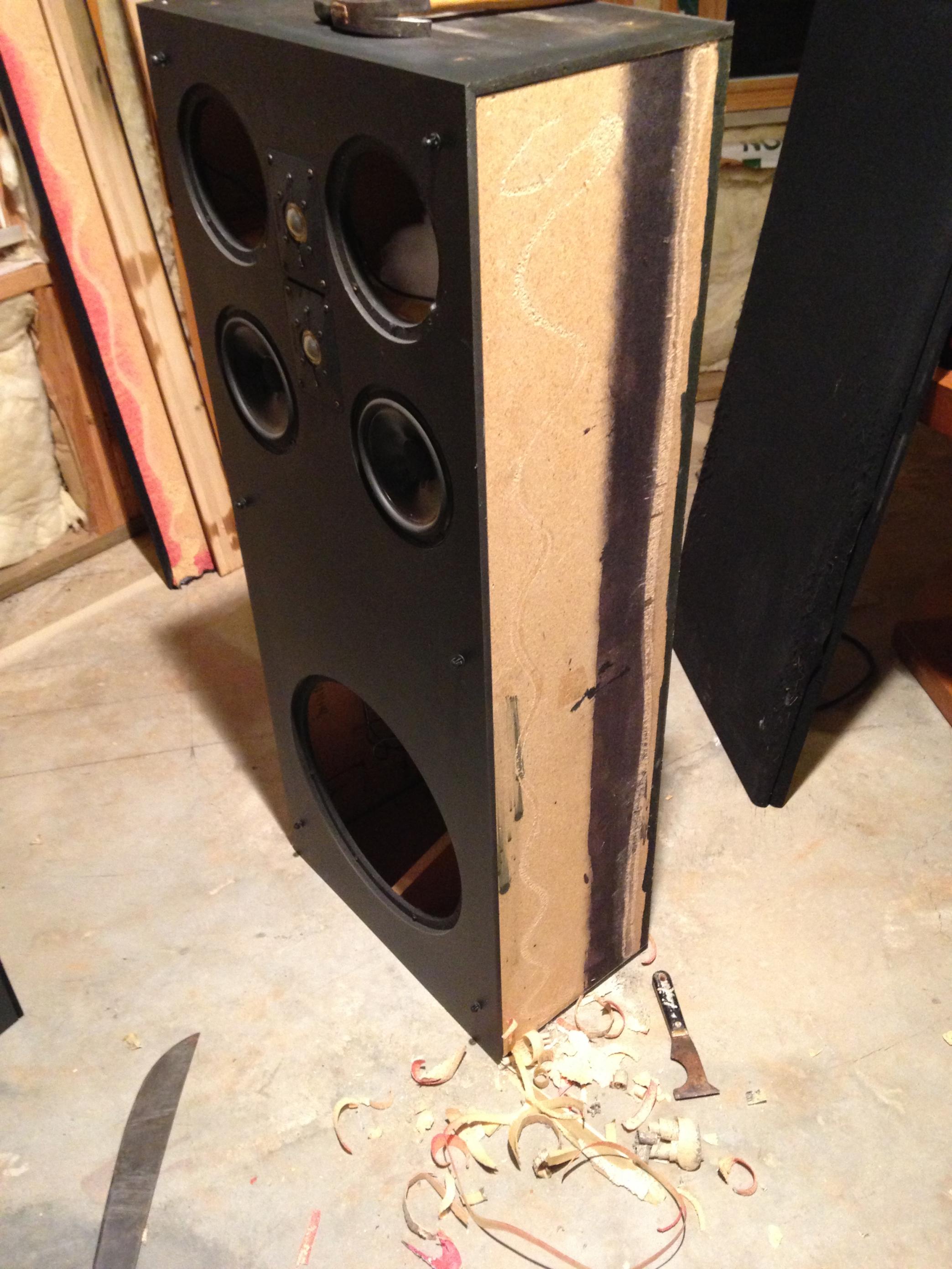

    Now remember that the these speakers have an "inner box" and the surfaces are all cosmetic. And my cosmetics were in dire shape. I say that because some of my tools were not really precise and....well, let's just say that most people probably don't work on their vintage Polk speakers with.... a machete.
    Its not too late to turn back.... OK, the side wood strips were trashed and the only way to fix them is to remove them. Same with the side panels that are fabric over pressboard. and the caps and bottoms. It all needs to come off. New fabric is on order and on its way.
    So, the side panels came off easy on one of the speakers. fell off one side after i removed the nails, and the other side just needed a little prompting.

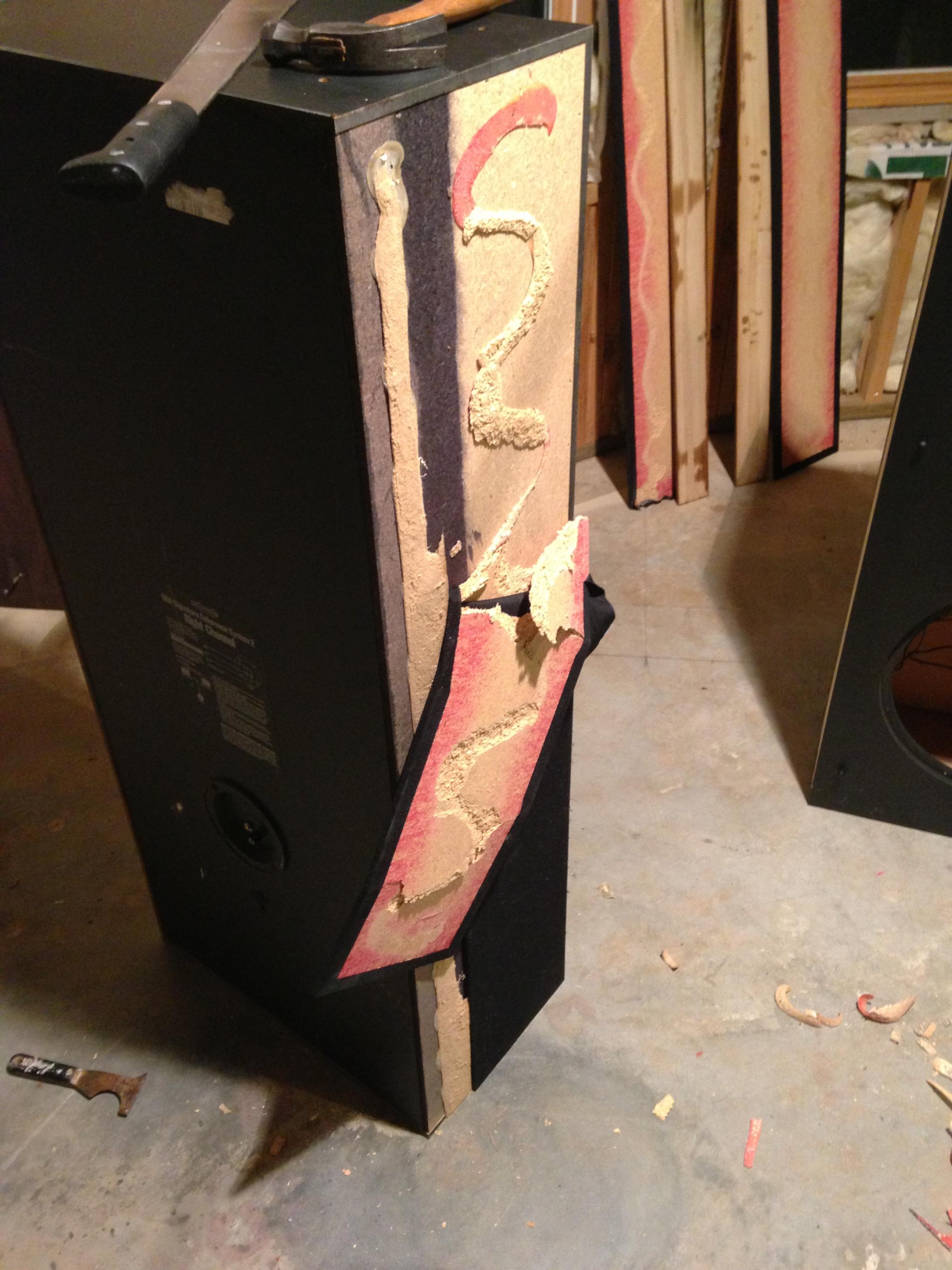

    Not so much on the second speaker... they must have used alot more glue. Had to get creative...
    And it didn't go so good.
    But this is just pressboard, and wrapped with fabric. So I'll just have to replace this pressboard, and wrap it in new fabric and reattach. Should be easy. What was the important part in this step was to remove the walnut (or oak?) strips in one piece. They came off easier and are fine.
    So now, over Thanksgiving... stripping (the stain/paint!) sanding, restaining, a little cutting new pressboard, new fabric, and reassemble.
    A question. What color to stain? Stick with classic original walnut? Looks kinda 80s. Go with a deeper more timeless color that's not original? Or... all my other wood audio gear is black. I would never paint these black... But what about a black stain? You'd still see the wood grain, and there would still be depth. But they would more match the rest of my gear. Is that blasphemy? Half of me thinks it would be. Weigh in and let me know. 1)Original walnut tung oiled? 2) stained a deeper warmer dark honey antique oak? Or 3) stain black and do a poly rub to give it a little sheen?
    Yeah, that was certainly the wrong tool for the job!

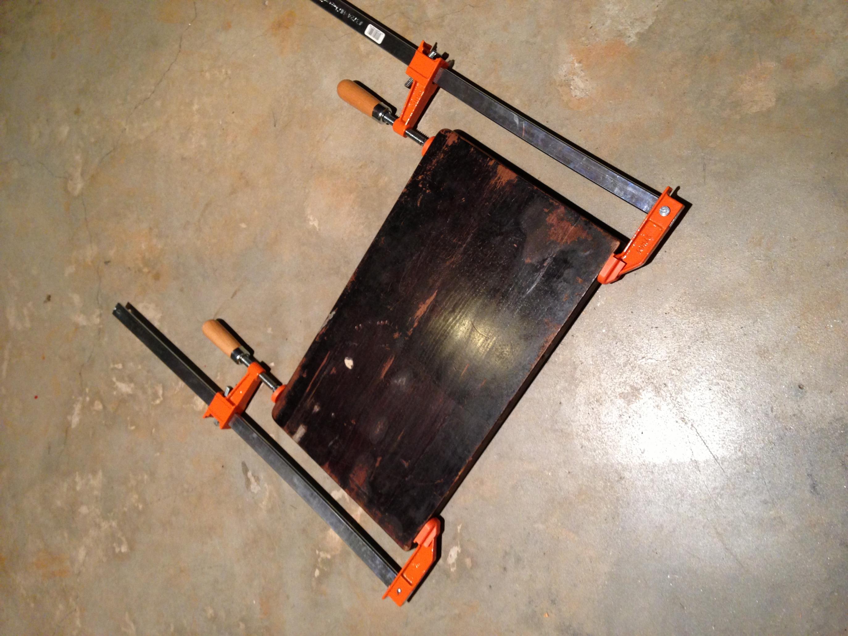

    So the really bad cap gets glued and clamped. It had splits in the wood and cupped warping. I think there was some minor moisture damage just on the top. You can make out some staining on the top of the inner cabinet, the black surface of one of them, with white powdery stains. Next will be planing the caps down about 1 mm. Gouges too deep to try to sand!

    F1nut...
    I think the machete, while unconventional... was the perfect tool. I needed something strong and thin, and sharp, that i could wedge between the "good side" speaker and the "bad side" thin particle board. I held one hand on the handle and bumped the other end of the blade down with a hammer, seperating the two. Its not like i was wailing on it like hacking through vines in the jungle. OK, it broke the particle board anyway, but anything would have, the glue bond was stronger than the particle board. Even before it broke, i had conceded that on this one speaker, i was going to have to replace the outer particle board. Noting that fabric was getting glued back over it and the whole thing was getting glued back to the cabinet wall, I didn't too much care. This just looked the easiest way to get it off, albeit sometimes in chunks.
    I agree with you that the sides all in wood wouldn't be a look I'd like. But I don't think all in fabric either. I think I'll stick with the original look here. But I'm still torn about stain color when I'm done.

    It's nice to see some one go head first into a project not knowing how much time it will take or how it will all work out.
    Go for it.
    By the way how old are you?
    Nice brand new clamps, but you really need two more on the piece you're gluing up.
    That's why veneered MDF is the better choice, something even Polk realized later on.
    Are you sure the side strips are walnut too?
    Yes, 100% sure.

  • proffitt
    proffitt Posts: 157
    edited November 2012
    My old clamps were just too large for my workbench and kept poking me in the ribs where they hung off. So i had to pick up some smaller new ones. I only got two because the splits in the wood only came in about three inches in from the side. I kept a good watch for any leveraged movement towards the center caused from clamping the ends, and was happy to see that the splits didn't lengthen from that counterforce. I had a plan for it if it had occurred.
    Even Polk thought to try to start with really nice Walnut before he got wise to MDF. I'm just getting started and i like the way the walnut looks, and way better than oak too, so I'm glad to know for sure that the side strips are certainly walnut. They'll stain similarly if that's what i decide to do with the color.
    If i stay with the original format, mostly fabric sides with the strips of walnut... any suggestions on stain color for wood? Original walnut, something warmer, or black stain?
  • evhudsons
    evhudsons Posts: 1,182
    my strips looked slightly different too but I assumed because it was veneer rather than solid wood. Personally I like my walnut and the solid wood. I understand the cracking, warping etc but It's nice to keep it stock unless the caps are broken. Darqueknight, and I think Lasareath took their oak or walnut off and replaced it with beautiful exotic wood. It looked breathtaking, but is an endeavor that for me would be down the road if at all. There's something about aged wood that seems just as refined and since I like the black walnut I'm sticking with it.
    there's a guy on ebay selling sda's which he put all wood on the sides, it looks bad so that answers my curiosity. But of course there are others that may love the look. It's really cool that you have such a beginning that you can do pretty much whatever you want with these and not be accused of ruining classic speakers.
    I know that mdf would be the better choice longterm if warranted but is it also because of the acoustics, or is it just the warping/cracking issues?
