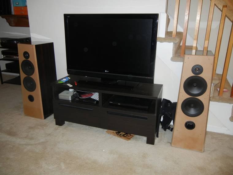

    I made the call to just peel it off completely rather than having it flapping in the breeze. Now, it looks like I built them myself. I think I like the idea of painting the flat or satin black. Any paint suggestions (type of paint, spray/brush, prime?)

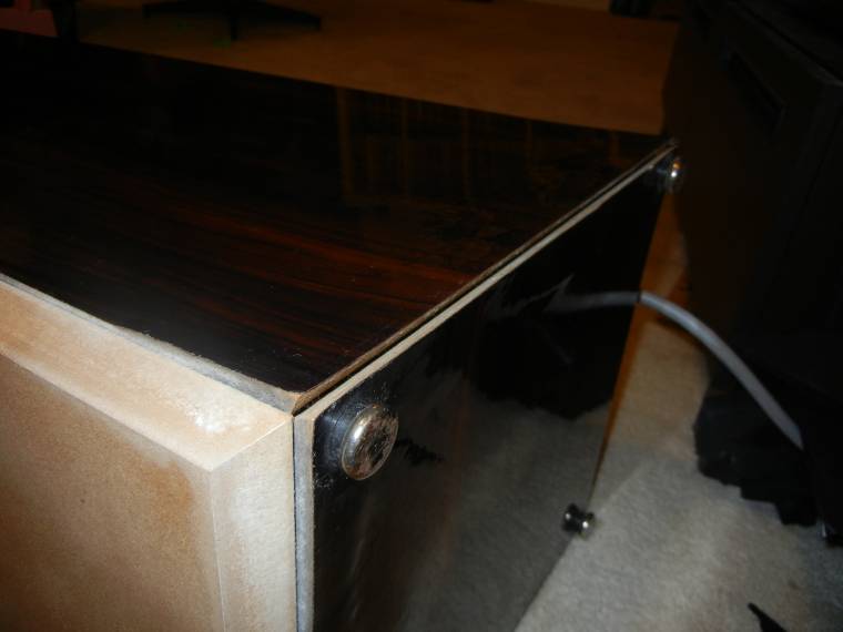

    Also, it seems these might have seen some moisture. One side of one of the speakers, the rosewood material is lifting ever so slightly. This is causing a 1mm or so gap between sides of the box. I can just barely fit the head of a flat screwdriver in. Meaning, its open, but not huge. I could run a bead of silicone in there, would that help? Any suggestions on this development? IS this a deal breaker in terms of sound quality?

    I had the same problem with a cs350. I peeled off the laminate, used sanding sealer on the ends of the mdf, lightly sanded everything, and painted the mdf with a textured black paint.
    I think it looks as good if not better than original.

    It looks like the side separation is still "sealed" but I'm going to reinforce the seals with carpenters adhesive or something strong.

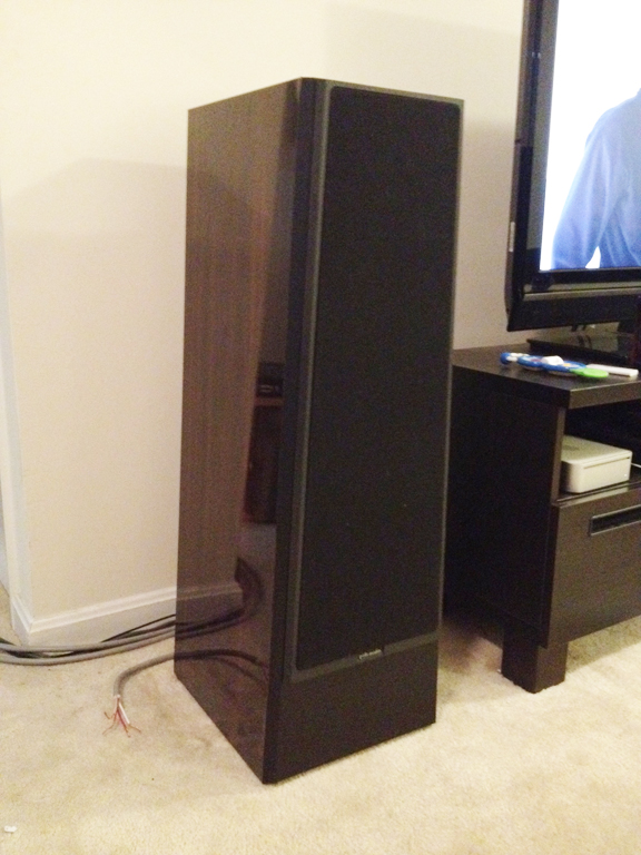

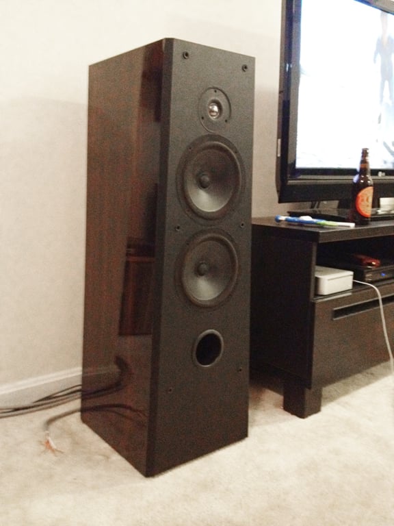

    I use the black laminate and it came out great... Not 100%, but 95% (working on getting out a few edges that won't stay down flat) and thats a huge upgrade from what I had. It was very easy and exactly what I was hoping for. Thanks for the help. I'm sure I'll be back soon!

    Right on! That black lam looks to be better than the original look.....and your done! Fixing edges on laminates is easy and looks like it'll be easy to detail out. I have the LS70 Blacks w/veneer. (I like the looks of yours better.) Vinyl is a VERY difficult fix. Have you attempted that yet? I use Elmer's thinned with drops of water based polyurethane and drops of water, ice cube it to shrink the vinyl and slight pressure clamp once tooled,pre-clamped and checked. Only thing to consider is gloss of poly,wiping your vinyl clean so it doesn't show a smear where excess was squeegeed out....using a dulled and taped razor blade edge. Care needs to be taken to not scratch or re-stretch the vinyl. If there is a lot of spots....use the complete re-vinyling method,faux grain with a couple thin tinted topcoats.....or just paint. (Just some suggested avenues.)
