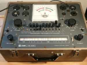

    I'm going to bump this as it is also time for me to finally get a tube tester. Do I need anything more than an emissions tester? Obviously the more information the better, but is emissions enough? There looks like a decent Knight 600A emissions tester near me, I'm just trying to figure out if I need more for my regular 6922, EL34, 6L6, and KT88 tubes.

    If you only want an emissions tester, the little Sencore "Mighty-Mite" family is hard to beat. I have my father's early 1960's TC_130 Mighty-Mite III; used it last night in fact. Simple and straightforward to calibrate - tests emissions, grid leakage (one of the better grid leakage testers around, at least in the routine service arena), and shorts. Yes it'll test all sections of a multi-section tube; it won't provide sockets for some of the old-fashioned vacuum tube types favored by some of us more esoteric hifi nutcases (e.g., 4-pin power tubes).
    http://tubesound.com/2008/08/12/repair-calibration-sencore-mighty-mite/
    If you really want to test tube performance or match tubes, though, you need to look for a "transconductance" tester. These are pricer, more complex, and somewhat more tedious to use.
    All testers are really only as good as their calibration. Especially if you go for a high-end tester (e.g., Hickok TV-7 or its kin) spend the $$ and get one that's been restored and calibrated.
