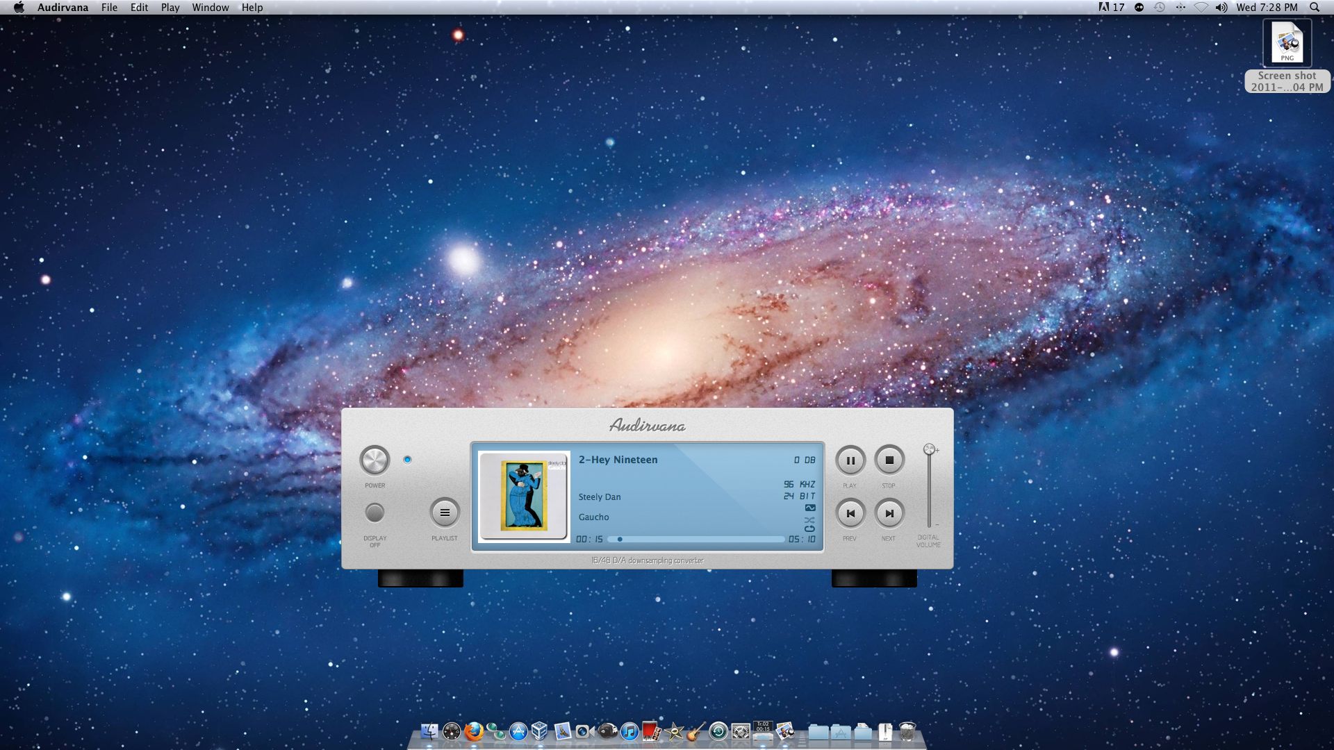

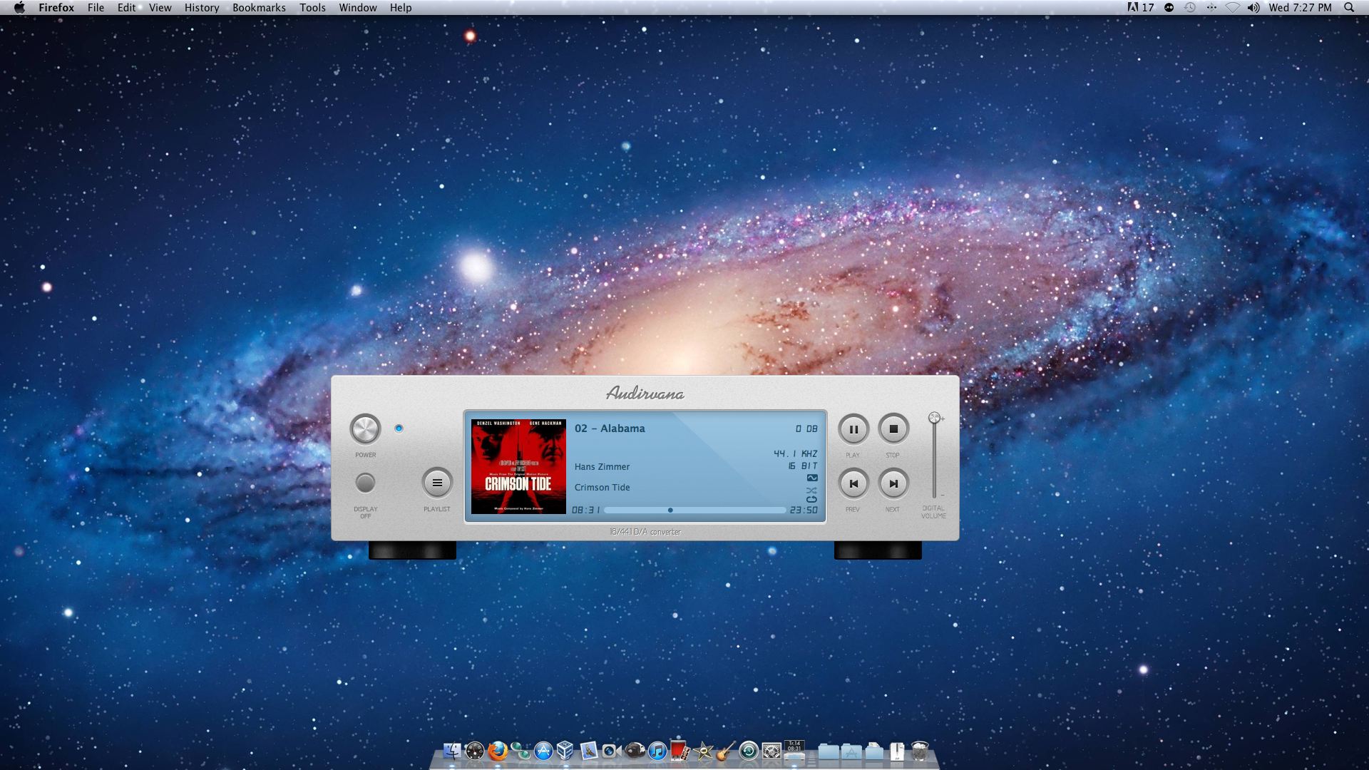

    I'm using Audio Nirvana on OSX, and I believe the info at the bottom is telling me what's actually happening.
    I was confused at first because I was expecting no sound when I played a 24/96 file, but there's definitely sound.
    I'm attaching two screenshots, one playing a redbook CD and one playing a hi rez file. On the audio player, you can see at the bottom of the application window where the hi rez file says something like 16/48 downsampling converter.
    I don't know if the downsampling is being done by the software or the DAC. So, I have no idea what's happening with my music...

    I can tell you for sure something is downsampling, because I know what the hi rez version sounds like and this isn't.
    I guess my question is what's downsampling, the DAC or the software? I assume it's the software, but don't know for sure. What's weird is that Songbird, another application entirely, had the same result.

  • unc2701
    unc2701 Posts: 3,587
    edited August 2011
    Good question. I'm not sure, but I would imagine that the DAC wouldn't have the ability to.
    I agree- it's the software. With the USB connection, the software basically sees a soundcard that can only handle 16/48 and kicks in the down-sampler.
