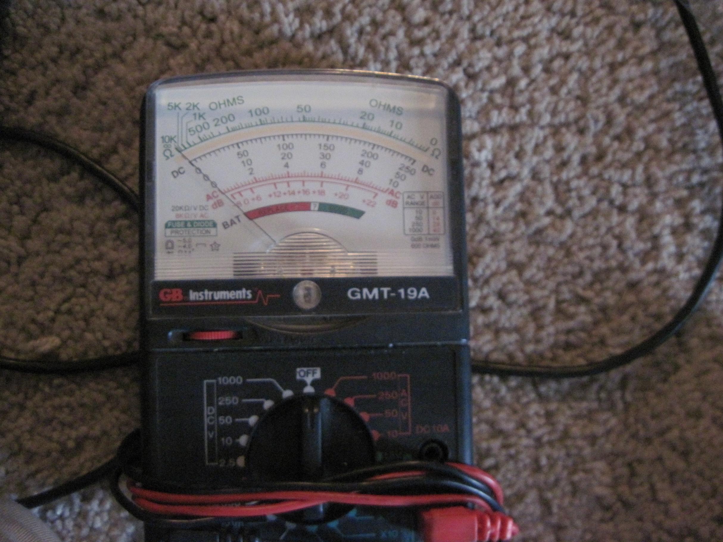

    :eek: The yaqin doesnt have an instuction manual and all I have is this sh*ty volt meter
  • michaeljhsda2
    michaeljhsda2 Posts: 2,200
    edited September 2010
    What's the ohm rating on your speakers?
