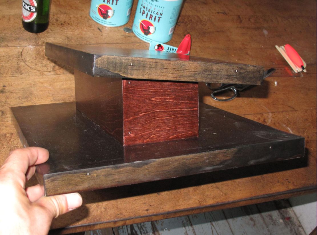

First off thanks to Doro and mhardy and others for providing the excellent measurements and photo's of the original stands.
I chose not to go for the described 11" versions as I have a 13 month old daughter and those things scared the crap out of me just looking at the picture.
Using 3/4" birch plywood I ripped both the sides and the tops at the same time as the 12 7/8" dimension is shared by both pieces. This saves on plywood since you can get enough for a set out of a single 4' rip.
[NOTE] This does make the grain of the top and bottom go in perpendicular directions if that matters to you.
I had an 8' x 30 something inch drop left over from an old job so I made two sets. (Keep an eye out in the clubhouse for some up-coming Karma)
I then made a 4" rip for the "riser" because I just wasn't sure yet about the angle of the incline. There were quite a few angles thrown out there early in this thread. So to make it clear for everyone else:
If you use the numbers provided in the pdf the angle of your bevel will be 6 degrees.
That said, when I went to cut the sides of the "riser" I cut them to the proper 4" length, dummied them up with the face and back and then marked the points of intersection. If you are familiar with miter saws then you likely already know that the gradations and indicators on these tools will lie to you and always at the worst times.
Once I was satisfied that all the pieces fit together I glued and brad nailed the "riser."
The tops and bottoms I decided to beef up a bit and added 1x ripped to 1" as a picture frame. This also allowed me to add rubber feet to the bottom and still have the stands appear to sit flat on the floor.
To make the stands look somewhat like the originals I stained the riser with Minwax red mahogany (a close match to the rosewood vinyl when applied to birch). The top and bottom got ebony stain. In the end I almost wish I had just painted the top and bottom black. I had never used ebony stain and I thought the extra wood grain would make it look cool. Perhaps with 8 more coats of the stain it would have come out better but, well......
Two coats of brushed on polyurethane (I HATE WORKING WITH THAT STUFF!!!) and 48 hours later I was ready to assemble. I glued and screwed the riser to the base but only glued and brad nailed the top down so you wouldn't see the heads (on those few occasions when you didn't have speakers on them that is
They seem very sturdy and...... well it's too soon to talk about sound improvement.
Anyway they look great and beat the heck out of the old Latin textbooks I was propping them up with to "time align"
I think the boxy vinyl clad Monitor 10's score at least 4.5 bonus WAF points while on these stands.
It's a shame the originals were made from particle board and have nearly all disintegrated. Thanks to the good people at Club Polk my Monitors are once again sittin' pretty in the classic style.
