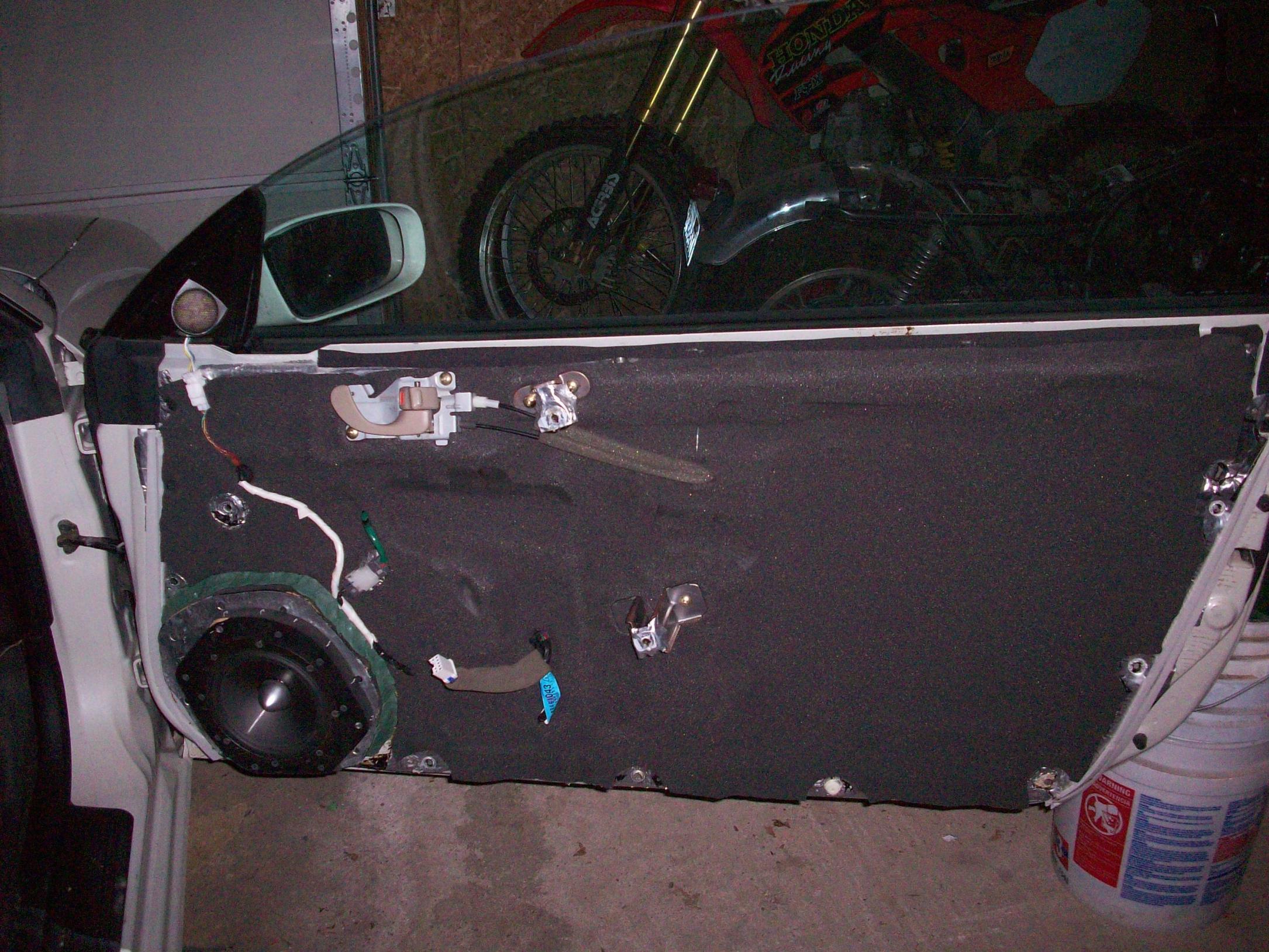

More on the 08 Burb... Sorry my "significant other" had plans for me for lunch so I didn't get a chance to finish (it's a good thing she's HOT!) ... here it is.
Pictures explained from 1st post above:
1st Row
Picture 1 = Driver's Door with FatMat 18" x 18" sheet inside behind speaker
Picture 2 = Full coverage over Driver's Door
Picture 3 = Closeup of SR 6500 in Driver's Door
Picture 4 = Closeup of 18" x 18" FatMat inside front Passenger's Door
Picture 5 = Custom Redneck engineering of Driver's side A Pillar tweeter mount. Had to cut out plastic stems which held the factory Bose tweeter and use the foam which comes with the SR 6500's, Gorilla glue and the SR 6500 Tweeter mounting ring. It was an incredibly tight fit with no more than 1mm to spare at most. Works beautifully and looks comepletely factory once installed.

I like the install man. The only thing I would suggest is replacing the SR mounting bracket with MDF and put non-harding clay between the MDF and the metal door where you mount it. This will had weight and be more rigid.
Are you trying to pawn off your women, were does the bidding start?
JK HU: 880PRS
Front: SR6500
Amp: Alpine MRV-F545
Sub: SR124-DVC
Amp: Alpine MRD-M1005 -
Forgive my ignorance but why would I use MDF over the metal the door itself provides and the FatMat? Follow my logic and tell me where I'm off a bit. If rigidity is the goal isn't metal with a layer of 3/16" deadner better than Medium density fiber board with clay? I'd sorta get fabricating a full MDF enclosure or even better a fiberglass enclosure but help me understand the basics of what I'd be getting for the effort. Is it a night and day improvement or just a few small percentages of improvement? Wouldn't I get MORE improvement going to say... An Alpine Head unit w/ Imprint tweaks and a better sub? Also I've been wondering if leaving the plastic molded door panel speaker dome in place (basically not cutting it out) is negatively affecting my image and whether cutting out the plastic and mounting these speakers forward so that they mount flush or are at least not covered by my factory door panel panels would "open" them up even more? I could easily figure out a way to take the aluminum grills provided w/ the SR6500's and attach them to the door to cover the hole I'd cut out.
There's a space between the face of the speaker and the door panel and it's gotta be messin' up my image a bit... By bouncing sound all over the inside of that door! Thoughts guys? -
If you pull on the plastic ring provided by Polk I'm guessing it will have some flex. It also doesn't weigh much.
If you made a ring out of MDF, I would suggest make it bigger than Polks, and pulled on it it won't move. The speaker will be solidly screwed to the MDF. The clay will add weight and create a seal between the metal and MDF. Just any clay won't work, it has to be non-hardening.
The biggest improvement I made was when I made the MDF ring and sealed all the holes in the doors. This separates the front wave from the back wave to prevent cancellation issues. Imaging and mid bass are what improved most and it was a night and day difference.
I was using the plastic Polk ring when I switched from my Pioneer 9800 to the Pioneer 880 and yes it made a difference. Plus it added a lot of flexibility tuning wise but it didn't make as much of a difference as the MDF and sealing the door holes.
I actually stacked MDF layers to bring it closer to the door card.HU: 880PRS
