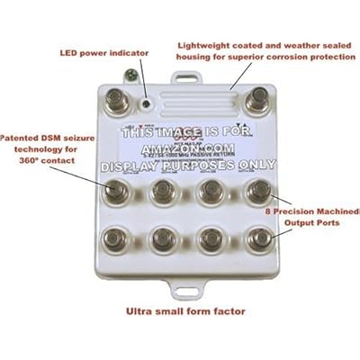

OK, I have 4 rooms right now that I have cable drops in for TV. Kitchen, 2 bedrooms and the living room. I have the 3rd bedroom as well as the basement rec. room to put drops in as well.
I can easily do this with a splitter and lots of 75 ohm coax. The problem is signal strength. HDTV signals usually have higher performance requirements. My issue is that right now, standard cable will have a signal drop if the line is split too much. Depending on the number of splits made, the splitter can push the presented range on the signal out of the acceptable performance range of coax. Add to that the requirements of HDTV for signal quality and the splitters can wreak havoc on your signal.
So, the answer is an amplified splitter. You can get one for about $50 from most places. They are quite simple consisting of signal amplifiers for each or a bank of coax outputs. Of course if you are using the signal from broadband, you put the splitter after the modem connection so it doesn't interfere with the data signal even though it shouldn't.
So what I want to know is there anyone here using an amplified splitter for their cable TV signal and if so, are you using it with an HD signal? If you are using it with an HD signal, do you notice any performance problems?

    If you dont have a weak signal then you will not need an amplifier, even for HDTV. As long as its a digital splitter, your good to go. I use a SVI digital splitter, I have absolutley no problems whatsoever even with HDTV channels and I have 5 televisions, 2 being HD capable.

    I use an Ideal brand splitter with 3db loss per output for 3 HDTV/ 1 Internet....no issues. You can buy it at Home Depot.
    I have RG6 all the way to the splitter inside and depending on the run RG6/RG59(Signal/Belden) to the rest.

    Yeah but I'm looking at potentially 6 or more feeds with HD programming capabilities on all of them. Think it'll be a huge issue?

    No, I don't forsee a problem.
    Can you RG6 the rest of the feeds? The less loss the better in all things AV. IN regards to standards and such, I'd over engineer it if at all possible and run some CAT6 alongside.

    I had signal strength issues at my old place (some of the runs were rg-59) & got an amplified bi-directional splitter... no issues after that. Probably don't need it now- strong signal, less gear (due to distributed av system), and RG-6 everywhere... but since I've got it, I'm still using it. Will post the model when I get home.

    Channel Plus DA-8200BID: does IR distro, too.

    Are you trying to split/amplify over the air HDTV signal or feed from cable company?
    If its OTA, I'd recommend getting a good signal preamp to mount up with the antenna. It will have much lower S/N ratio than the one you linked. I use a Channel Master Titan 7777 preamp that is mast mounted, then that feeds a 6-way splitter that goes to every room in the house. It works flawlessly in every room and gives me nearly 100% signal strength on all my tuners.
    If you are trying to split Comcast (or similar), they will almost always provide you with the necessary signal strength to overcome any splitter loss you have in the house. If needed, they will add a signal amp, which is usually of much higher quality than the one you linked above (I'm talking the types that cost a few hundred). Back when I had Comcast, they installed one for me no questions asked.
